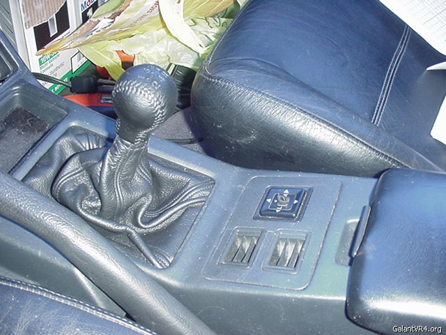

before:
after:
Damn thats better. Now I have to get my VR6Eater leather shift boot in there /ubbthreads/images/graemlins/smile.gif and put the whole console back together /ubbthreads/images/graemlins/frown.gif
:update: Got the VR6eater shift boot in there now. I ordered it for a stock shifter height but had to make it work with the DSM shifter.

I believe the 90 is different and wont work. Don't quote me on that though.
I didn't modify it to shorten the throw, its just a normal stock DSM shifter.
I didn't have to mess with any "cable heim joints"... at least I don't think I did.

Its just the shifter arm.... one bolt through the center, and a cotter pin holding it on at the bottom. You do have to loosen the whole console in order to be able to slide the arm on/off.

I'll have to take a look at that, but to answer your question then, I didn't mess with that, all I replaced was the actual shifter. Its much better already.
