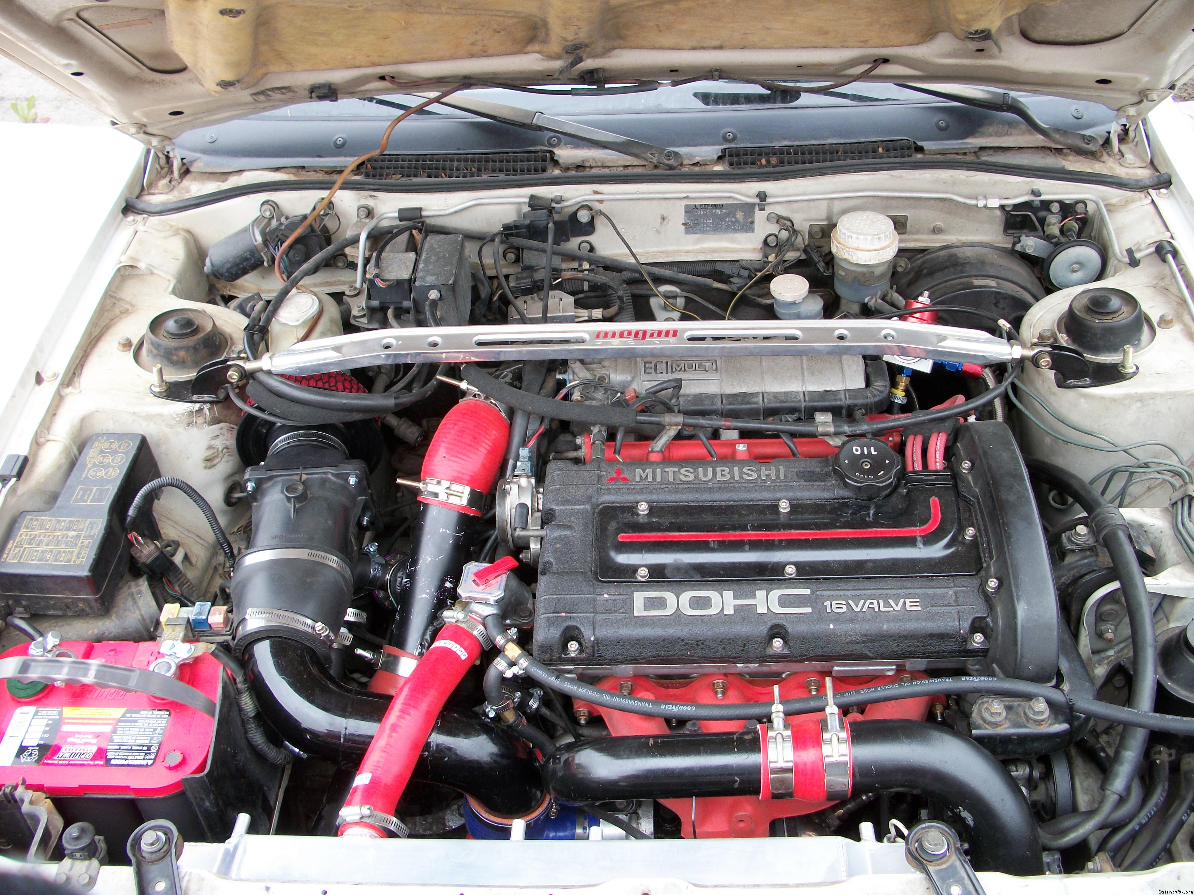

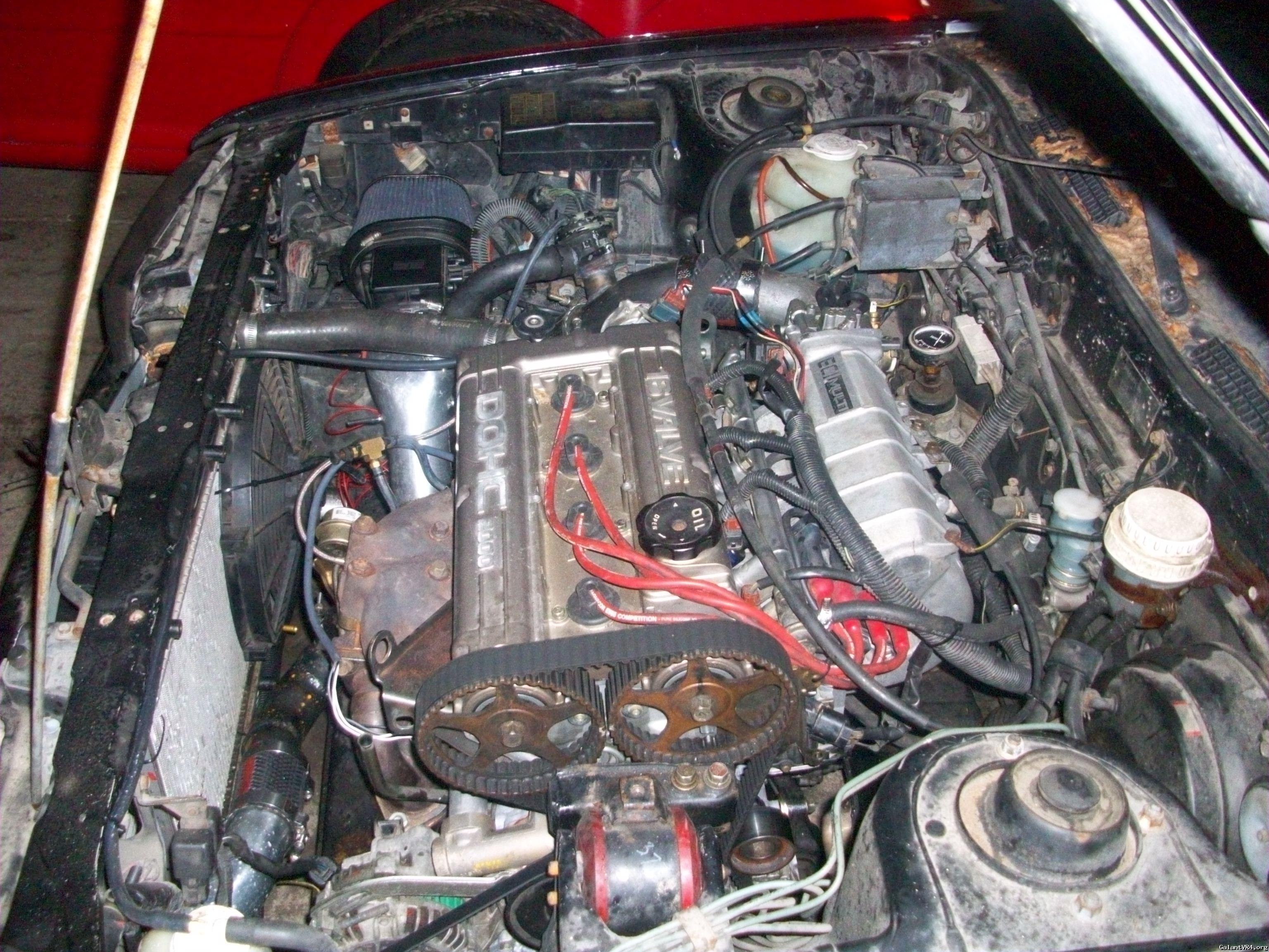

i have a 1g radiator in my car. i dont have ac so i just pushed it up under the front upper cross member. it fits good and tight plus it makes more room in front of the engine.
this is perfect for a big turbo setup you should post up a thread, but i am only using a evo III 16g and really want the nice aluminum radiator showing. thanks for the pic though

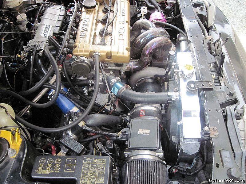

dude I have a 1g mishimoto unit in my vr4, works greeat with a/c and a gt30 setup search my user name or 96/1000

havent had any over heat issues at all. but a 14" fal pulling(in the photo) and a 12" fal pushing on the front are perfect overkill.
