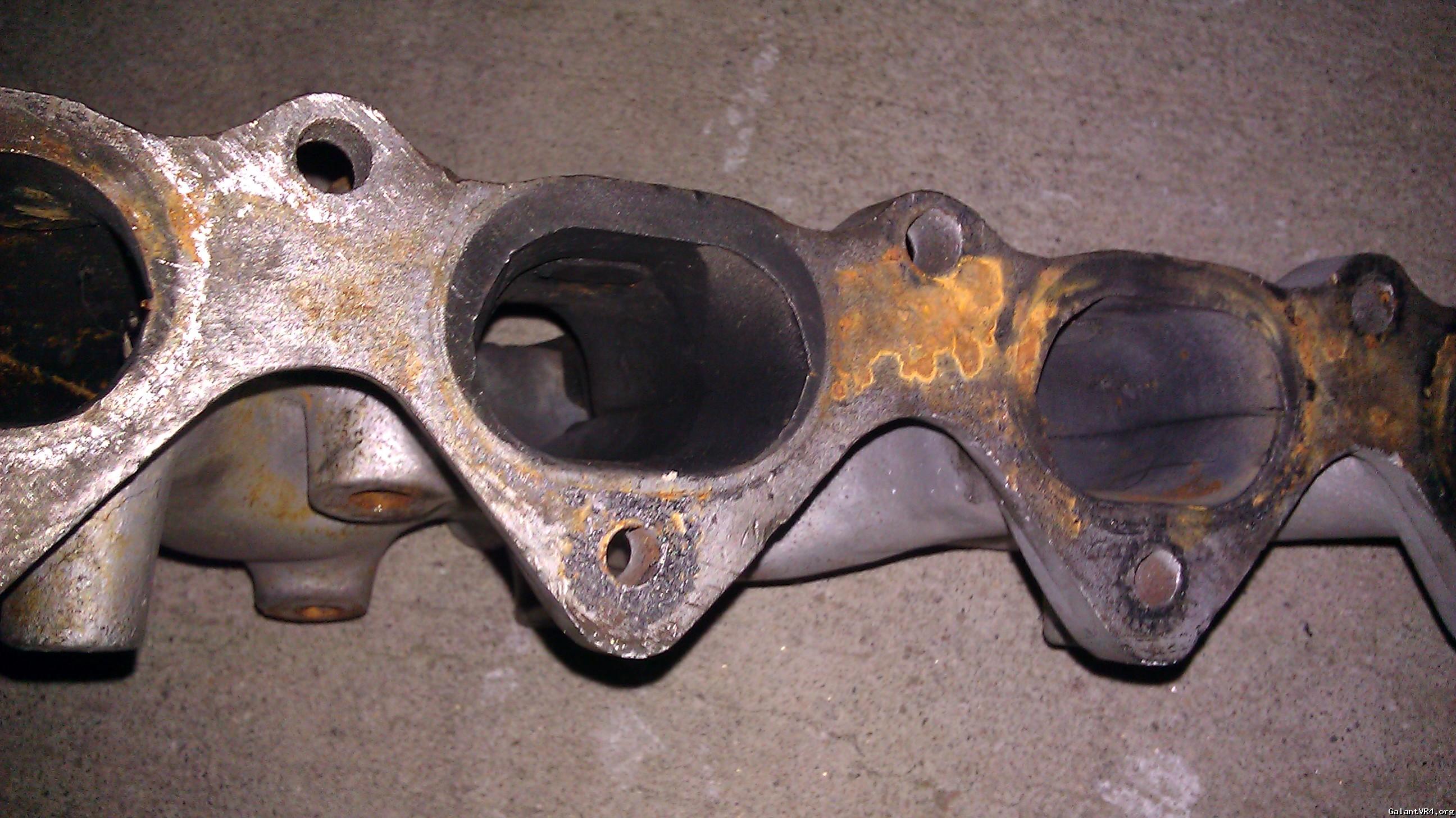

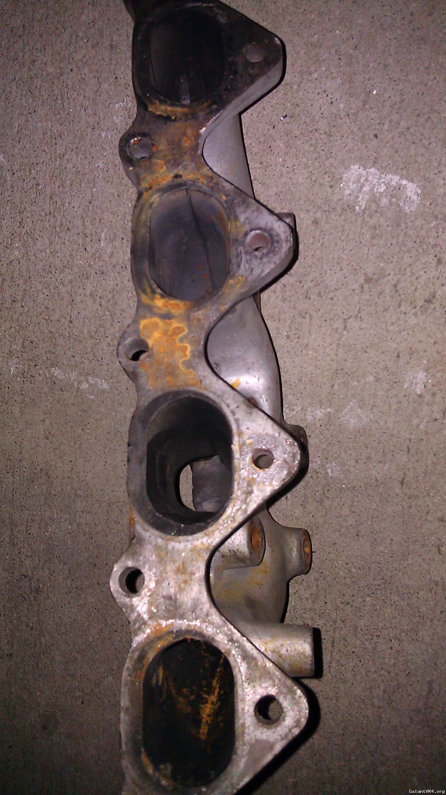

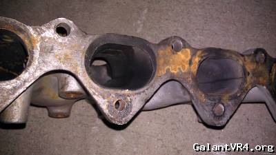

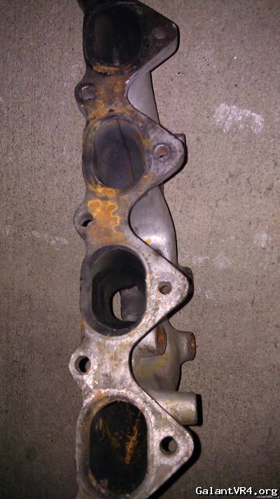

How big is the opening for the turbo. There are 3 different sizes 1g auto(smallest) 1g 5 speed little bigger and the 2g. I'll go out and measure all three when I get off work if you havent figured it out yet.

89ColtGT has a 2g manifold for sale cheap right now, he's a great guy to deal with as well. The outer holes on a 2g mani will be larger plus they have a raised rectangle section on the right side looking at it from the front. He has pics in his thread, you can compare them and see the difference.

Alright im most likly wont use this Mainfold the one that was on the car was cracked perty bad....Ok so if i get a 2G Mainfold and get it Ported will it work good with a Big 16 Turbo??
2g or EvoIII will work fine there is usually a few on sale in the marketplace.....

GVR4 in japan had a 7cm ex manifold with there big16G fyi tad smaller than evo3 but thicker than USDM 1G.
2G has a rised flat area where the left corner of the heat shield bolts to, unlike the stub on the 1G
Most importantly is the divider, which the chinese never get right /ubbthreads/images/graemlins/uhh.gif and casting materials, molding etc...

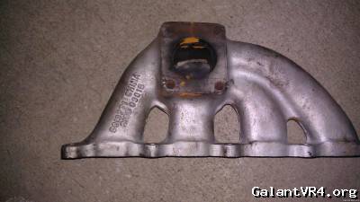

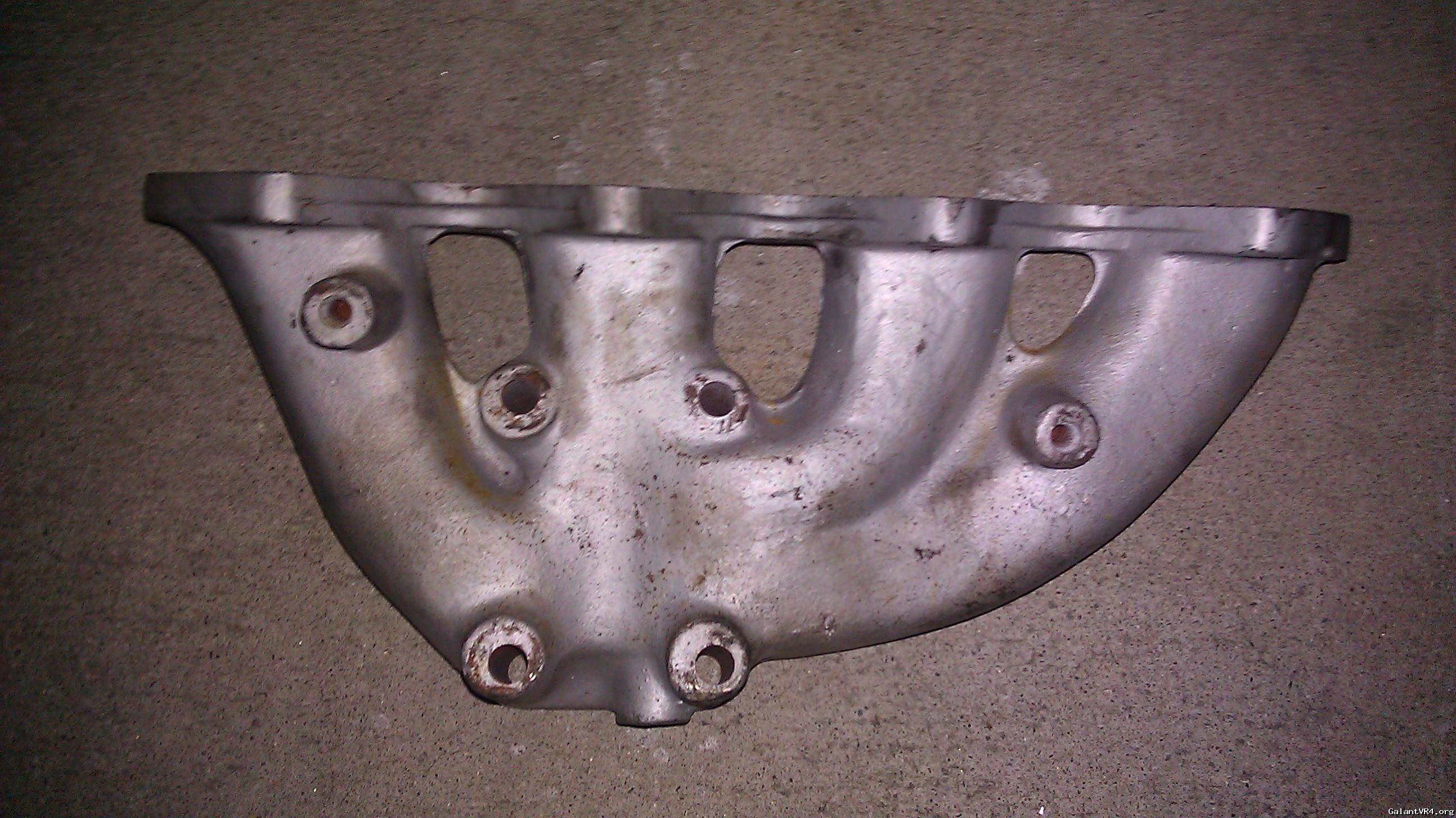

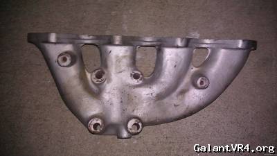

That looks like a copy or reproduction of a 1g turbo manifold. I'm not sure how much the 1g/2g/evo/whatever manifold is important as far as an upgrade goes. The thing to pay attention to is size out of the head into the manifold, and out of the manifold into the turbine housing. More often than not, I have to port the sh*t out of the turbine housing to have it equal/bigger than the manifold. Keep in mind the way the exhaust flows. You want it smooth without steps or 'walls' to screw up the flow. My current setup has an Evo III GT manifold, which I assume is a hogged out Evo III manifold recasted. It's HUGE compared to my stock 1g manifold. Has the stock 4-bolt turbine housing bolt pattern, but the exit is near 8cm. I had to port the sh*t out of my BEP turbine housing [brick] -and- RRE 7cm gasket just to make the exhaust gasses flow correctly. I can't imagine that manifold bolted to a stock 6cm or even 7cm turbine housing inlet would do anything but do harm unless some serious porting was done.
beaner
Jun 22, 2005
1,562
b'ham, mi
The manifold is named Evo III GT, I think. Like I was guessing, someone hogged out an Evo III manifold, tapped it for EGT, then had it recasted exactly like that. It is not OEM.
Imagine it next to a 1g manifold. Due to it's size, I think it would be a downgrade unless installed correctly. Bigger != better.
