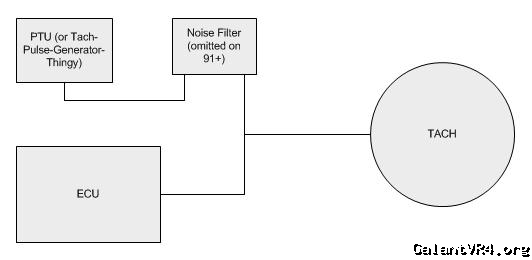

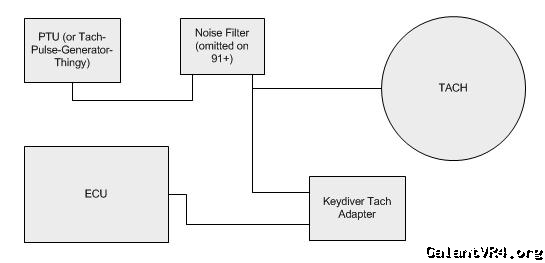

See.. I saw your tach adapter.. but it wasn't quite clear that it would work for my situation....
I understand that that your adapter converts the pulses generated by the 1990 tach-pulse-generator (on the coilpack) to a signal that the 1991 ECU can understand. It doesn't touch the signal from the tach-pulse-generator to the tach itself.
Am I misunderstanding?
I will have a 91+ PTU, a 91+ ECU, a 91+ coilpack, and a 90 tach. So the 91+ ecu will understand the 91+ PTU tach pulses just fine..but the 90 tach won't know what to make of the 91+ PTU tach pulses..
Maybe I misunderstand how the tach, ECU, and PTU are wired.
I'll see if I can get a visio drawing up here in a sec
Stock:
With Tach Adapter:
Yes, but since you have now changed everything but the dash tach, you might as well finish it off. My adapter is for guys still running the 1990 dash tach, coil pack, transistor, and tach driver module with a 1991+ ECU. It won't help you now.
