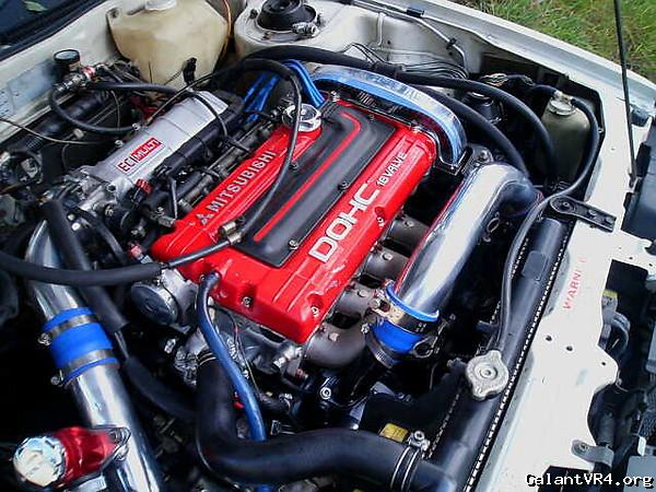

Hi guys, an update on my VR4. Its a 1990 HH E39.
Engine 4G63 6 bolt
Wiseco 8.3-1 pistons (20thou over)
Scat rods
MMC BLS removal kit
ACL Race bearings
ARP main studs
Reground crank
Tunnel bored block
Ported head
1mm oversized valves
BC 272/272 cams
Unorthodox cam gears
ARP headstuds
Nippon MLS headgasket
Gates Racing timing belt
2g oil filer housing
J-spec oil coiler
Fuel- 660 cc injectors
SARD AFPR
Walbro 255 pump rewired
Intake-2g AFM
Bomz intake
Apexi pod filter
2.5 Meek Automotive IC piping kit
600x300x75 IC
Meek Automotive TB elbow
GFB Stealth BOV
Exhaust-FP Race turbo mani
FP TD05 18g6sl2
2.5" dump pipe
3" exhaust
3" high flow cat
3" Lukey Muffler
Electronics- Blitz EBC
DSMLink V2
Innovate LC1 & XD16
Trans- Standard driveline
Direct Clutches HD organic preasure plate
Exedy clutch plate
Brakes- Standard disc
EBC Greenstuff front pads
Goodridge SS lines
Suspension- KYB AGX front DSM struts
Koni yellow rear
Dobinson superlow springs
Whiteline front & rear sway bars
Whiteline strut brace
Exterior- 18" advanti wheels
225/35/18 Nankang tyres
E38 RS bonnet (painted black)
Standard paint
Audio- Pionner AVHP6850DVD source unit
Audison LRX2.250 front amp (2 x 120rms)
Audison LRX1.400 mono block (1 X 400rms @ 4ohm/1 x 600rms @ 2ohm/ 1 x 900rms @ 1ohm)
Audison SRX2.1 rear amp (2 x 80rms)
Canton RS6.2 front 3 way splits
Hertz HSK10 splits
2 x Earthquake DBX10r woofers
Optima yellow top battery ( in boot )
AeroPro 1.5 Farad Cap
Hope I haven't missed anything.Some pics..

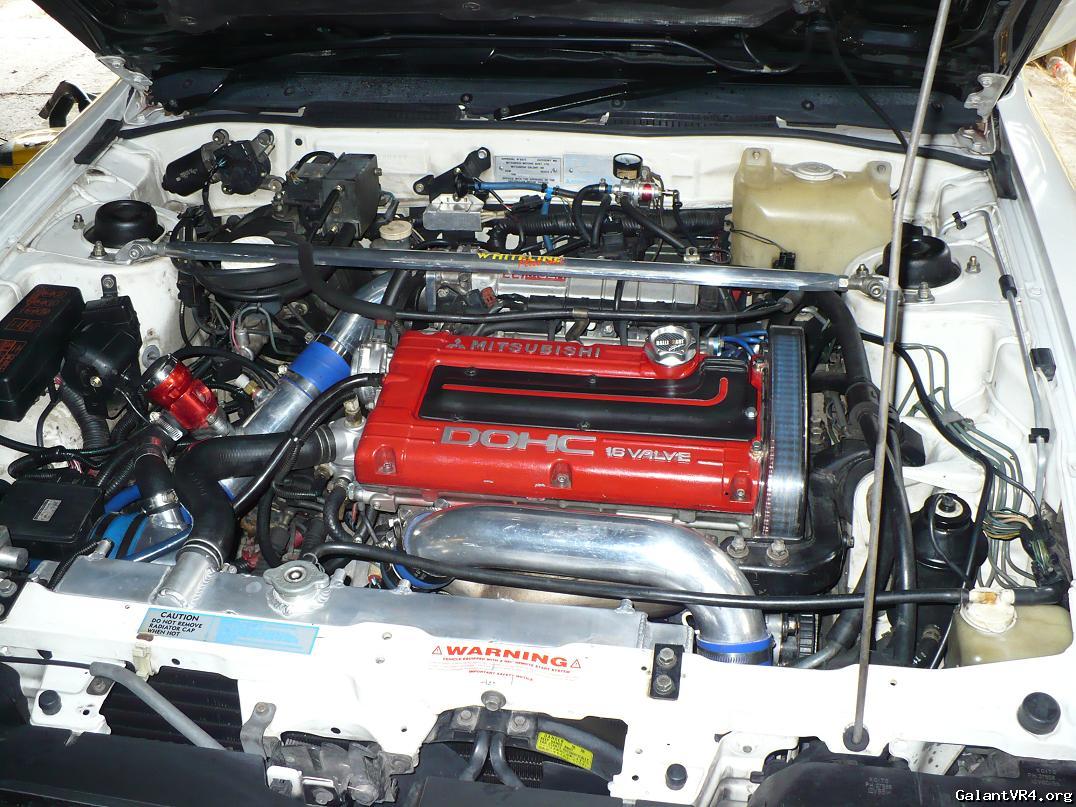

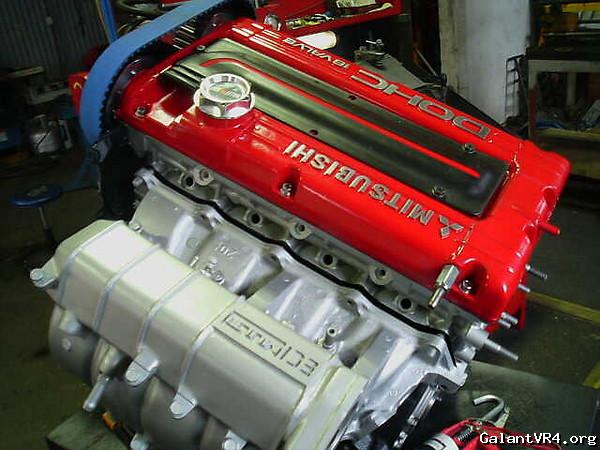

Another update, car is off the road at the moment as I am getting the box rebuilt & cleaning up a few things.
Upgrades- FP3052
FP 4" intake & filter
Tial MVR wastegate
Full SD set up
New cooler 550x240x75 with intercooler spay ( mirco switch on TB
