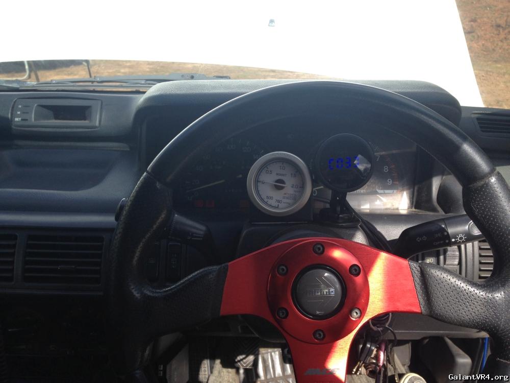

Another small update.
Old pic of gauges. They are more lined up now. Apexi boost and Grams wideband.
Also Installed brass shifter bushings and a Walbro 255lph.
