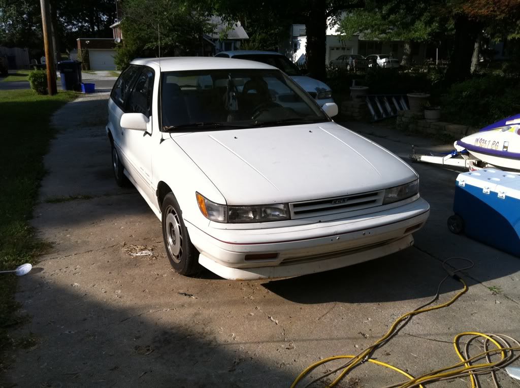

1901/2000 has a new home and is getting a makeover!
GSNT
Jul 6, 2003
521
Louisville, KY
It is also sporting a new Kenwood DDX418 and Pioneer TS A1702C 6 3/4" component speakers. I have an older RF Punch 300S amp that I'm going to power them with for much better sound. Someone did the ultimate hack job install on a set of 6x9s in the rear deck. They peeled the metal back with friggin tin snips or something, its totally Effed. Since it is so tore up, I think I'm just going to throw some free-air 8" subs in the deck to have some decent lows and not sacrifice truck space.

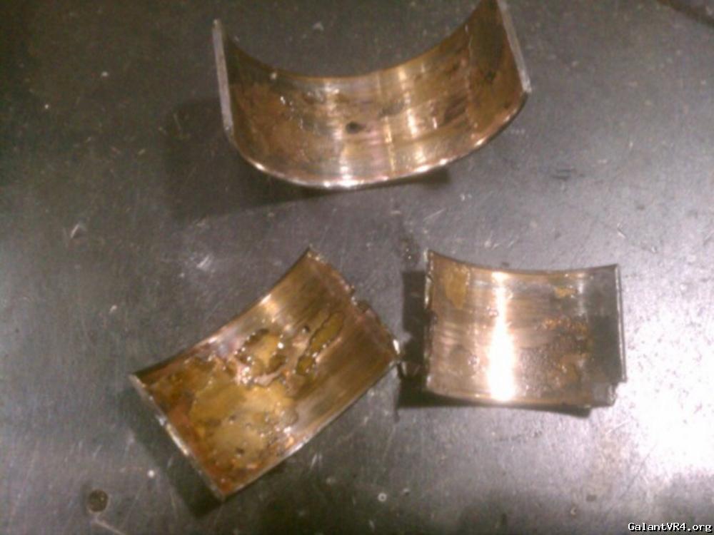

Newest mod!
Luckily, it JUST had started to spin. The stamping on the back of the bearing is still there. The bal shafts are already eliminated, crank/rod has no grooves, other bearings were perfect, so I cleaned the hell out of everything, threw a new set in and so far so good. The phantom knock went away as well!

Quoting GSNT:
Newest mod!
What kind of bearings did you go with? Just asking cuz I need new ones and am trying to get opinions.
GSNT
Jul 6, 2003
521
Louisville, KY
Clevite, good enough for NASCAR!!!!!!!! That's what we stock at work. /ubbthreads/images/graemlins/smile.gif
