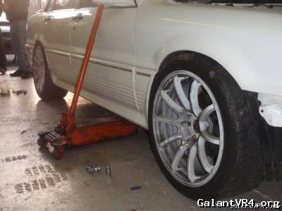

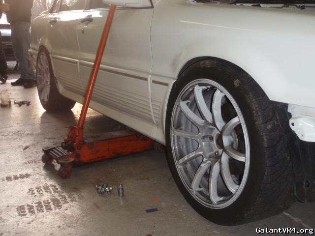

Yeah, these were 245-40-18's. I think if I stick with the 18's instead of 17's, I'll run 225-40 or even 225-35 (stock 195-60-15 height). It's on K-Sport Coilovers, with about 2* of camber front and rear. I'll be pulling the fenders a bit, but it'll be tasteful.

Yeah I'll be switching to 225/35/18's as soon as I've got some coin.
I had to hammer the hell out of the piece of metal under the dogleg's, and cut a piece out under the top corner of the rear bumper where it meets the arch to clear 235/40/18's, I'd like to go a wee bit lower but at the moment I'm limited by clearance between the ruca and the chassis and the steering tie rod and the subframe.

All I can say is god damn that looks wicked, so looks like 9"wide +30 wheel is the hot ticket exactly the kind of look I imagined, those wheels are sexy.
Leave the 245-40's you dont want that stretched tire look with 225's minimum I would do are 235's but please leave the 245's if they dont rub they look
real nice and why run a 9" wide wheel if you are going to run relatively speaking skinny tires. What brand wheels are those and are they 4/5 lug
looks like a 4 lug wheel but I am not sure.

The wheels are Rota G-Force. You can get them in a ton of sizes and offsets. These are 5 lug. I might consider a 35mm offset, with a 5mm spacer in the rear (like I had with my MR BBS wheels to even the track width out). They are a bit heavy for their size, but cheap, and for the most part, have been a good quality wheel. If I do stay with a 245, it's definitely going to be a 35 series. It's about an inch higher off the ground with these tires.
Wth why did they have to be rota's.. I would stick with the +30 offset
it just gives the car that muscular look without looking stupid that I like.
This picture shows it off, just look at that rear fender especially, nice full
and flush(not hellaflush lol) I like..Can you take a side shot of the car with
the camera perpendicular to the car I would like a nice sideway shot straight on
and one from the back showing both rear wheels....

They don't have to be Rota's. They are copies of Advan RS wheels. 17x9 29 offset are on sale right now for $513 each. 18x9 29 offset are $618 each. It's up to you.
I can try to get a shot, I'll have to see if my buddy is around to pull 2 off again. I have the choice to buy these wheels, or a TIG welder, so I think I'll get the welder and get wheels in a couple months.
