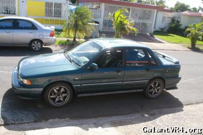

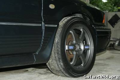

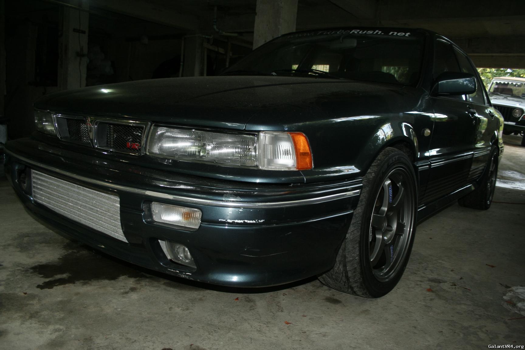

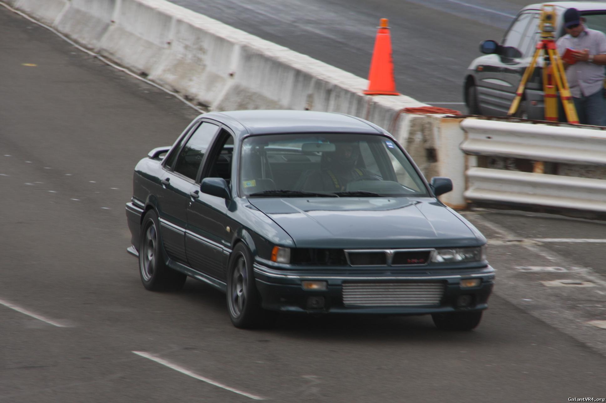

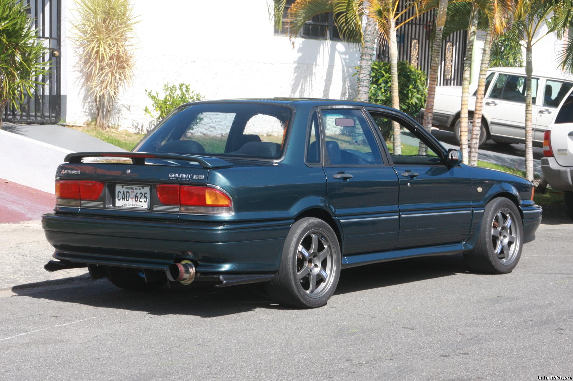

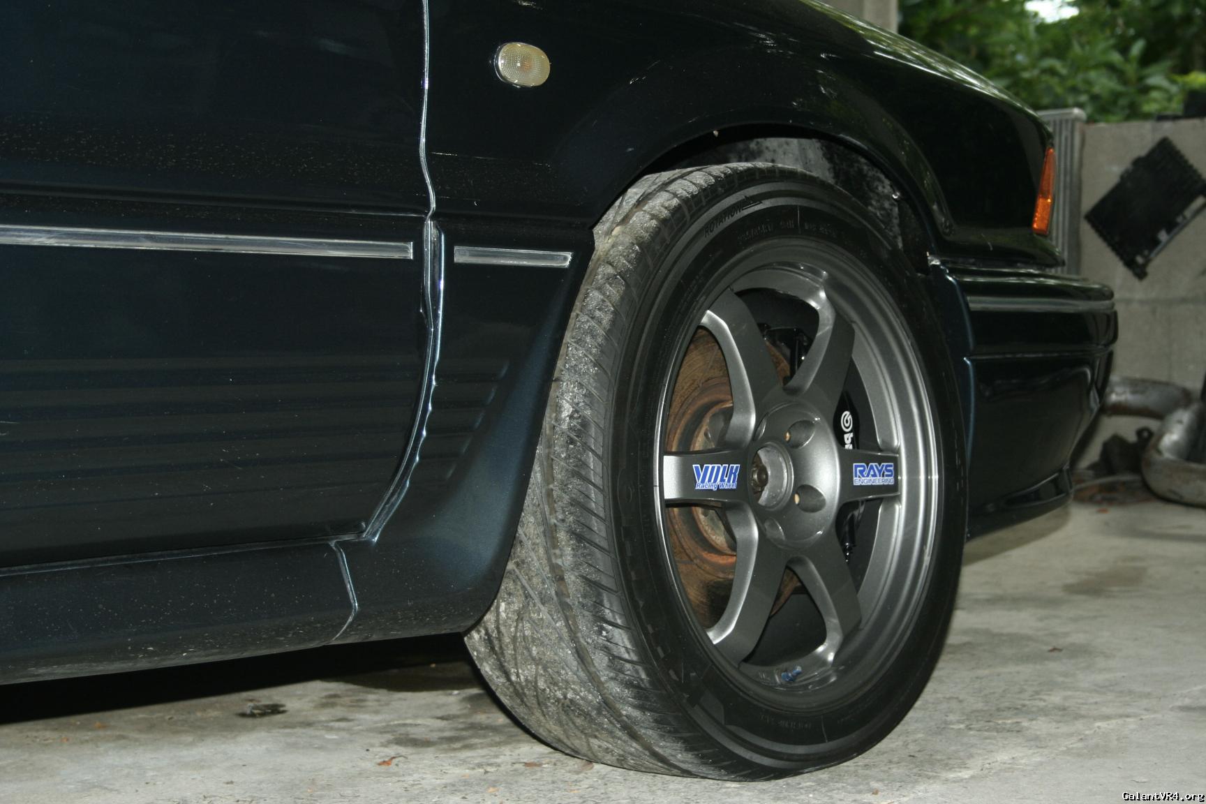

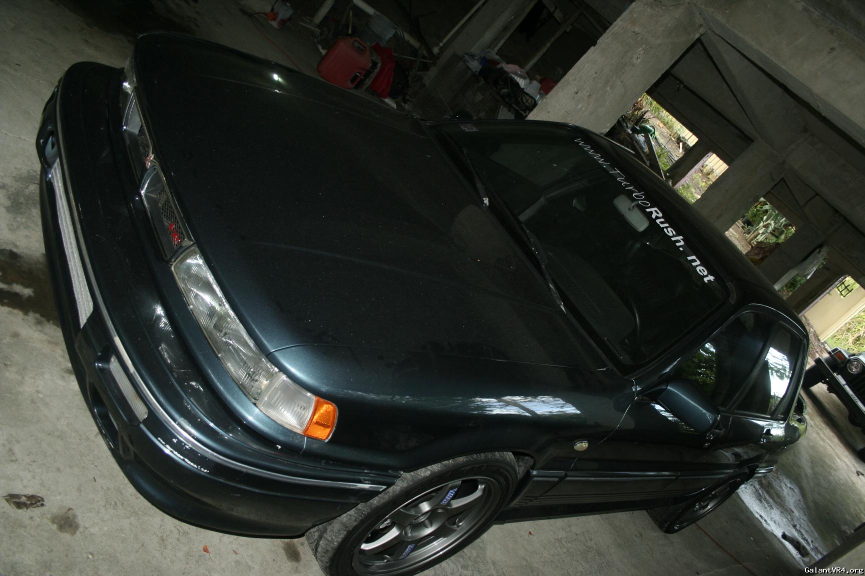

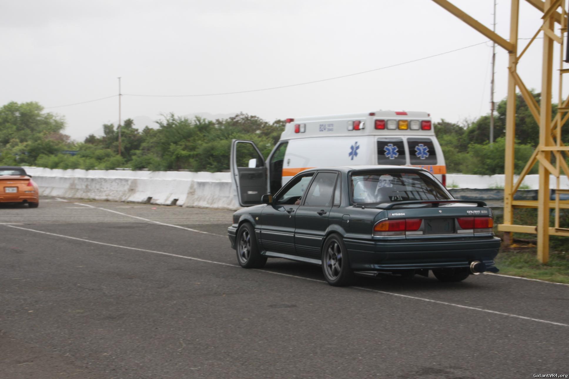

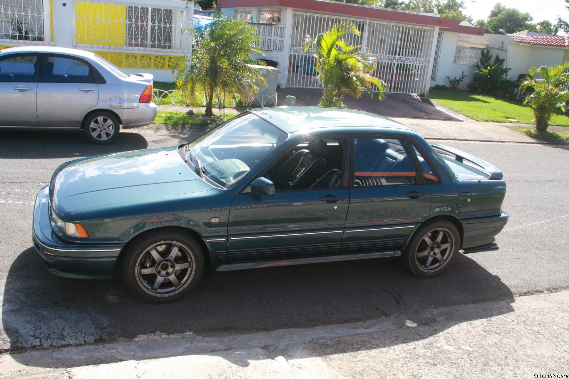

My old set up
VOLK TE37 17 X 9 +32 offset
235/45/17 kuhmo tires (street)
255/40/17 toyo ra1 (track)
H05TYL
Jun 9, 2007
752
Wgtn, NZ
Quoting SouthCaliVR4:
No specific info but... A nine is going to poke, there is just not going to be enough room under there to tuck that width. And the tire size for a 245 should be a 40 series to stay at all close to original diameter.
9" width +30ish will fit under the guards with a slight pull and a sensible amount of camber.

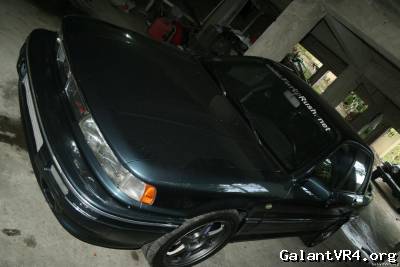

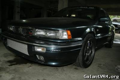

/ubbthreads/images/graemlins/dunno.gif hellaflush or not... H05TYL's car from NZ looks sick with 18x9's and 235 tires... I'm going with the same or 17's of the same width/offset.

FCR those TE37's look amazing! Great to know I can go 17x9 some time in the future /ubbthreads/images/graemlins/worthy.gif
EMX5636
Jun 28, 2008
1,631
Bucks County, PA
Had a buddy stop over and bolted his 18x9" 30offset wheels to #108... The tires were 245-40's. I'm gonna roll the fenders a bit tonight, but clears the rear trailing arm and everything fine.
