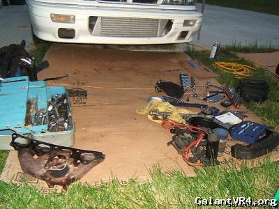

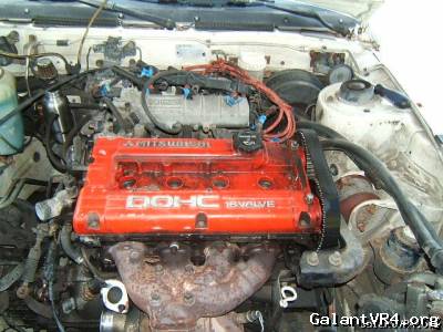

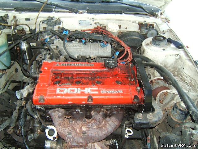

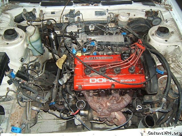

I sorta forgot to take pictures on a device I could upload from prior to parts coming out, but so far, after a day of reading and an hour or two of curious poking, prodding, and unbolting this is where it's at tonight:
All photos taken with a 100% genuine Grade B kosher Potato.

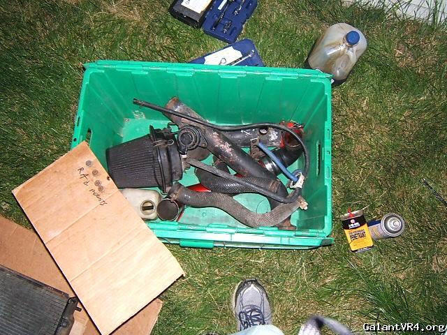

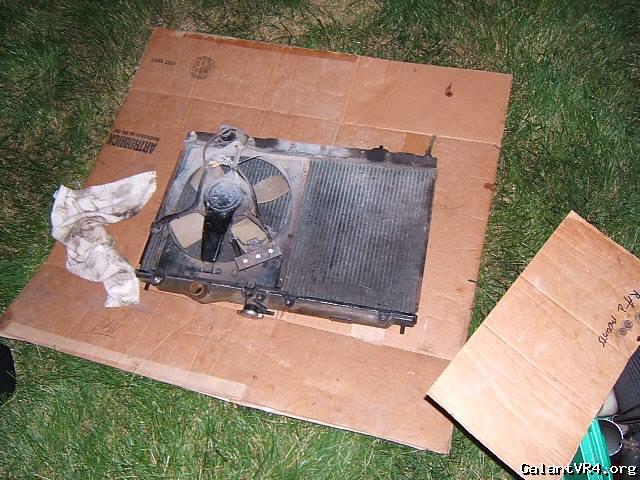

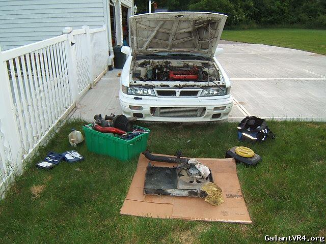

Today... well... I forgot about the giant white ball of doom that looms over us all when its least convenient... 91 deg. Weather... FANTASTIC! Relatively speaking though, it all went well enough. Didn't get too much done because I'm still pretty green on the whole car scene. But references to Vfaq, common sense, and gvr4.org have helped out in those particularly questionable situations.

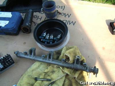

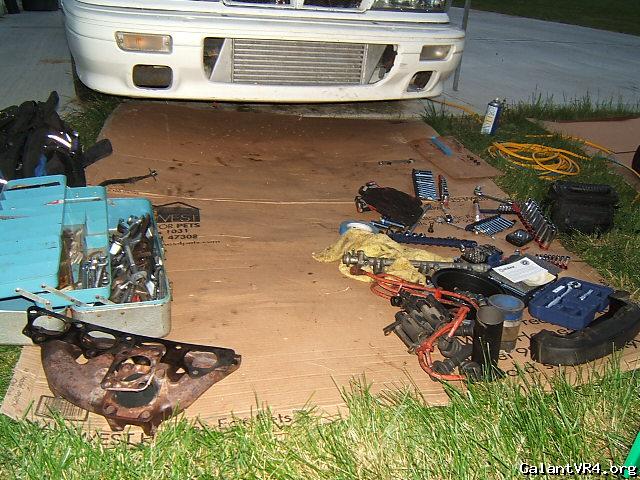

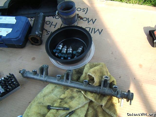

First went injectors and fuel rail:
After which the coil pack got a little TLC... and by TLC I mean confused staring as I tried to figure out what was still holding it on... (I hadn't noticed the bolt that's housed back behind the CP and in the curve of the Intake manifold.)
The rest just came out in gradual moves.

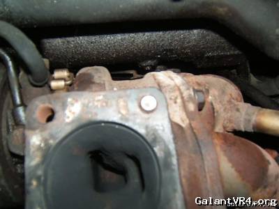

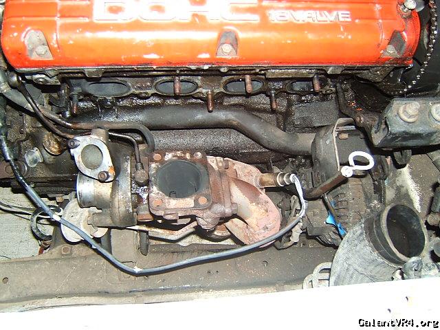

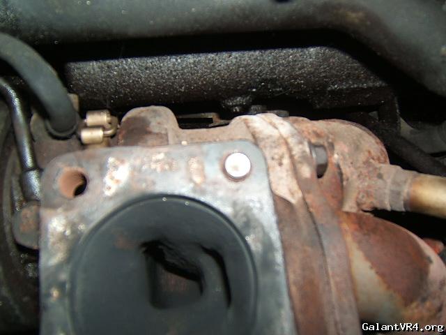

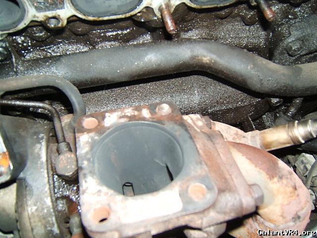

Of course off came the exhaust... but at a bit of a price. Sure all the bolts holding it to the head came off like they were brand new from the factory... but the bolts holding it to the turbo... those were a new story.
1/4 was a pain, and I'm pretty sure I almost ruptured a blood vessel when cranking at it, but it came off.
2/4 took some persuasion but it too eventually came off.
They say the 3rd times the charm, right? Well 3/4 said "Well to heck with that." and decided to just snap off. I hadn't even put all that much force into it either, it started acting like it was moving, then it wasn't , then POP goes the rust-coated weasel. /ubbthreads/images/graemlins/banghead.gif Too bad it didn't take notes from its brothers, as 4/4 just came off like a dream.
But here's the carnage after the fact:
After this all the turbo lines got taken off and the V-band loosened from the exhaust... but it refuses to let go. (It seems to be in a pretty serious relationship with the exhaust, I'm almost going to feel bad about wrecking that.) So come tomorrow and some light I'll be getting further in on that V-band and lift the turbo out.

Liquid wrench is some high dollar stuff right there. I've got a can of WD40, and tin of penetrating oil that's about as old as I am. So far the only trouble bolt has been just the one holding the turbo to the manifold... the rest is coming off fairly easily. Though I have come up with some rather colorful phrases while trying to get a wrench on/remove the bolts on the bottom of the intake manifold... while its still in the car. (Mistakes were made, this was probably a bad decision, but now I'm determined to get this thing out...)

It's too late now but for future reference, the intake manifold comes off really easily after the head is off. Fire helps with the last exhaust turbo bolt also.

Yeah, heat will be a huge assistance in the further stages of disassembly. One of them being removal of the god-sized axle bolts. I think the intake manifold has won the battle and I'm just going to finger-tighten the bolts that I have loosened... then the manifold is going for a ride with the rest of the engine as it gets lifted. Once I have good leverage on those little bastards... the trouble bolts will be loosened.... WITH EXTREME PREJUDICE.

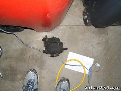

As for the alternator, well, it's pretty seriously fouled and needs some specific attention to clean up (Terminals are oil soaked and covered in what can only be presumed as sublimated belt bits form years of service). Cleaning and buffing an old alternator is always cheaper than burning it out 10 miles down the road and having to pull the whole dang thing again. Plus... ehehe, before you had even replied... I may have already taken the sucker out. /ubbthreads/images/graemlins/dunno.gif

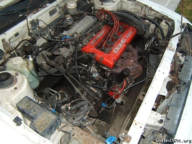

As promised: Today's photos. Not much to see.

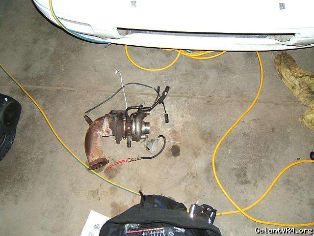

The turbo:
It's just a standard 16g, so I figure you guys are pretty familiar with those by now. No need for a multi-angle shot.

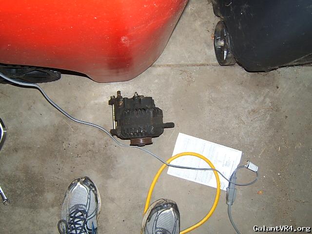

Here we have my fashionable footwear choice, oh, and the alternator.

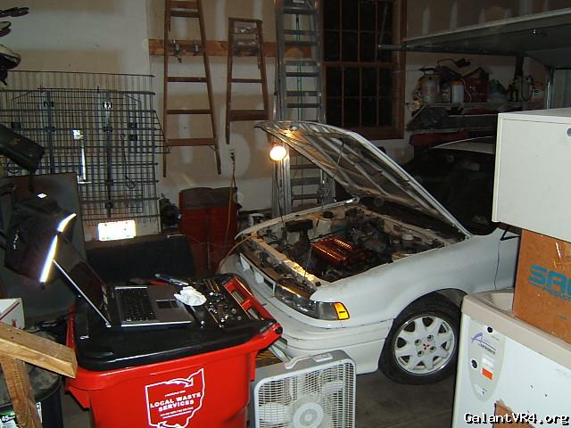

And lastly, out of pitty from the family I got an upgrade from driveway to garage, so now I've got a fancy workspace in here that'll let me take full advantage of my nocturnal nature and work until 5 A.M.
As always, thanks for the help and advice along the way. I hope to have this car back on the streets and driving by midway/late next week. I'll keep spamming up posts until it is... then I'll probably get really really quiet... as I'll be obsessing over getting this thing cleaned up and sparkly.
