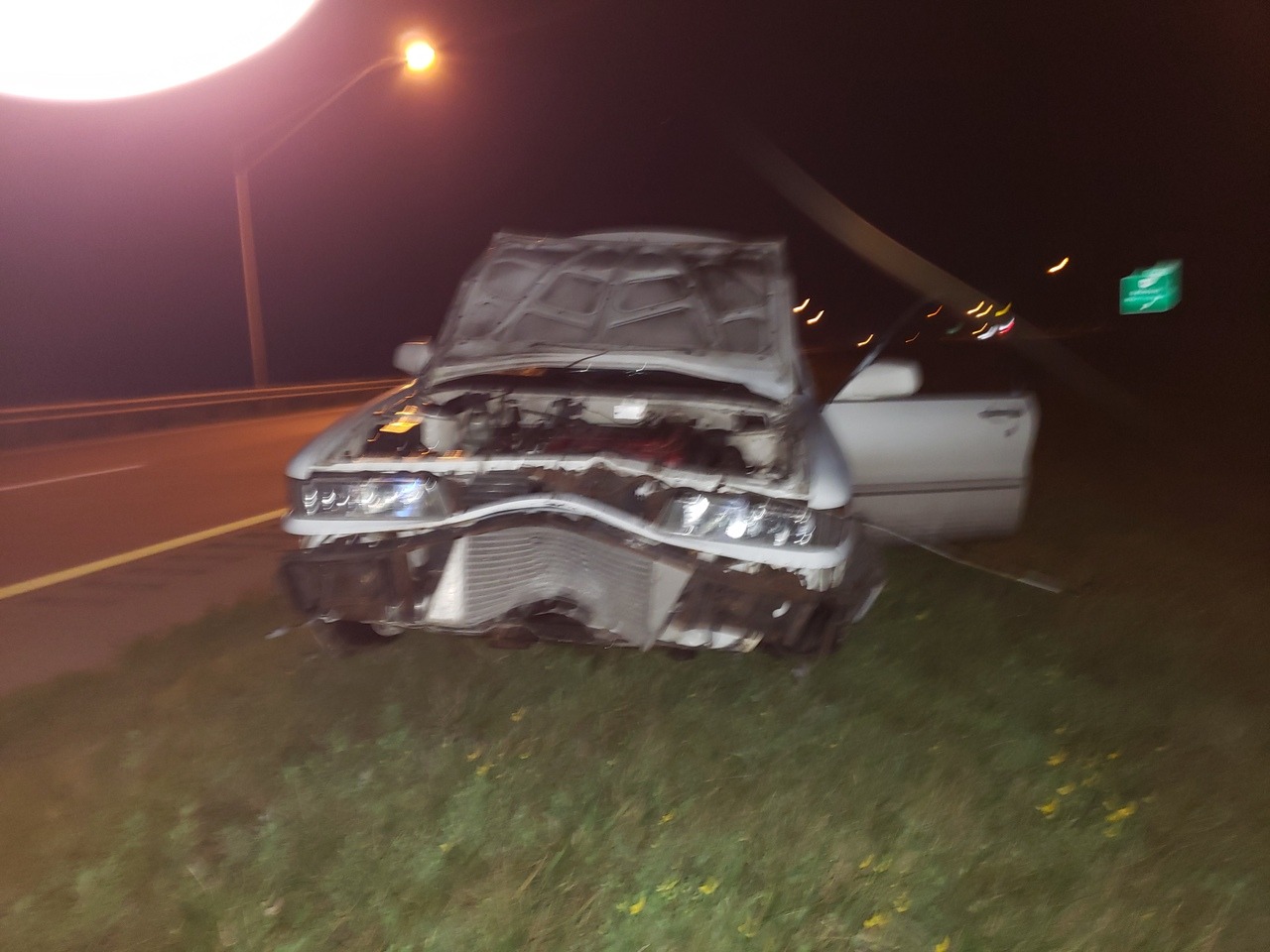

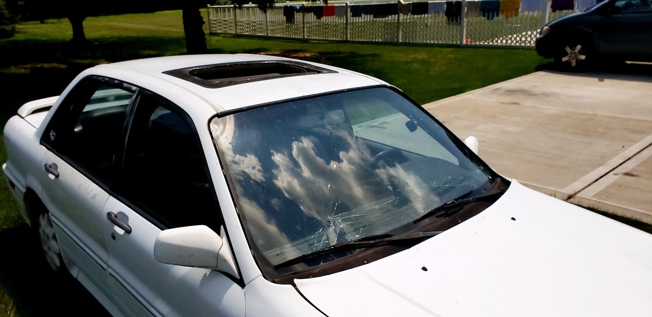

-- Introducing: Rogue semi tire. Like a mysterious figure materializing out of the darkness a completely free-roaming semi tire bounced its way across the median and squarely into my lane, crossing just through my headlights in time to invoke a very serious case of What-the-fu*k-itus. A moment later the tire slammed square into the center of the front end of the car, demolishing quite a lot on its adventure through the grill. The hood latch was absolutely demolished, causing the hood to suddenly, and violently, make pleasantries with the windshield (and sunroof, and the top of my head via the sunroof... tall people really probably shouldn't drive these things).
Pardon the poor quality of the image, this was taken literally 2 minutes after the event and I was still a little shaken, and regretting my decision to not wear brown pants for my blind 70 MPH adventure over to the shoulder/median. (Which went surprisingly well, was able to just run her through a rapid, but safe decel.)

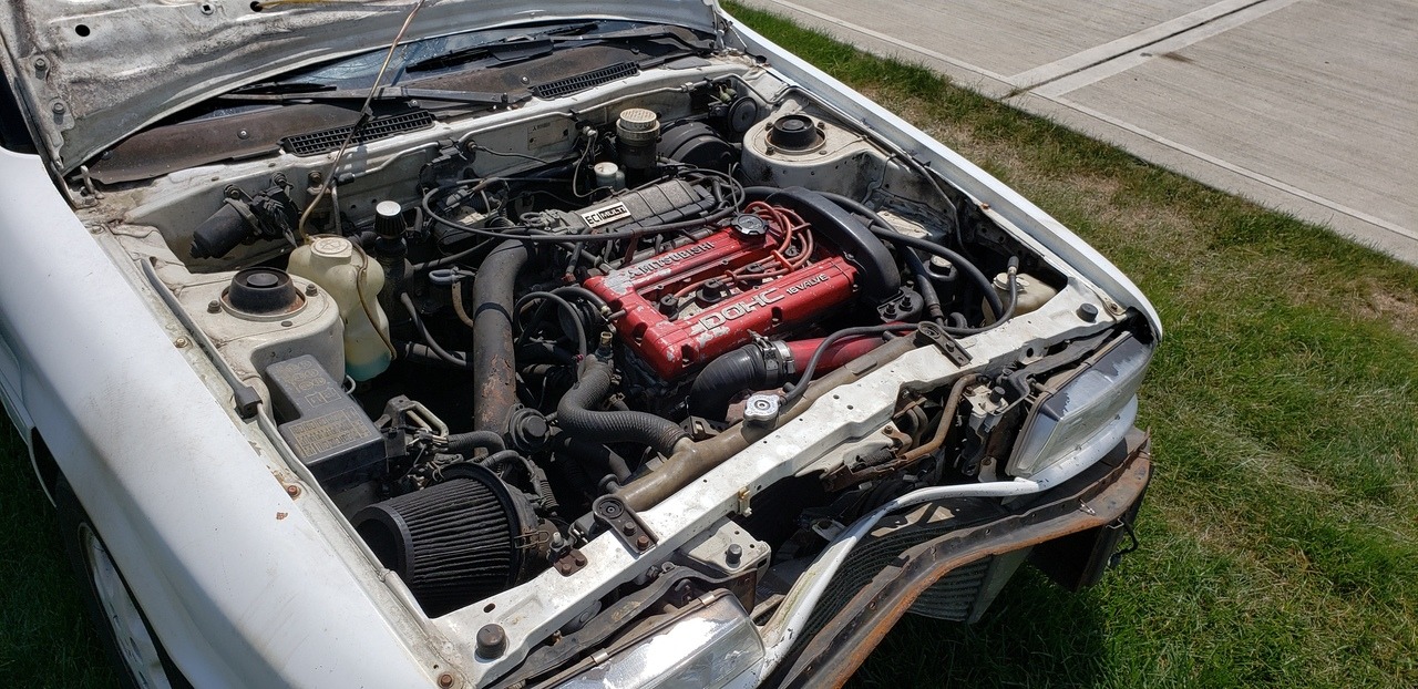

Eventually, after reciting a sailor's dictionary into the night, I got the car towed. The next morning brought light to the damages.
Needless to say, this was rather annoying.
Unfortunately, I don't have another VR4 to transplant parts off of. I will, however, be planning to rebuild this one. I'll probably be posting something in WTB. Figured that after going mostly silent after the build thread I'd make a 'quick' post.

If there's nobody closer, I've got a sunroof glass I can get in the post if you need it.
Be best to at least get that sealed up before winter. /ubbthreads/images/graemlins/smile.gif

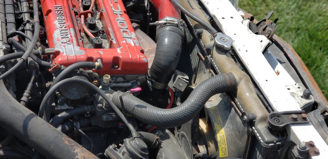

A hit like you took will probably have pinched both front wings in a bit.
As the radiator supports buckled / came back, (and probably up) it probably brought the inner fenderwells where the rad supports attaches along for the ride. This means the hood gap will be tight to the fenders on a taper, worse towards the front.
It *might* be better to leave the old upper radiator support in as you make the forward pull / straighten things. A wooden buck / support could be very usefull if you could make one to fit behind the radiator support.
... just a piece of wood whittled down to fit in the recess behind / under the origami folds of the support
That way, when you make the pull, it'll give you more anchor / pull points and will spread the load. It will also allow you to more acurrately control the pull. (I've been able to save a few supports using that technique, but yours looks pretty tweeked)
Same for making a splint for the bottom support, only it will have to go behind the whole structure, and it *may* crush / deform the back of the member during the pull. That lower support is fairly beefy, so it'll take some force to manouevor / pull things back into position.
I'll try to find the unibody dimensional map that's posted here on the site during some downtime tomorrow.
I think it's in the library somewhere.
Measure twice and pull once, trying to work the same plane as the original deformation, only opposite like. Visualise what it took to get the bend that you got, then just undo it.
Simple, right? /ubbthreads/images/graemlins/smile.gif
Good luck and keep us posted on your progress.

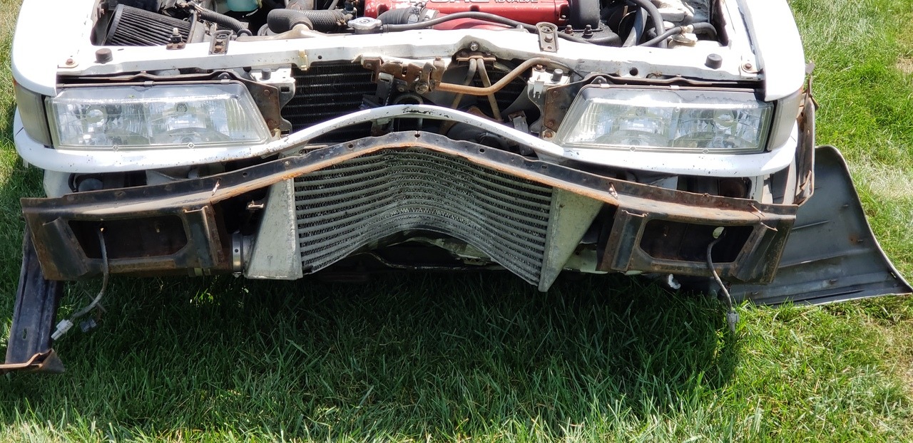

I haven't' been able to put a wrench at it at all yet, the soonest I'll be able to start pulling things apart will be this Labor Day weekend. Been working lots of overtime to gain funds for the rebuild process and now my Senior college semester is about to start.
As you can see, I'm going to need one hell of an extension to get into it.
When I do start pulling pieces off I'll document it as best I can. I'll probably start a rebuild thread. I'll probably get the major holes filled before the end of the year, but, I'm not expecting to be able to have everything buttoned up before 2019 ticks over. (I'm totally using the 'while I'm in there' card and bolting up some things I've been putting off for a rainy day. New stainless 3" turboback, maybe rebuild the 16g, maybe a proper manual steering rack replacement, etc. /ubbthreads/images/graemlins/devil.gif)
The advice is very much appreciated, and I'll certainly keep it in mind when I'm getting into it. If you find that dimension guide that'd be absolutely fantastic, if not I'll look around for it. Thankfully I've got a fantastic community to get parts from, so I should be able to test fit and fuss with getting things lined up again.
