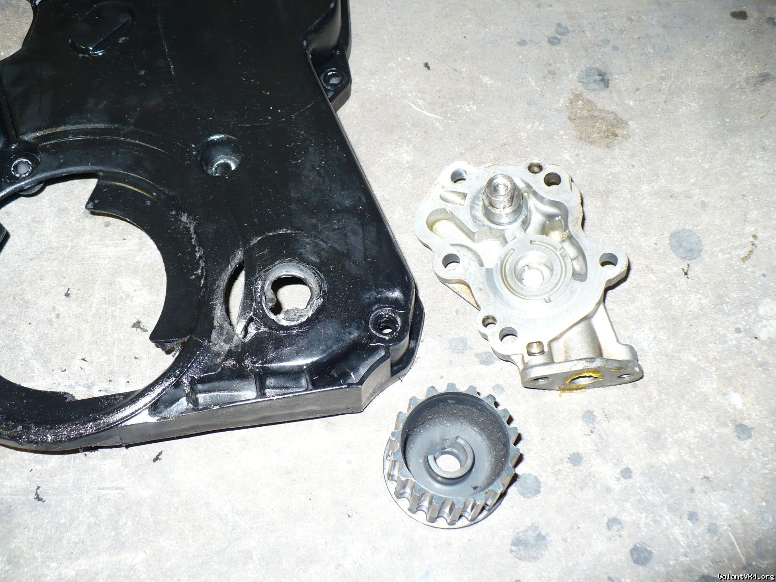

Oil pump stub locked up and sheared the gear off, almost through timing cover. It jumped time...Don't know damage to head as of yet. Got pan off,frontcase is off. Going to fix that first then do a compression test and leakdown test to see if damage to head.. I'm thinking the worst but praying for best. Back to drawing board..

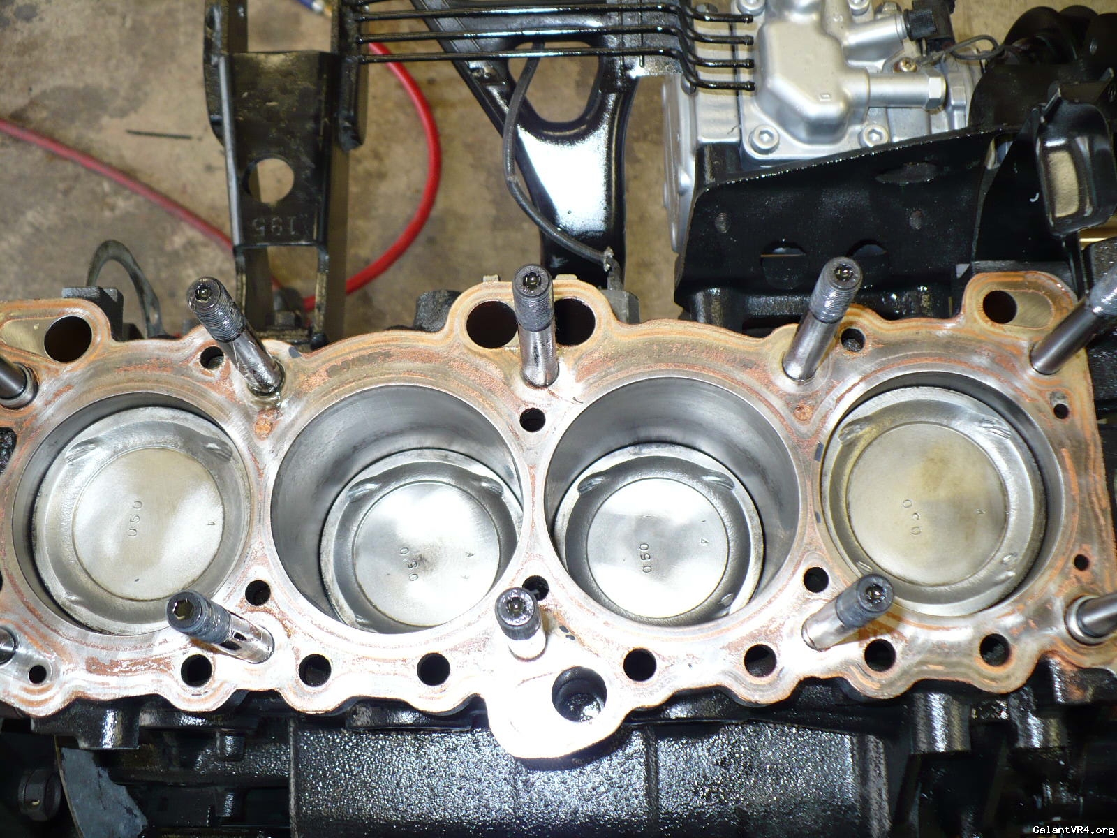

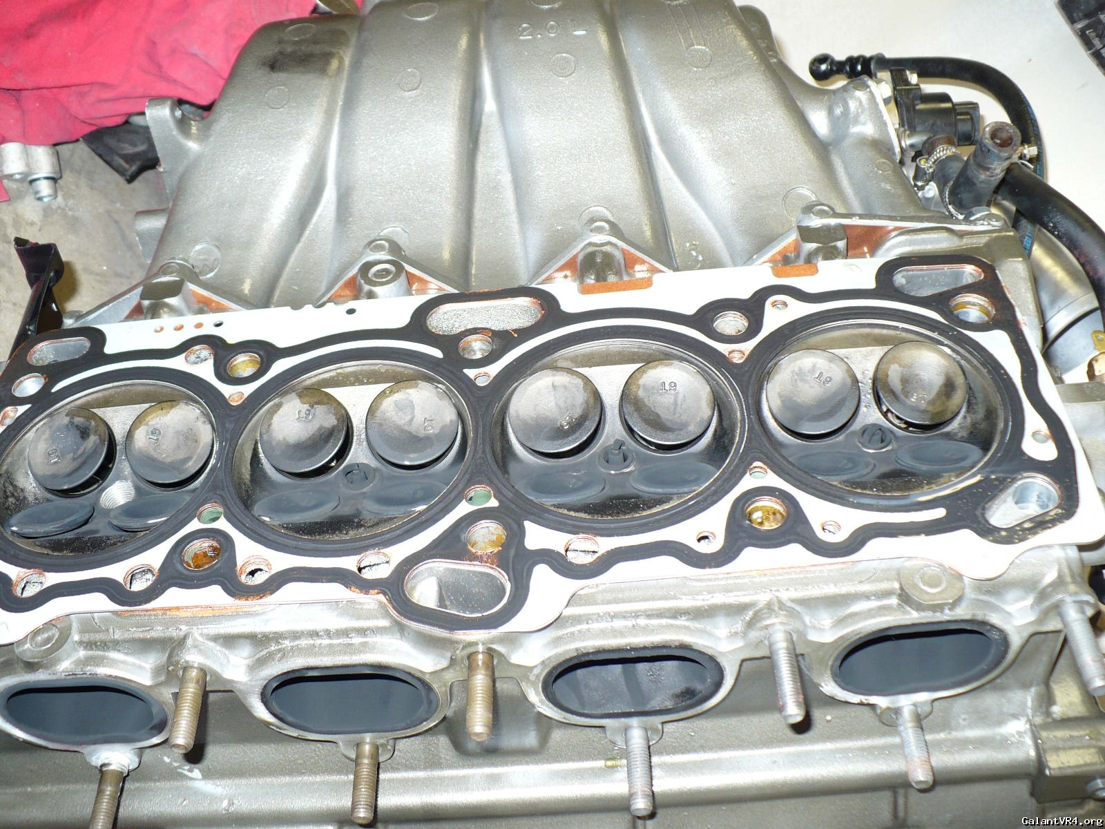

There was some noise in valve train when it jumped time. So I know head has some bent valves. Motor is coming out today. Its all unwired and tranny is coming off in next hr then block. The whole motor is going to get dissasembled and put back together again...Set me back a couple weeks..The Price of owning a DSM.

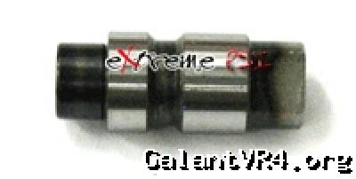

Its a solid stub from parts dinoasur. The mistu one has a hole in it for oil to go through. I just found out today from a friend in tenn that people were having problems with the solid stubs. I just happen to be one of them. No worries though I got all parts on order and a factory stub from mitsu.
The solid one in pic is a new one from another BS kit I got here. See the difference from the factory one.

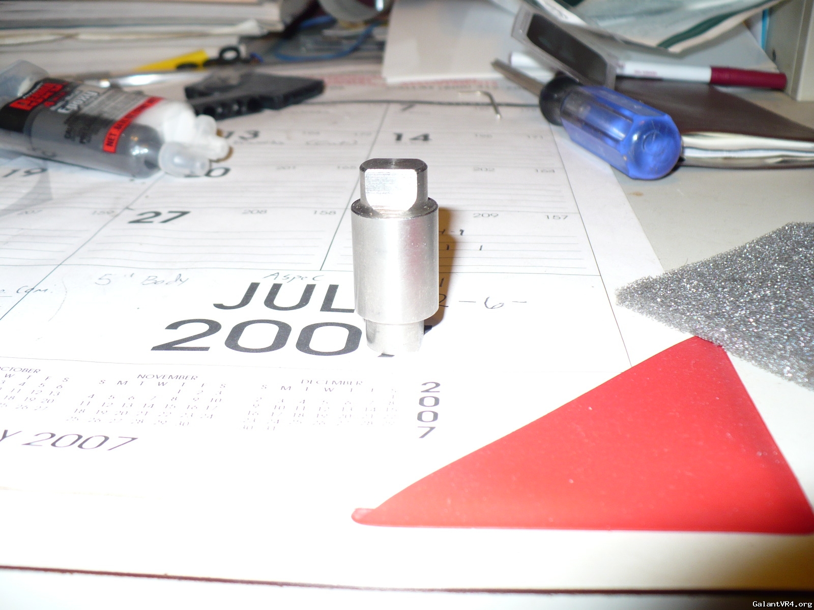

I'm bring this thread back to ask a question.
Since my motor is apart I looked at the BS stub and it looks like the bottom one in your picture but there is no hole in it. Can some explain this?
