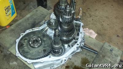

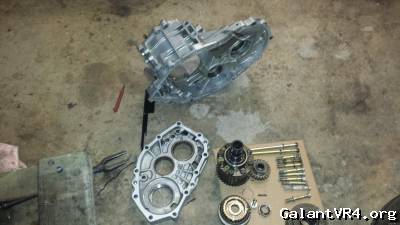

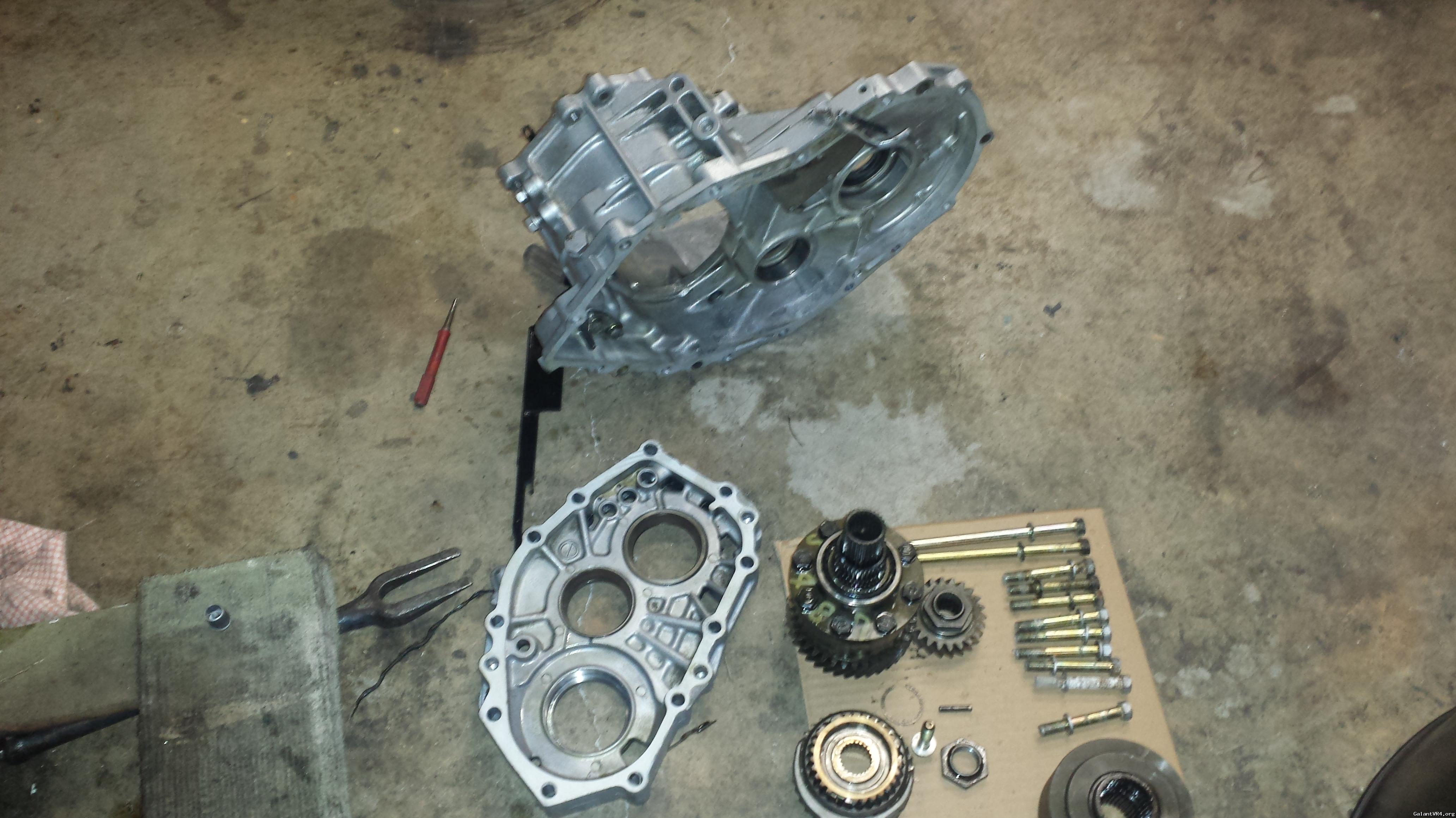

Since I'm keeping it I picked up a used trans and xcase for less then 350.

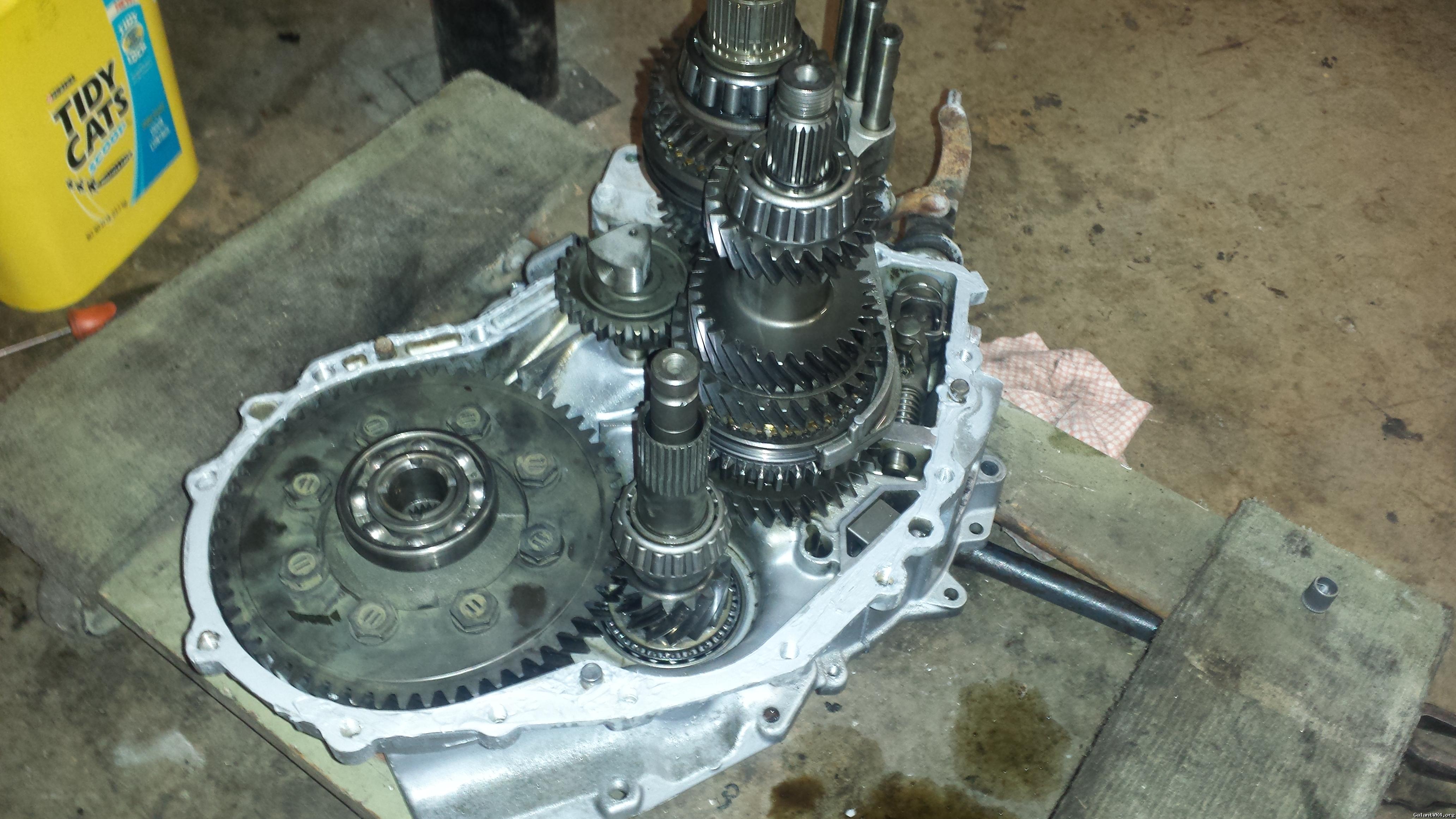

Trans felt gritty so I opened it up and cleaned out crap and dead roach. I found viscus coupler cracked removed one from a 97 AWD trans I got here..Good to go. Put back together and installed...Test drove and shifts fine.. SAD part is I should have known better and replaced the seals..OUTPUT shaft seal leaking..So back out with it and remove top cover to get shaft out and I got all seals on order.

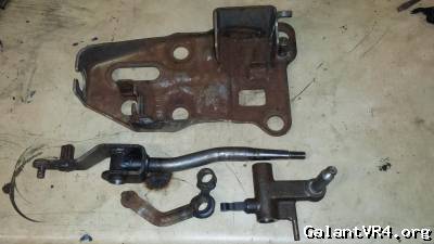

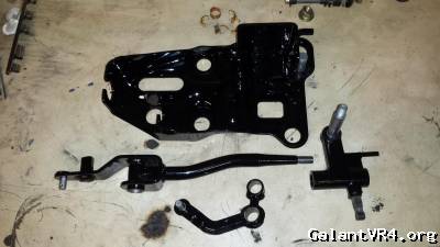

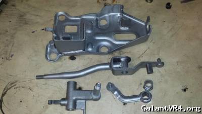

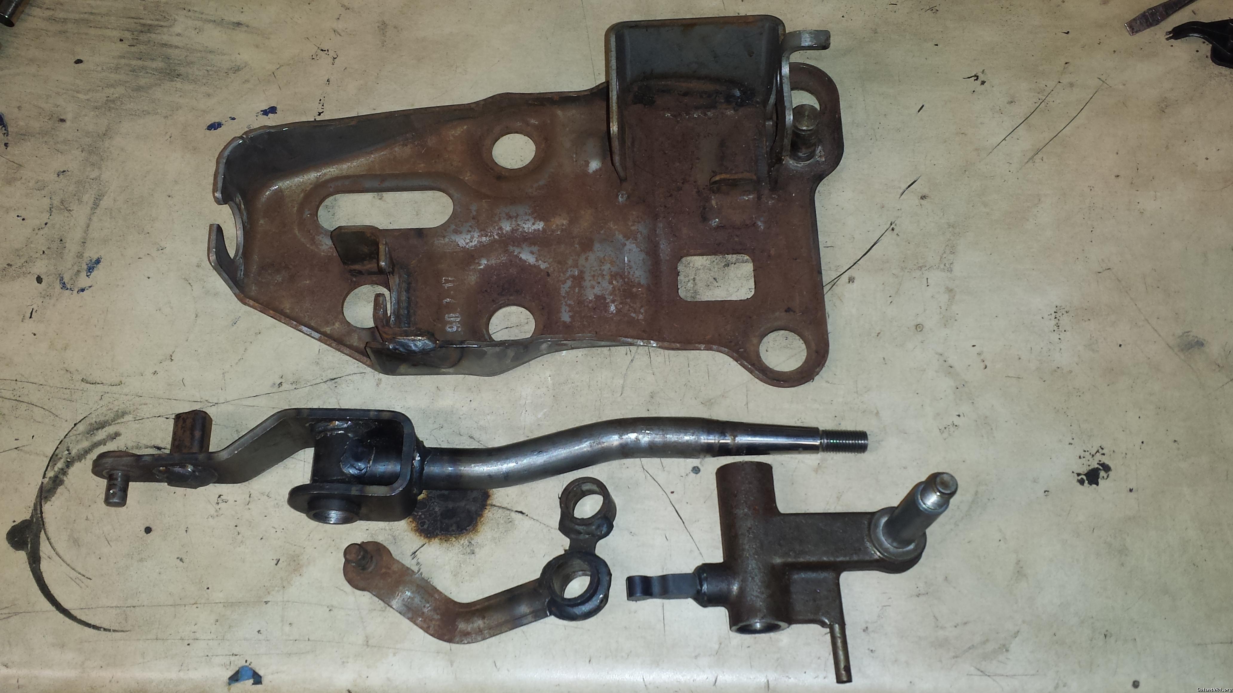

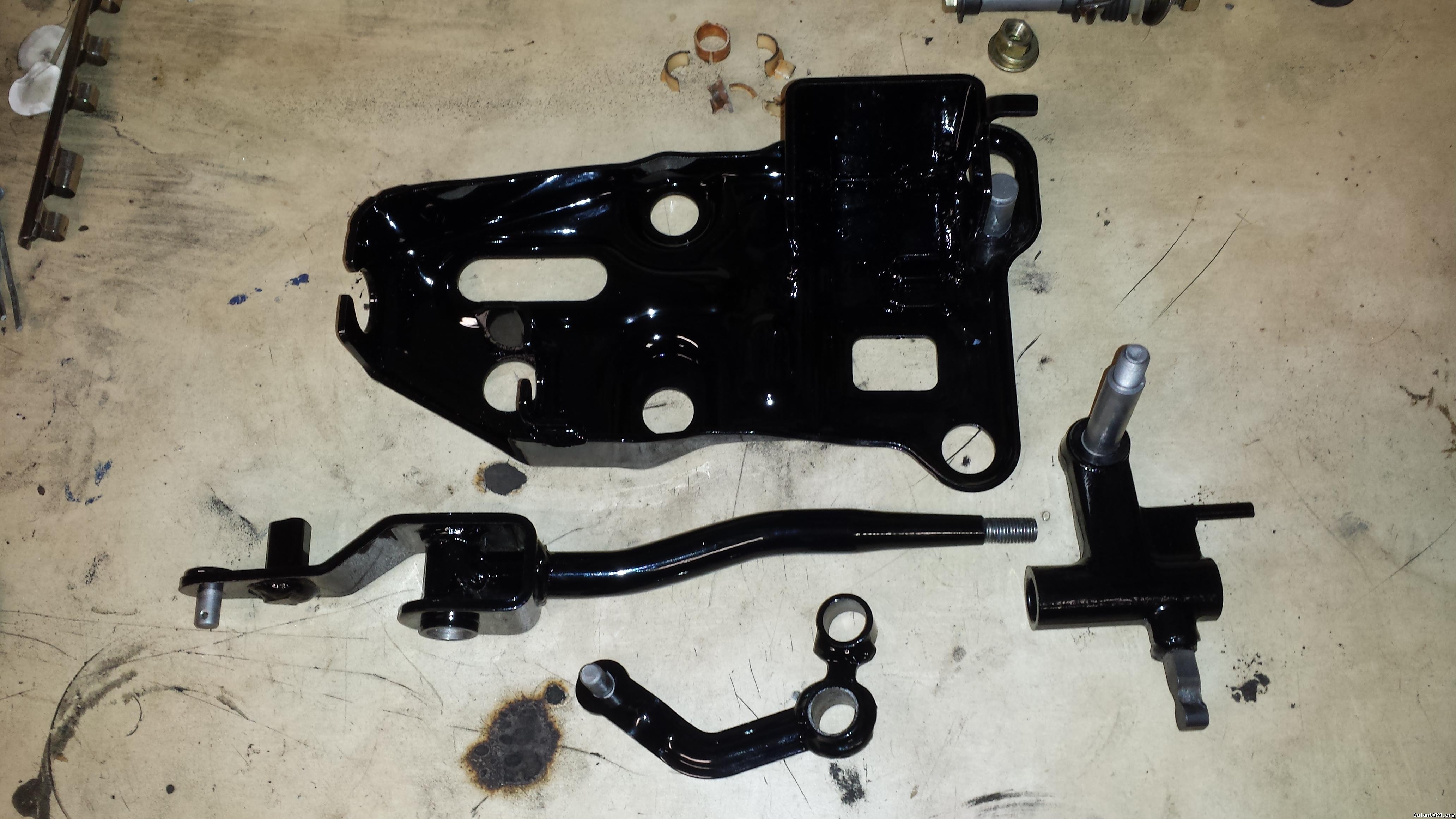

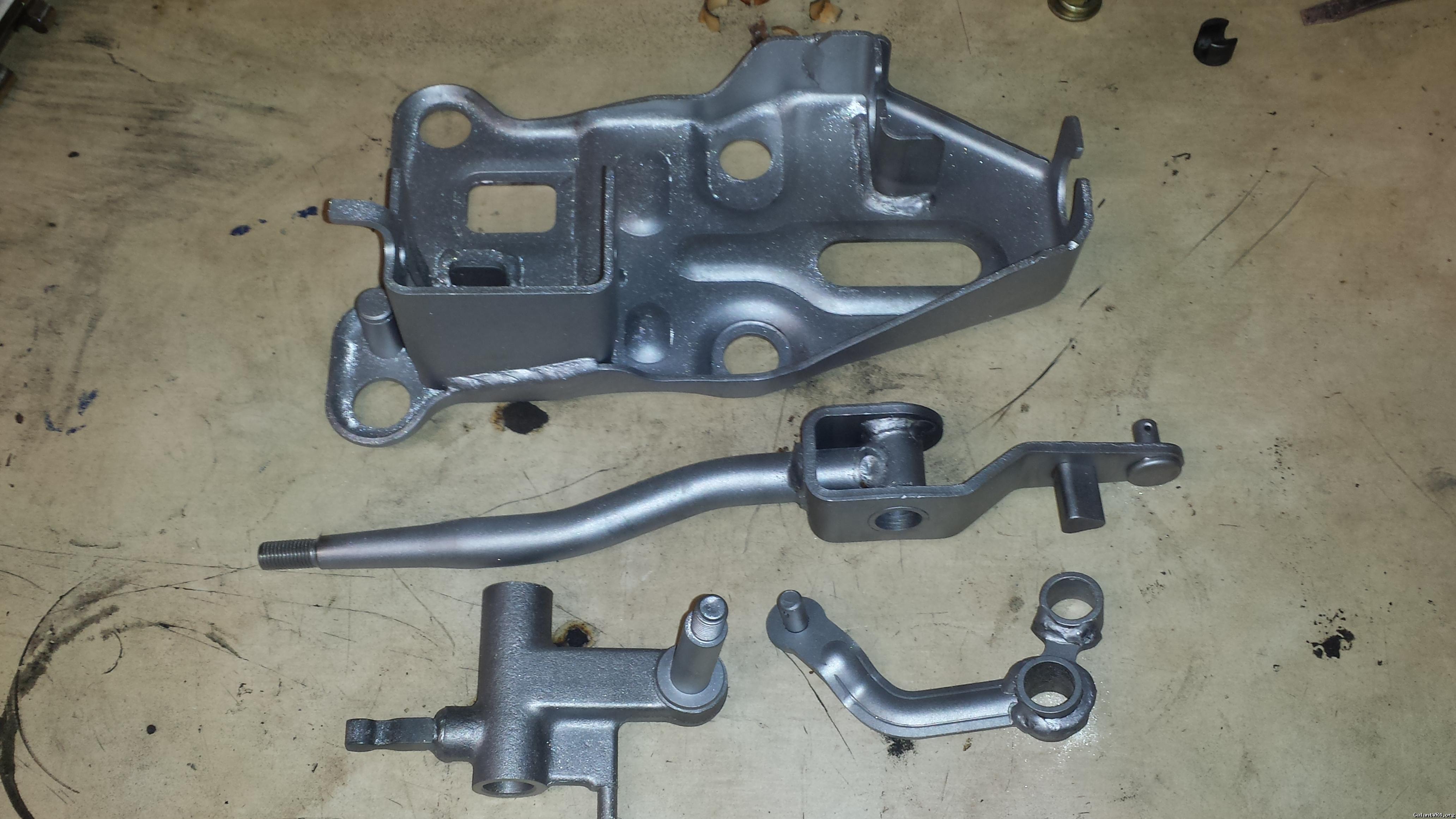

Shifter felt little sloppy to me so I removed it and ordered all new bushing..Sandblasted it and powder coated it gloss black. Came out good

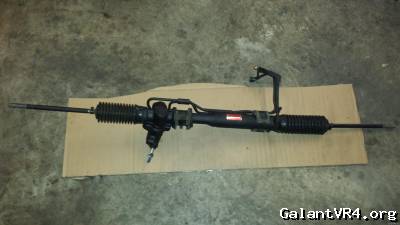

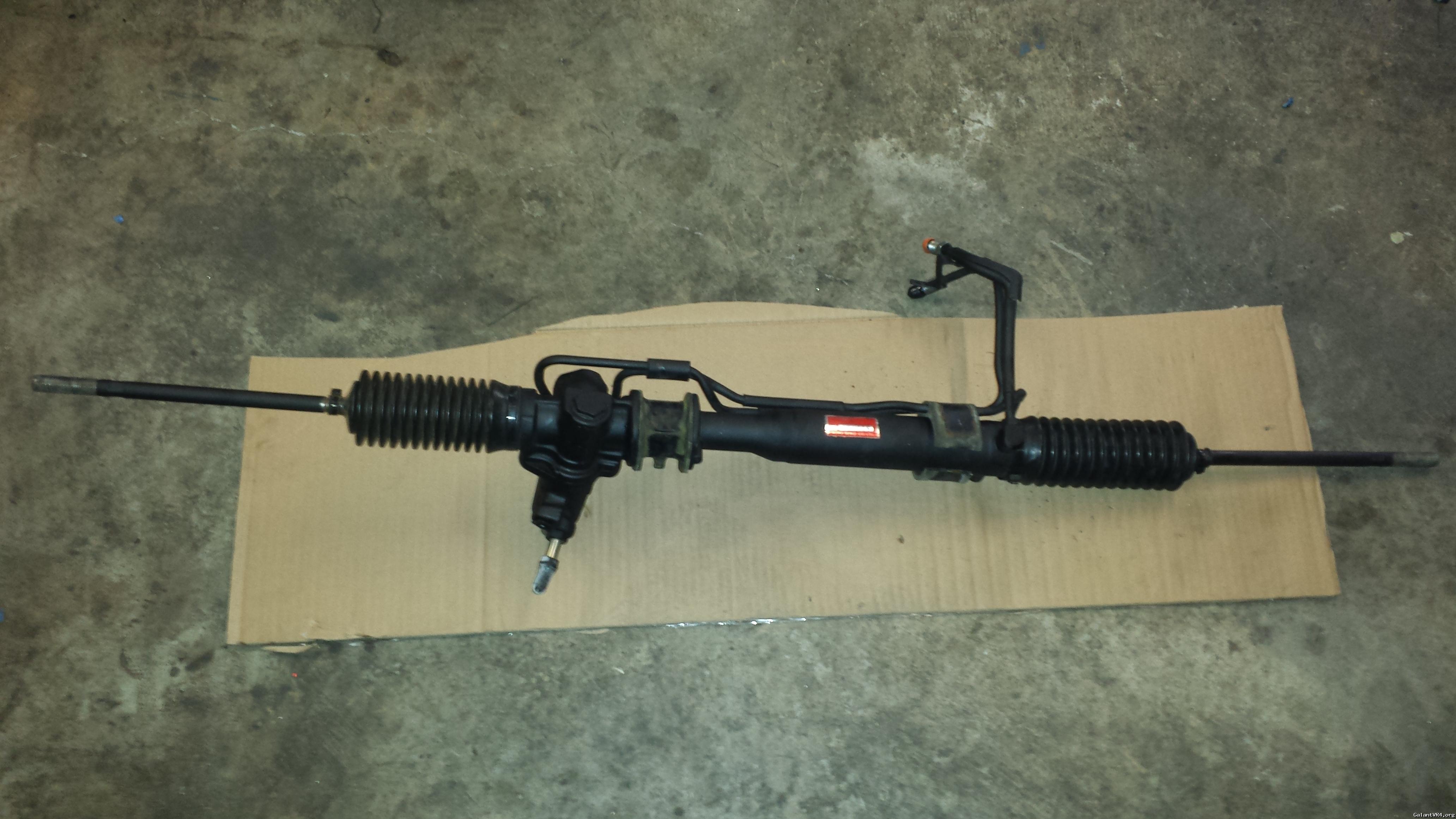

found power steering rack leaking...Thank god for a friend with 2 wrecked vr4's. picked up another rack for free. new boots, fresh paint and ready for install. I may rebuild my other one.. seal kit is 110.00 OEM.

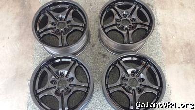

I may sandblast the rims and re-powdercoat them in bronze...I just did my bmw rims in gloss black and they came out good. SEE PIC too bad I cant do bigger then 17's. Anything bigger wont fit in oven.
