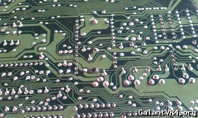

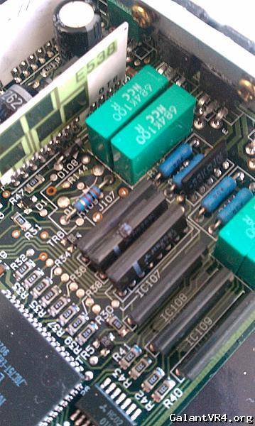

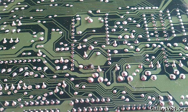

ISC Drivers
The 47uF capacitor shown in the upper left hand corner of the above picture will leak and cause a short on the trace in the picture below. This causes the ISC drivers to blow.

Just take a look at your ECU. You may not have to send it out for repairs. If the capacitors haven't been replaced, its not a difficult task. Also you can replace any ISC drivers that might have failed. If you had ISC drivers that failed, you may have a burnt trace that will require a repair or jumper wire like I did.
