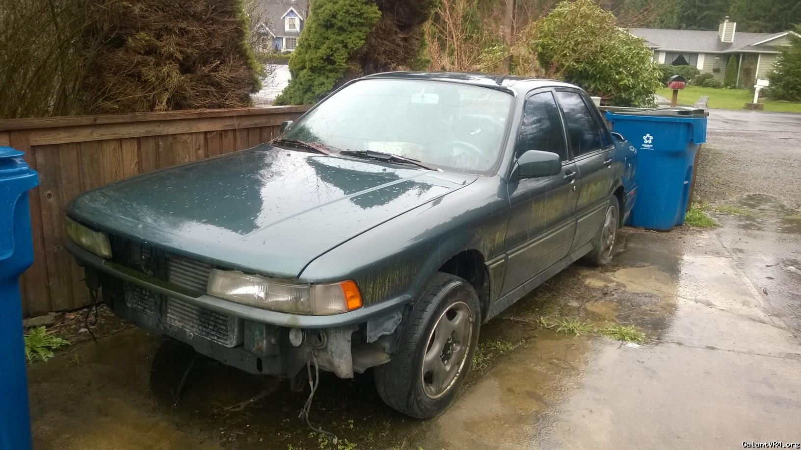

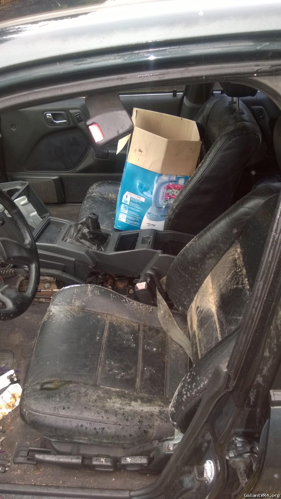

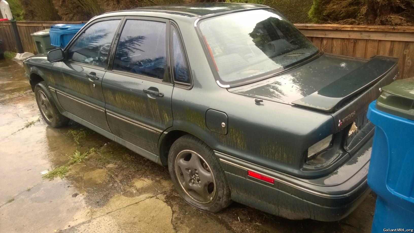

How she sat when I saw her during the day light hours. Not good but definitely not the worst I've seen. The interior is all there just thrown in the back seat and trunk. /ubbthreads/images/graemlins/idea.gif

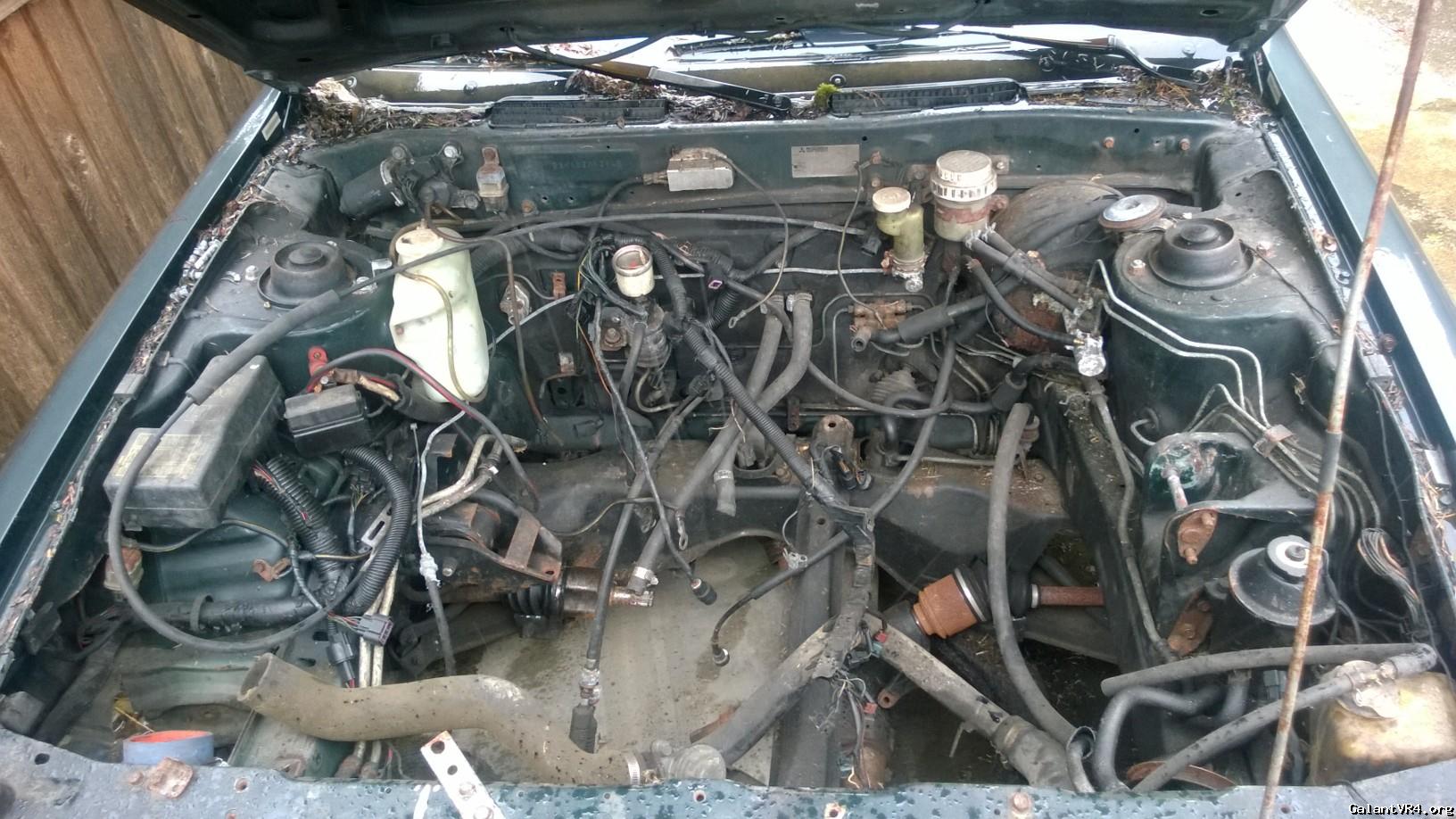

Currently I have the engine I got from DSMguy torn down and awaiting the parts I need to get the head rebuilt and new cams installed. Once thats together the engine will be reassembled with new gaskets, timing belt, and ARP head studs. Should be picking up the transmission and transfer case in the next two weeks. Than all I need is clutch/flywheel and new motor mounts and it will be placed in the car.

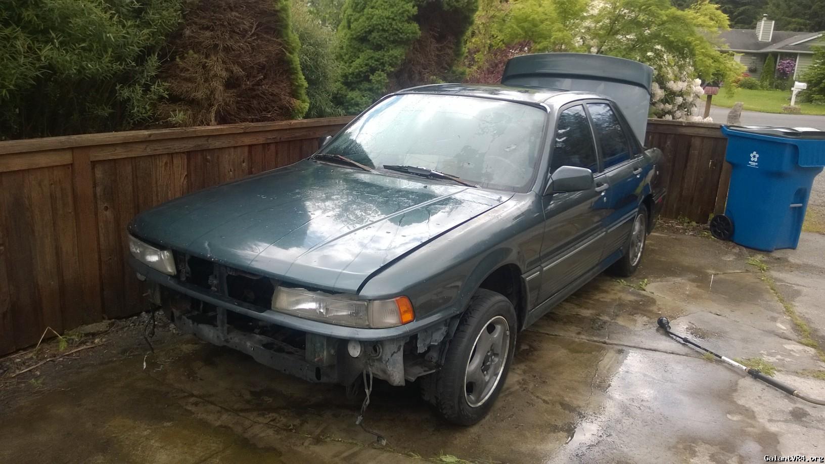

This is how she looks now after giving her a good wash outside. The inside has to wait as I need to replace the front windshield as it's cracked. Once that's done, it will be cleaned and put back together.

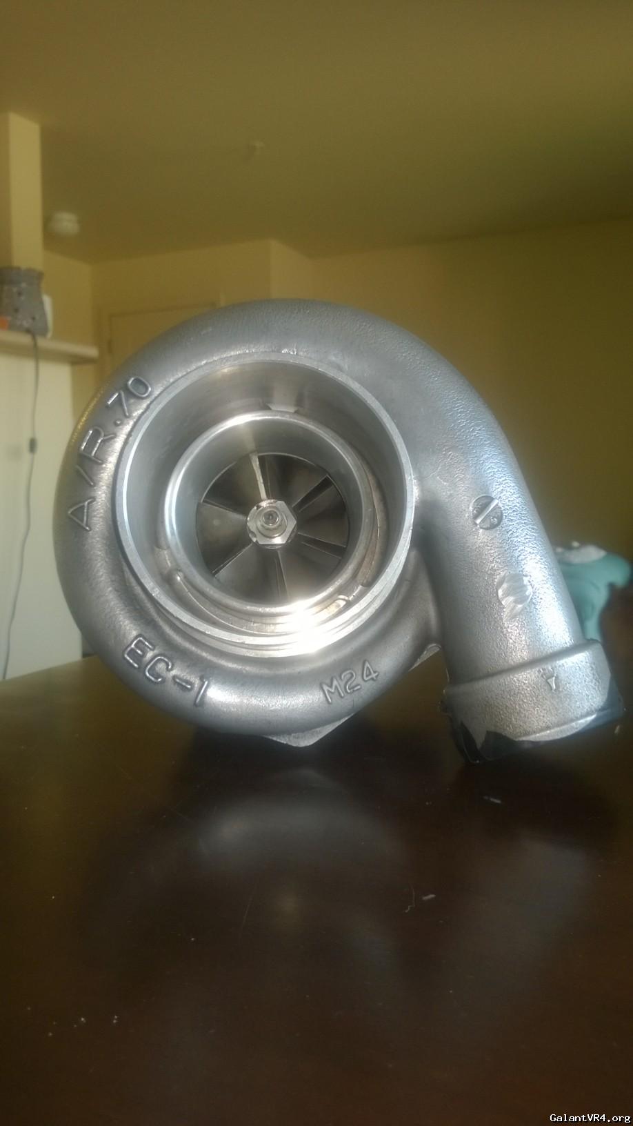

Very excited to throw this in and see how she does. If it's anything like Mitsuturbo's car, I'm in for some fun times. It is an FP3065 that I got from another member of this board.
