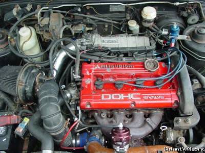

here is a pic of the engine bay before i started.
cant see much but she us in poooor shape. there where no blots holding the timing cover on so it was rubbing against everything, it
also had NO timing shileds installed. theres a 57trim t4 with stock injectors LOL (vpc etc was stripped before i got it) also stock head bolts...
The ic pipes where 1/2 aluminum and 1/2 rusted exhaust pipe with non boost safe fake silicon coulpers/ worm gear clamps.... the bov location was horrible
and most of the coolant hoses where loose. most if not all the vaccume lines where loose and or leaking.
thank the dsm gods that i got to this one before it was too late.

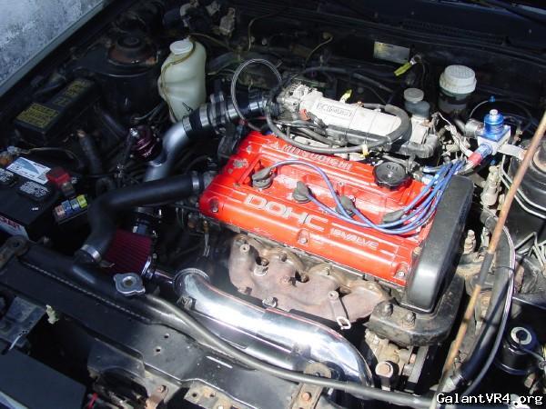

here's what ive done so far.
rebuilt MHI/FP 18g (tdo5h)
2.5" aluminum ic pipe
4 layer 50psi safe silicon couplers
t-blot clamps everywhere
EVO8 560cc Injectors
3"GM mas

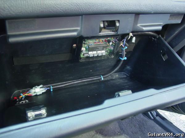

GM-MAFT Glove box direct ECU intall
logger cable direct ECU install

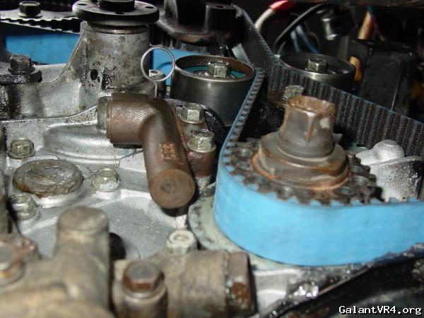

Kevlar Timing Belt
New Timing shields
ARP Head Studs @100fp Moly
Manual Boost Control
12" Slimline Fan
JDM-RS Front Grill
cruise, evap, egr all removed
Polish

Your Intercooler pipe will cook like an egg without a heat sheild on your exhaust manifold.
I was thinking that too. they where long gone before i got it /ubbthreads/images/graemlins/banghead.gif WTB cheap one when i can afford it /ubbthreads/images/graemlins/bawling.gif
