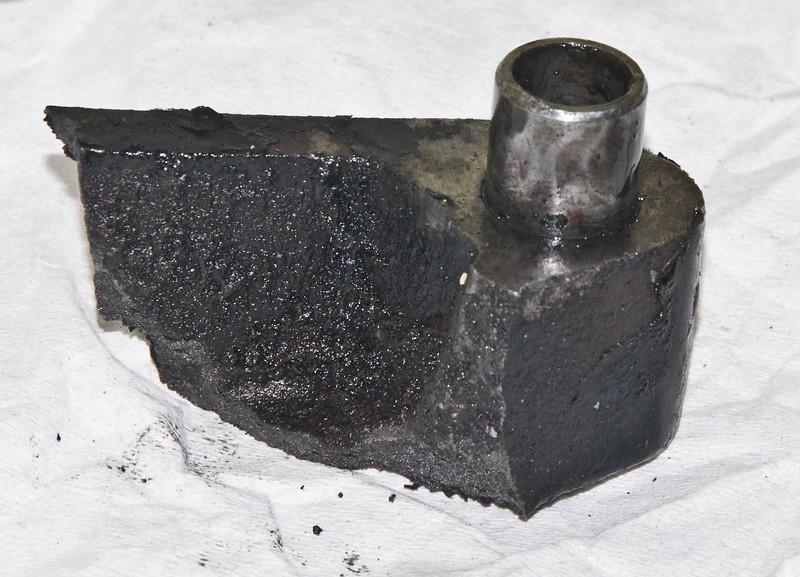

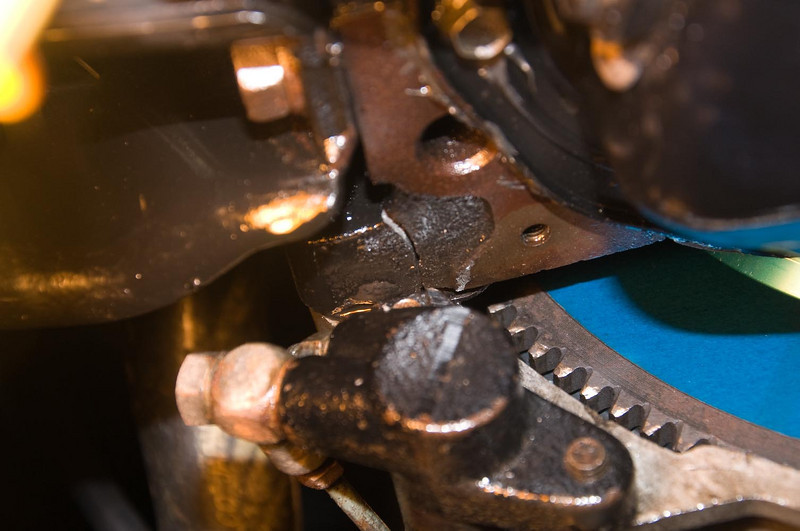

Well seems I found another issue while the car was up on the lift for the broken axle. Typical /ubbthreads/images/graemlins/mad.gif
the small part of the engine block that has the threaded hole for the front lower trans to block bolt has a crack. Iv had multiple times In the whopping 600miles iv driven the car since building it, had to tighten the 4 trans-block bolts.
First I noticed the top two 14mm bolts loose after the first night at the track and cracked them down. While I had the oil pan off 2 weeks ago, noticed the lower rear 12mm bolt was backed out. At the track last wed, Act250r cought the upper two loose again. Now the lower front is cracked and the 12mm lower is backed out, this time in literally 25miles.
Any ideas on the problem? The engine vibrates real bad with the prothane mounts.

I would start by getting rid of those end mounts and switch over to rubber. Are you going to have a go at having it welded?

Arg! Big chuck of block is broken off, I think leaking oil. There was about 2/3 quart on the floor under the car. Called Brent @ JMF for his opinion on welding, which he says block casting is shitty metal that gives porous welds. I'd imagine it would be nearly impossible to do a leak-free clean weld with the engine in the car, not to mention the trams has to come off anyway.
Sooo.... Looks like 11.1 will be my season best, as if the engine has to come out, I might as well take my time and do additional fixup at the same time.

99% of the time that is caused because the block is missing 1 or both dowels that help locate the trans to the block. When they are not there the trans can move in a twisting motion and losses up the bolts. That will then make the tranny flex away from the block when you are pushing in the clutch. Over time it crack's the block.

I'm not sure what's causing the bolts to come loose. Maybe I just haven't ever had all 4 tight at the same time and that little bit of flex from one being loose allows the other 2 to come out? WTF? The front 14mm bolt has never been loose and it was still screwed tight today (into the snapped of chunk of block shown above). Front and rear dowels were in. The correct length bolts were in the right holes. I'v built DSM's from the ground up over and over and done, seriously, 75 DSM tranny swaps & clutch replacements over the years. I'v never seen issues with trans bolts that just refuse to stay tight.
Never had issue with my last racecar w/ poly mounts, no BS shafts, bigger clutch, more vibration.
The thing that is really weird is I tightened up the 12mm lower rear bolt and the top two 14mm bolts when I had the oil pan off 2 weeks ago. The car sat on the lift, drove to my house and the gas station, then to Island last wednesday. Maximum of 25miles total. In that 25 mile span, the rear 12mm was about to fall out, and the top 14mm was real loose at the track after maybe 14miles on the street. Both dowels were there, the correct 6bawd starter plate is there. Clutch engagement is fine. Just don't see how these bolts are coming loose in such little time when all 4 were tight to start this last time.
REALLY sucks that the engine is going to have to come out to fix this, and I may have to get another block if it can't be welded cleanly to stop the oil leak. Won't be getting to the track to run a 10 this year I guess. /ubbthreads/images/graemlins/banghead.gif /ubbthreads/images/graemlins/banghead.gif /ubbthreads/images/graemlins/banghead.gif /ubbthreads/images/graemlins/banghead.gif /ubbthreads/images/graemlins/banghead.gif
