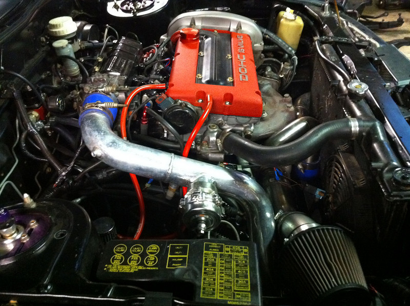

This engine is a 2G piston 8.5:1 CR, with ARP L19 headstuds, stock HG, stock cams, stock 1.6L head, BSE kit. Everything else was transfered over from the last engine. The car is running a small 16G with an E3 7cm turbine housing. Planning to hit the track with it next friday and see what I can do on the 16G with both pumpgas and E85.

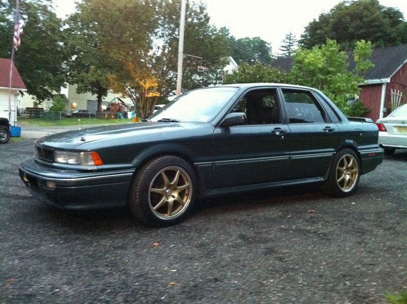

The car also has a different set of wheels & tires: SSR 17 x 8.5" GT7 with 235/45/17 Falken tires. The +35mm offset is not enough for the front and the tires are hitting the fender. Currently running nearly 0 camber, so I'm not sure how much negative adjustment I'd have to use in order to tuck the tire edge under the fender for bumps. I'm somewhat undecided to keep/sell the wheels and tires.

Play with camber in the front to see if I can get the tire to not touch the fender. The car also pulls a bit to the right, adjustment is likely off side/side since the strut & hub was apart.

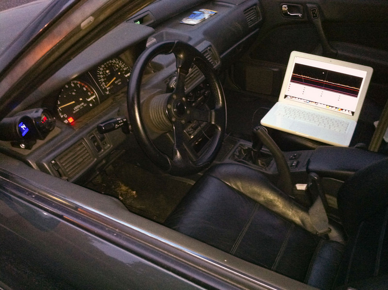

Then some toonering with DSMlink to get the pumpgas map up to snuff....I'm loving being able to use Mac now that I switched over to DSMlink, where I was stuck on winblows with DSMap.

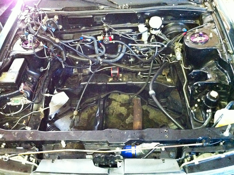

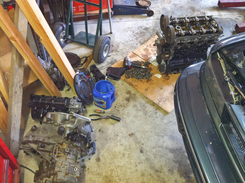

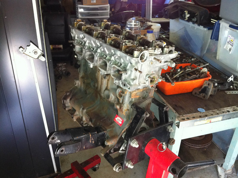

Few random pics from 7/6 (one week ago)
new longblock on the engine stand
Old engine on the floor last tuesday.

It's exactly the same on windows or mac, other than the exit button is on the other side. /ubbthreads/images/graemlins/dunno.gif Seriously, It's just nice to use my own laptop instead of having to borrow one that Im not familiar with, plus I don't have to transfer files on/off when I want to check stuff out later. And if the laptop battery is dead 10 min before I leave for the track, then I only have myself to blame. hahahaha
