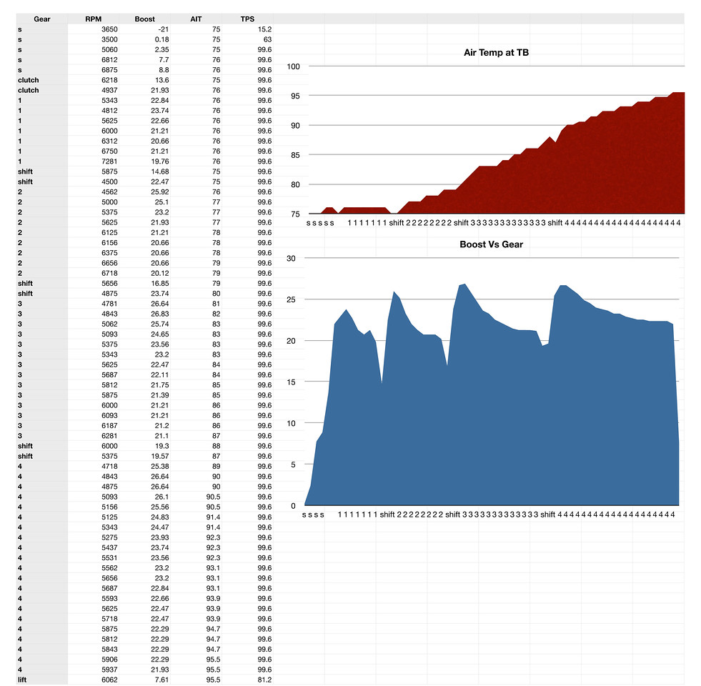

It's at 26psi for like seriously 150rpm before it falls down to 23psi. for instance 3rd gear on the 12.16 pass:
4906rpm: 25.38psi
4968rpm: 25.10psi
5100rpm: 23.28psi
5400rpm: 22.29psi
5656rpm: 21.75psi
6031rpm: 20.66psi
Boost falls off REAL fast...the datalog graph really shows a quick spike and it settles down to the 22psi range right away. Ait temps at the throttle body didn't seem as affected by raising the boost past what most people think a 14b should run by nearly as much as I would have guessed. And the car did pick up some mph by raising the boost each time.

As per the 14b air temps...yeah I was very surprised! Below is the graph from my 11.1 @ 123 run with a 50trim T3T4for comparason: Note the AIT is way up at the end of the track and both are 75 on the starting line.
datalogGVR4.pdf
