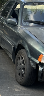

I did some exterior work. The front passenger fender's moulding has been sticking out at a 30 degree angle acting as an air brake that could self-destruct at any moment, so I took the time to remove the fender and get it fully reattached. It turns out it wasn't able to be attached because not only the fender was all bent up but also where it mounts to the body of the car along the pinchweld was all bent up. I spent some time with a hammer, a 2x4, and some punches and straightened everything out enough for it to reattach properly. Used fresh 3m double sided tape and reinforced the clips with zipties and wa la.
Before: IMG_8579.png
After: IMG_8578.jpeg
