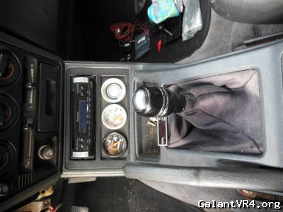

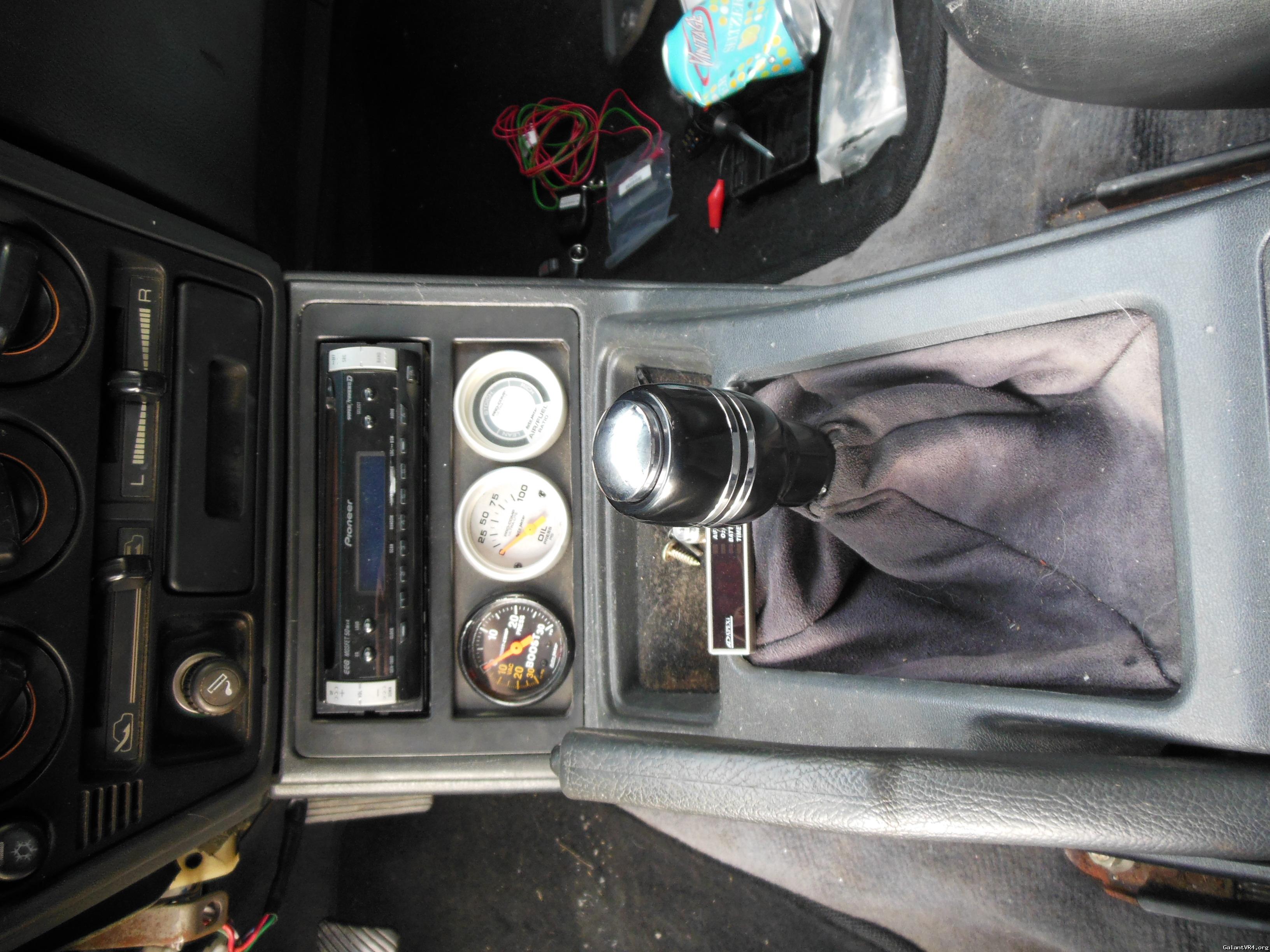

thanks brian. yeah i was trying to figure out how to make the car look stock in the sense of it being a 5 speed, yet still unique and different. im really happy with the suede and how it looks and that not many people have a suede shift boot except for 138... haha

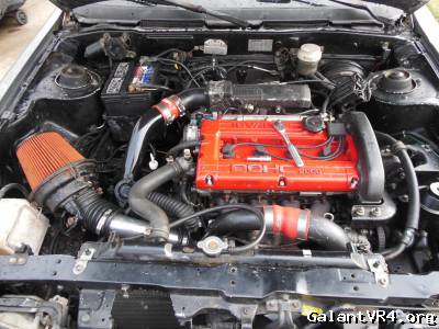

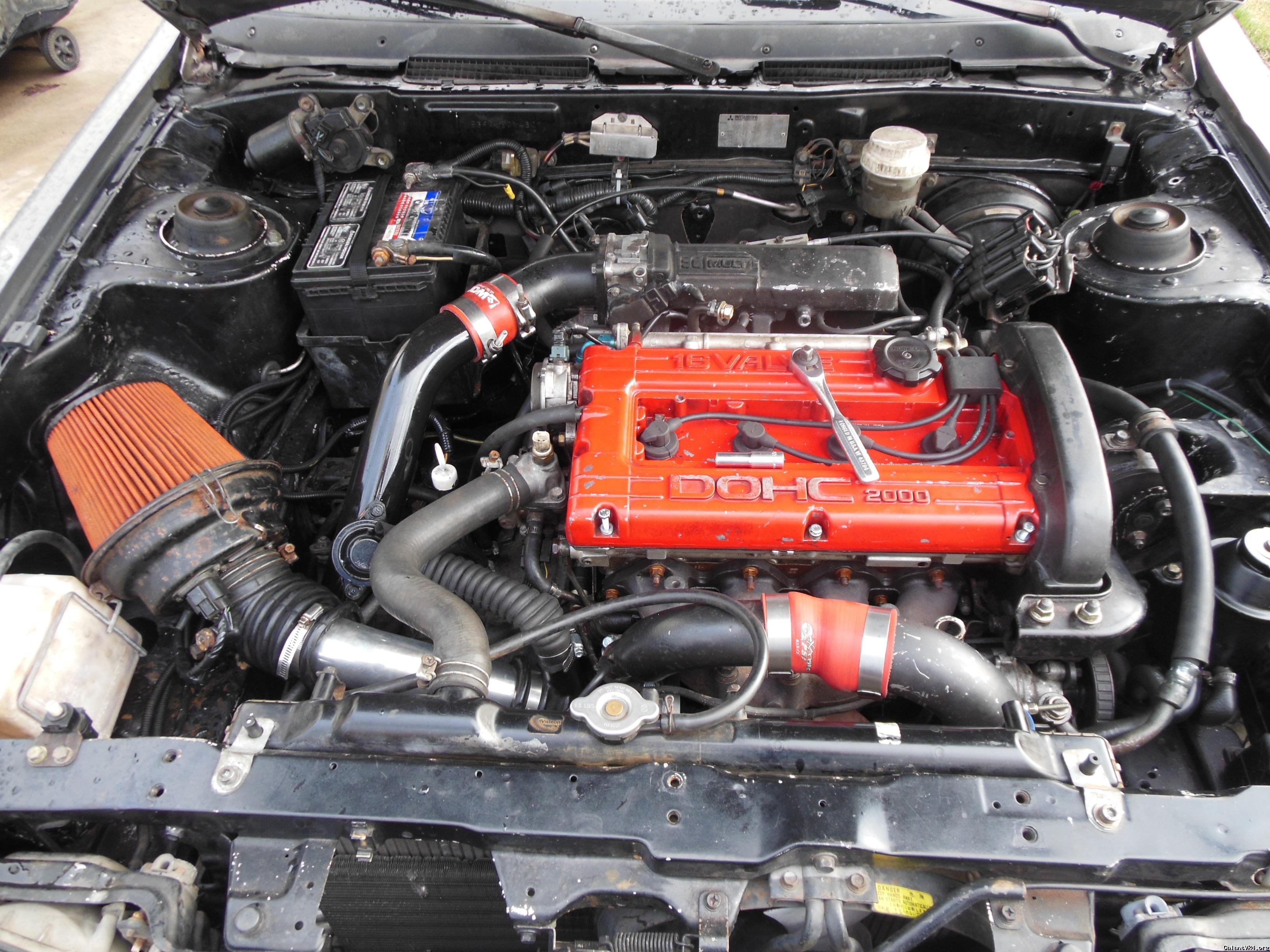

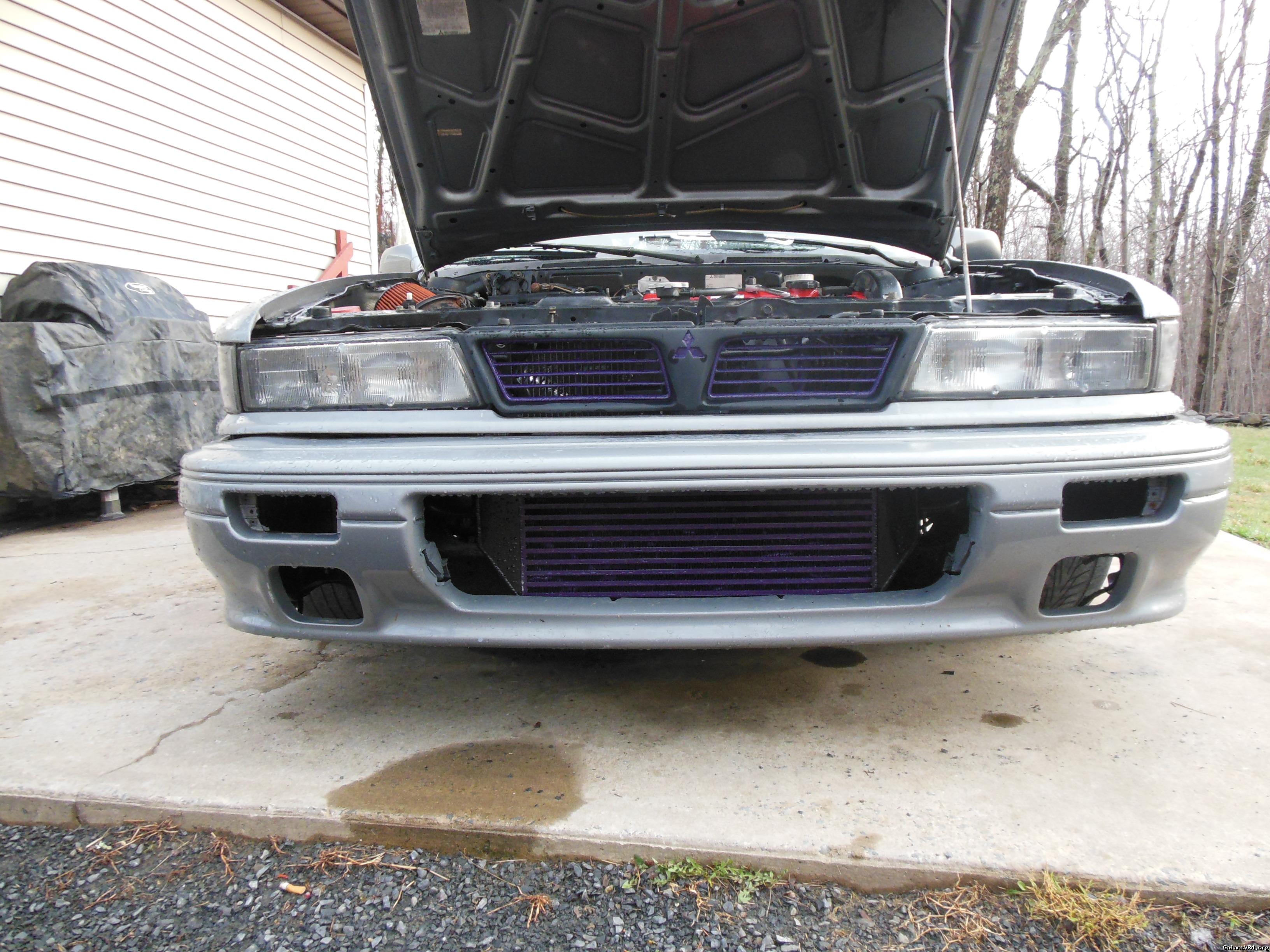

so i just did the timing on it. boy was that bad, the belt was floating on the gears and the cam gears were dead on, but the crank was off by 3 or 4 teeth. put a new belt, pullies and tensioner on it and he runs like Steve Prefontaine now. while i was on that side i saw a torn cv boot so i dug up an old driver side axle and changed that while i was in there. got a new boost gauge and freshly rebuilt 14b turbo and decided to clean up my intercooler piping and paint some of it. i was able to cut 9 inches of extra piping out of my intercooler pipe setup and it looks so much better and fits a lot better now as well. i also re-aligned the intercooler and now it sits straight.

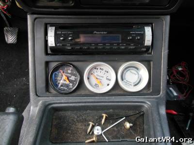

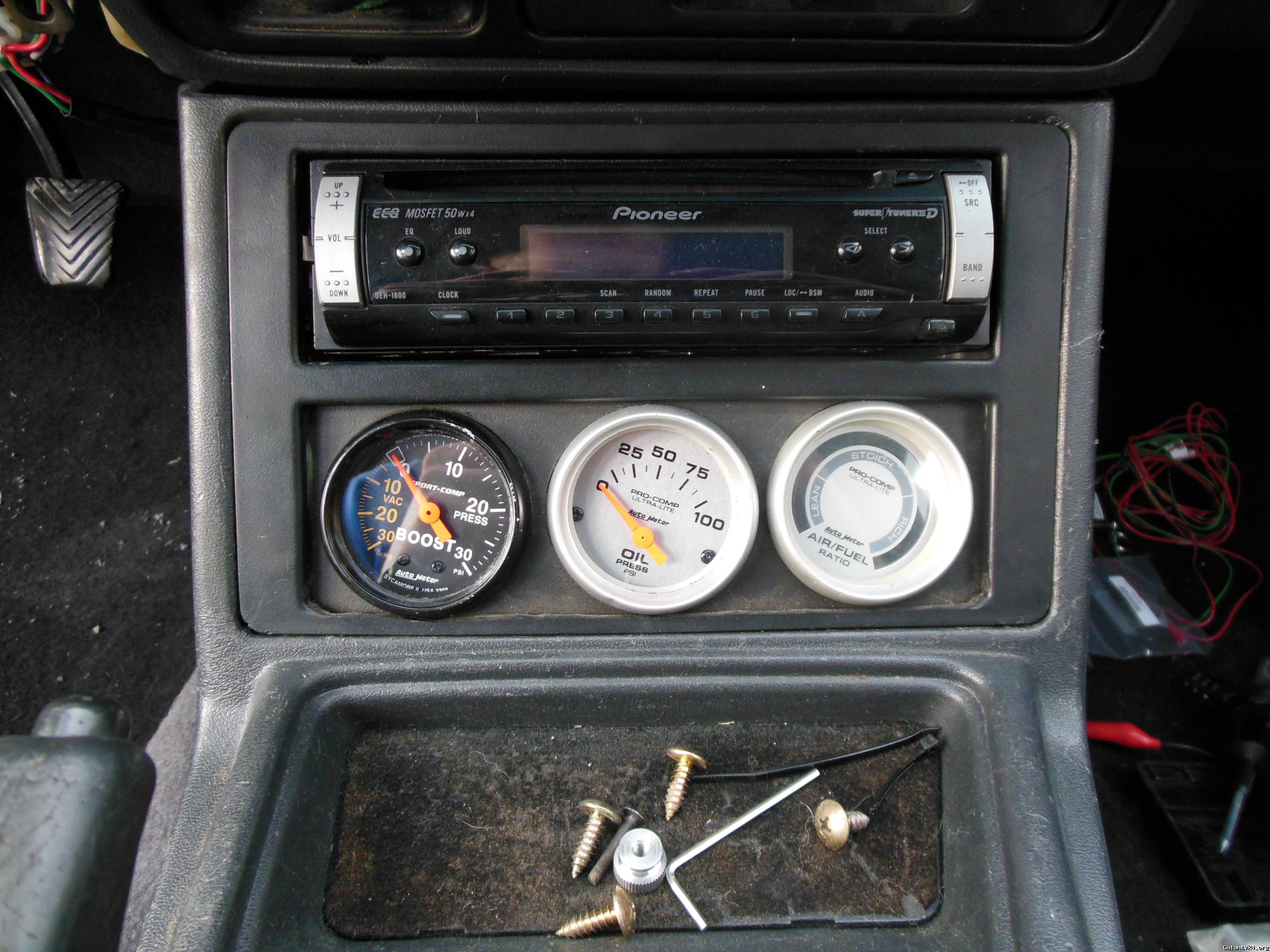

Did you make the 3-gauge pod thing? I tired to buy one with either 1 or 2 holes but couldn't find any. I ended up making one but I'm not 100% happy with it.
Where in the world did you find 9 extra inches to remove??!
transparentdsm
Jul 27, 2011
3,690
Cherry Hill, NJ
the pod was in the car when i bought it, it is a homemade one though. rather simple. its a piece of plastic with 3 holes cut out, then it was glued to the bezel and 3 autometer gauge holders were also glued to the back so they all sit in the same direction and cannot move.
as for the piping, the original piping on the hot side had 4 inches to much piping, the first pipe going back toward the engine was 2 inches to long and almost touching the alternator and then the pipe coming up from there was actually touching the power steering pump and started to bend after the pump, so i cut that down 2 inches. it also allowed for me to angle the pipe different and get better access to the dipstick and alternator. then the cold side piping was 5 inches to long, it was pushing the intercooler out real far. i cut 2 from the bottom and 3 from the top.

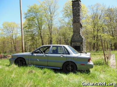

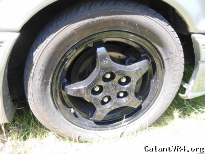

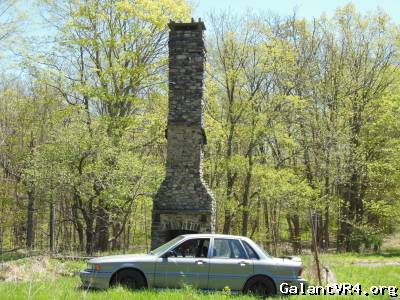

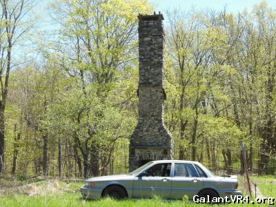

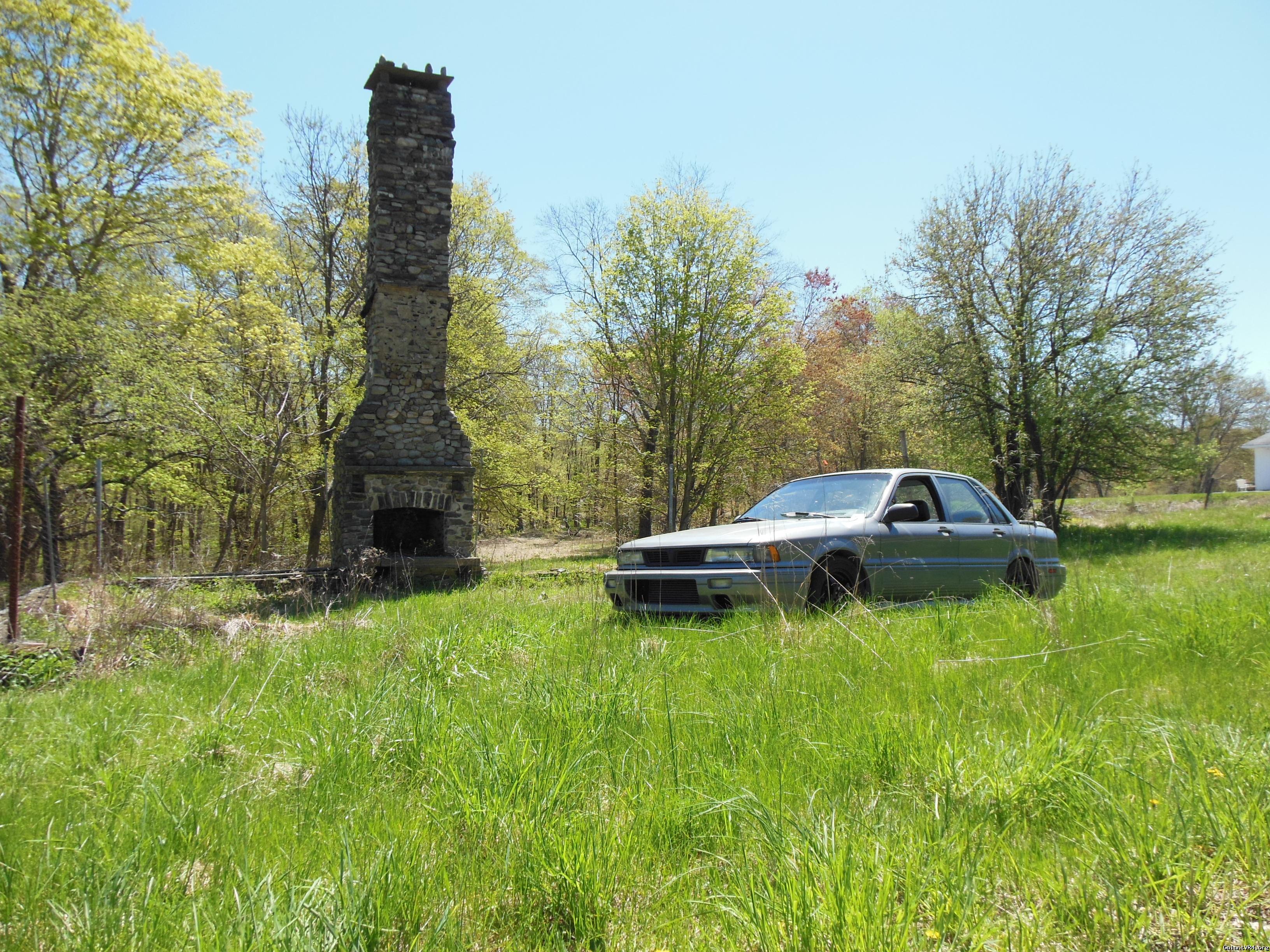

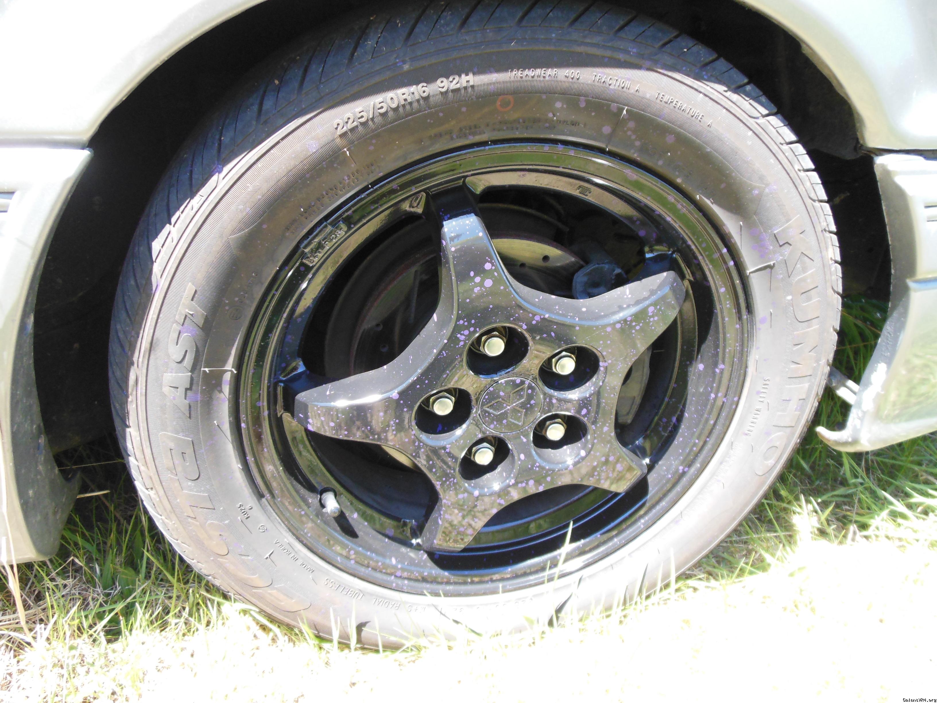

i really am happy with this car. i swapped out the old suspension for a little higher and less stiff riding and while i was doing that i changed out the rims for 5 spoke 2g's. i drove it to the post office today and on the way home i found an awesome structure to take pictures by. so i guess this is 1078's first photo shoot or whatever.
a little family love.. i think this is unbelievable i have 3 VR4's and as of right now all 3 are running and driving and i couldn't be happier!
