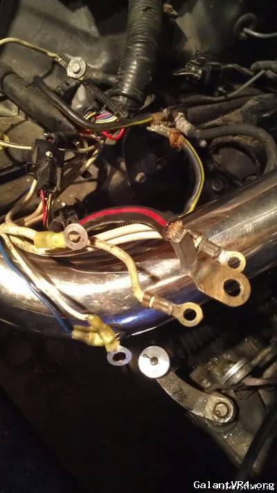

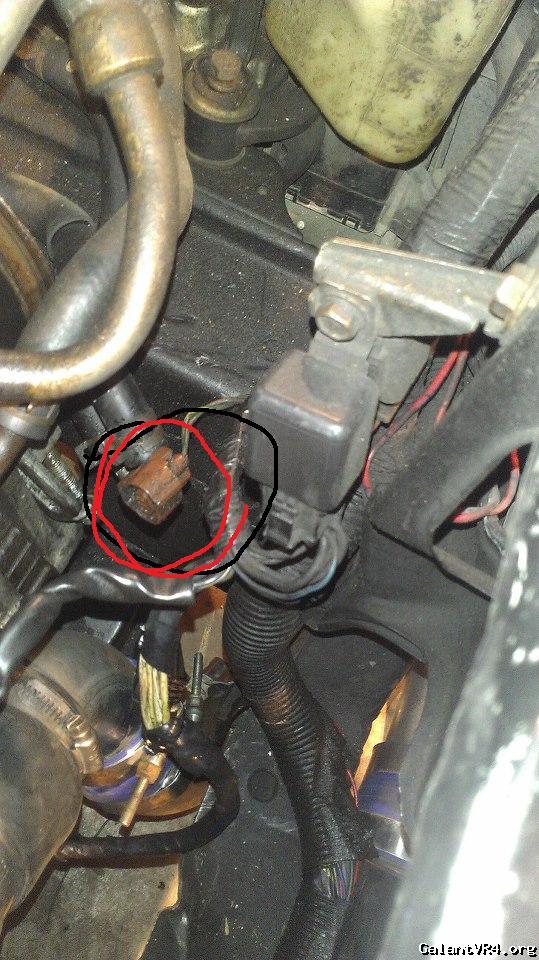

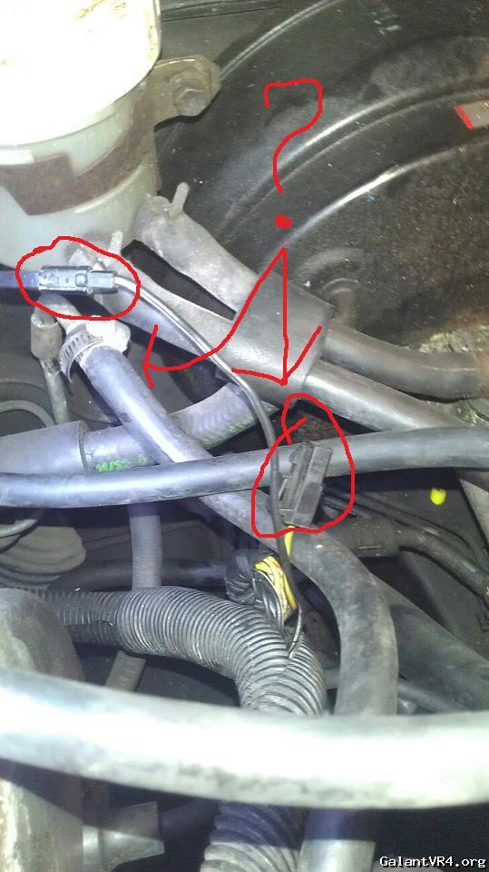

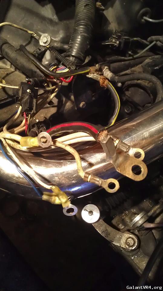

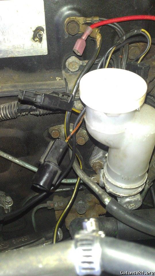

there are just so many plugins cut off this harness and wires that have been extended. I am just trying to figure where everything that is just dangling there plugs in at. And what the cut wires go to.

Take close up and very clear pictures with details on the location of the wires or plugs.
web page
all these are bolted together into a power wire and ran to the trunk to the + on the battery.

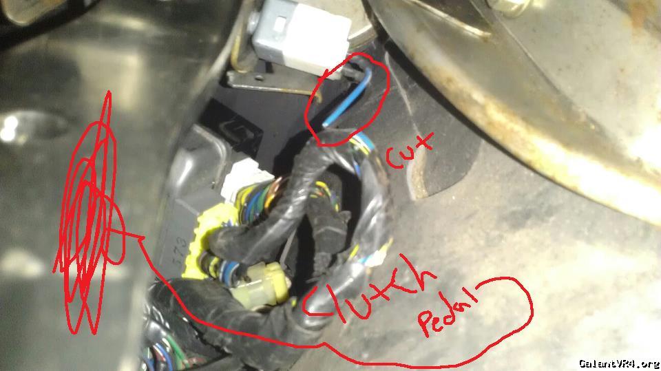

My problem is that my door lights,windows,maplight,heater blower motor,break lights and clock dont work. My power seatbelts work fine and so does my headlights and tail lights. and everything else on the dash. im stumped it was fine and this happened out of nowhere.

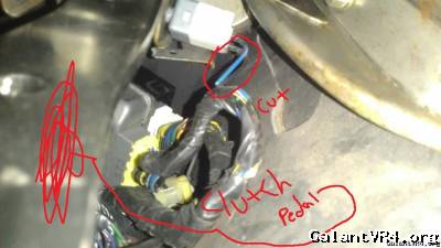

I also understand there's a saftey switch for the clutch to start the car but there's two switches on my clutch pedal.

You should get yourself a galant vr4 manual and start chasing that electrical stuff. There should be one uploaded somewhere on the forum...
If it helps any a round relay under the dash clicks when I take it out and push it back in.
I am going to try a different ETACS because i unplug that and everything is exactly the same.
lowered it down to the 60amp fuse in the engine bay. the fuse is good but im not getting any power to the fuse itself.
sorry to keep posting on here but if anyone else has this problem it was the red/white wire that ran from the 60amp fuse in the engine bay down into the fuse box under the dash
So check the connections under the dash to fix your problem, thanks for the help guys /ubbthreads/images/graemlins/uhh.gif
