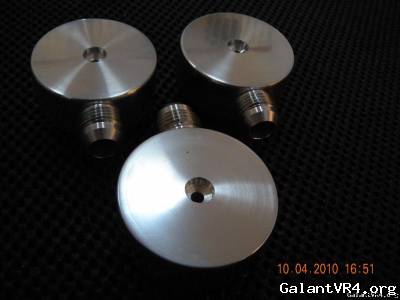

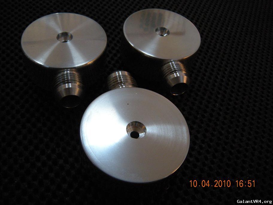

I'm reposting this from the AG Postwhore thread, since at least one person has expressed interest. Hal says these are no secret, just not discussed a whole lot. He was actually interested in where i'd heard of them. I spotted them in some random image somewhere, and tracked down where they came from. I've asked him if i can share his contact information, for those of you not members of the link forum.
I ordered the cap. Hal already had some made up and ready to ship.
If you're on the dsmlink forums, you can look up Hal Landry. He sells them. I do not know how many he has made at the moment, but he will make them as needed, i suppose. You can try emailing him as well.
Quoting Hal:
Billet aluminum oil filler caps
Fits 1g, 2g, and Evo
CNC machined from billet 7075 aluminum and polished to a satin finished.
Each cap has a single -10 male A/N fitting installed in a manner that permits
orientation in 90 degree increments.
$80 shipped (USA only) or $75 local pick up.

Ouch ($), but nice looking.
So, does this replace the nipple used for the PCV (not the valve, but the recirc where you run the catch can from), or does it supplement scavenging?
I do need a new oil cap and now I want to make one on the lathe, damn you! (although not sure about the breather part of it, as far as being effective?)
PS - what is that hole on the top for, the attachment screw to the "arms"?

Ever seen a valvecover with an fittings welded on? Now you don't need em welded in place. I guess one of the benefits would be that to PROPERLY add an fittings to your valvecover you would have to have the baffles removed, the valvecover modified, the baffle replaced, and then the valvecover powdercoated. In my case I just am having the ports welded shut, and running this -10an cap over to a catchcan, and then to the intake pipe.
EDIT>> The hole on the top of the cap is where the screw goes through for the restraint/arms on the underside of the cap. I can take a few pics of mine when I go home if anyone is interested. Just make sure you stake your screw and the nut in place after you install the hardware to prevent it from backing off and falling into your valvecover.

Couldn't you just loosen the "arms", orientate as desired, then tighten? It does seem like it would be a PITA to loosen/remove the oil cap with a line coming off it /ubbthreads/images/graemlins/confused.gif Edit - looking at the pics, seems like a fixed assembly. What would be trick is to make a two-piece cap where the top pops off (with the hose attached) and the bottom unscrews and can be removed...
belize1334
Nov 18, 2003
3,317
Bozeman, MT
I would assume that the under-side of the cap is indexed so that the arms sit securely in place and don't try to rotate.

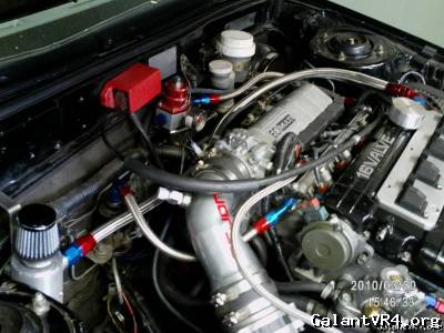

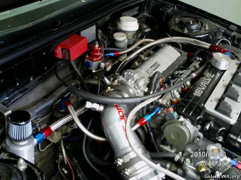

What's up with the installed pic? The nipple on the side is unused but this cap was needed?
mitsuturbo
Jun 2, 2008
3,551
Near Seattle, Washington
^ no, it was not completely put together when the photo was taken.
The owner stated he fully intended to utilize that nipple.
