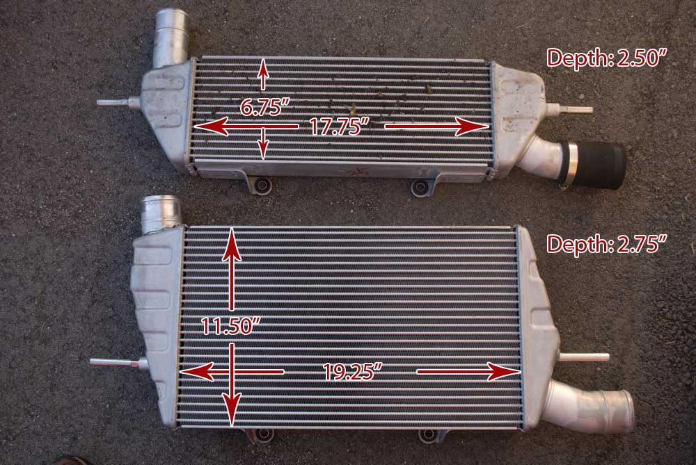

reviving an old thread.
Anyone put an "RA" Lancer Ralliart FMIC on their GVR4 yet??
Ralliart is the top, EVOX is the bottom.
Drew84
Nov 16, 2010
240
Peabody, Ma
I was thinking about using one of these when I was building my car. If you flipped these around they would line up pretty well with the factory pipes I think.
