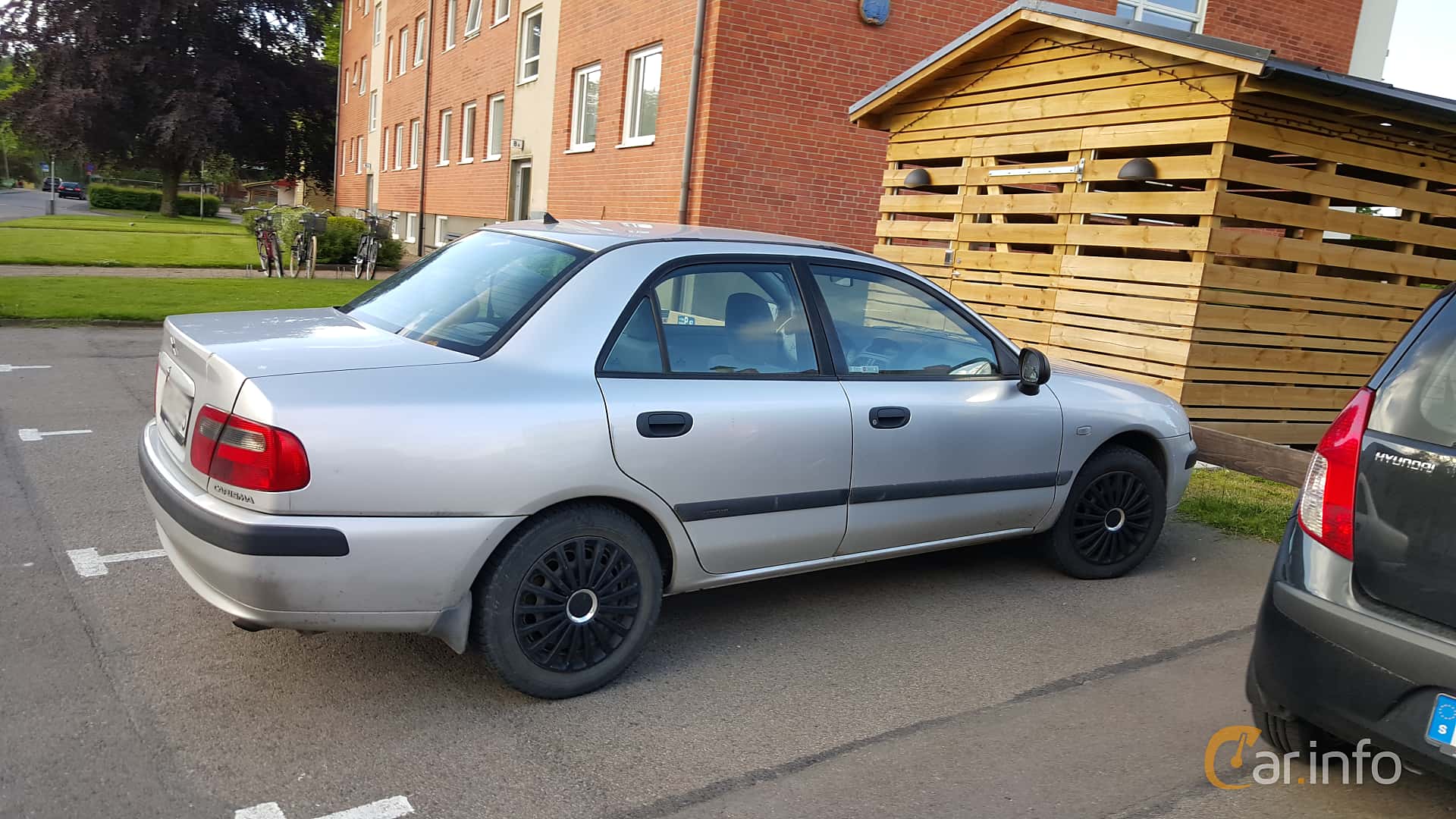

The S40/V40 rims are a perfect fit because they are made for Mitsubishi hubs to begin with. The 1st gen S40/V40 is a Mitsubishi Carisma (European version of the Lancer/Mirage) under the skin.

To be honest the Carisma was a big flop. Why they named something with dreary looks and boring performance a 'Carisma', I will never know.

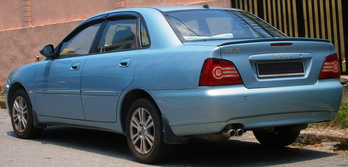

The Carisma went on to form the basis of the Proton Waja where one model was even sold with the FTO's 6A12 DOHC V6 engine.

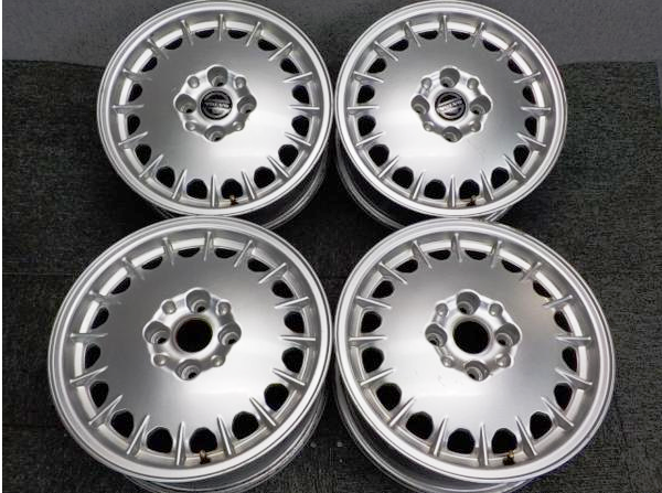

Does anyone know what volvo these are from? They look very rally spec. I have them for sale.

Are they 4x114.3mm PCD? If so will be a lesser model first gen S40/V40. I think the only other 4 lug Volvos were the 300 / 400 / 480 series which I didn't think made it to the US? They are 4x100mm PCD anyway.

Yes 4 x 114.3. I can't figure out what model they are from. 16" i think.
