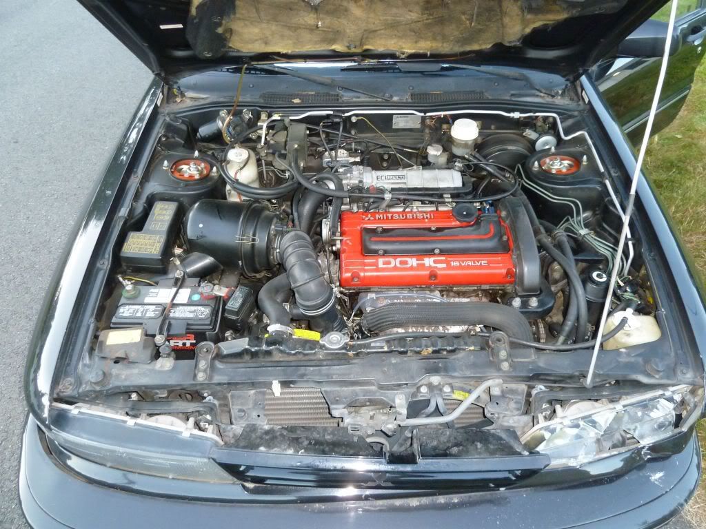

I neglected to update this thread when she first started running, but I will do so now that she's been running well for a few weeks.
Here's what she looks like sitting all clean and happy out front.
Things weren't exactly as they should be when I got it first started. It took a couple tries to get the knock sensor in there, but it turns out the code I was getting was for that and not the CAS (duh!). I was taking her for a bit of a long trip a couple days ago and while cruising down the highway something made a HUGE clunk and hit the bottom of the car (i felt it in my butt) and so I pull over thinking the driveshaft has exploded. I couldn't see anything so I very cautiously drove home and got her up in the air to find out what went wrong. The only thing I could see was a missing exhaust hanger bolt. I guess I missed screwing one of them in and it must have bounced off the road and a U joint.
So, I just got a job so I'll have spending money and time on the weekends to throw a little more money into the car. So I expect this thread to be a little more consistent than in the past. Maybe it will get moved into the general discussion section too (wink moderators wink).
Edit: I forgot to give you guys the price break down. I cut as many corners as I felt was allowable to save money, but it still was about a grand for the whole thing.

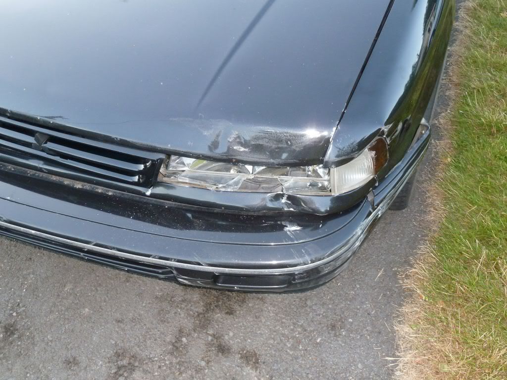

Well, a couple days ago the galant saw the broad side of another vehicle. Damage doesn't look too bad, there are no leaks, and it still drives ok. I'll probably be looking around for all the parts needing replacement and from what I can see I'll be needing to get the following bits and pieces:
Hood
Fender
Headlight
Bumper
Bumper support
Foglight
Pics:
Bummer, but everyone was ok and I think its all body damage, nothing that can't be fixed.
