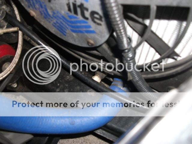

All good info thanks ! Still need some more though . Here is a pic of my setup . You can see the plug for the fan has 6 wires I think and only two that comes out that go to the fan ( slim fan ) The only thing I can think of is that on a stock plug splits off into two different harnesses and thats why all the extra wires are not in use . What I need to know is the color of the wires that go to the thermo switch . Thanks
Pic of the thermo switch I'm referring to
