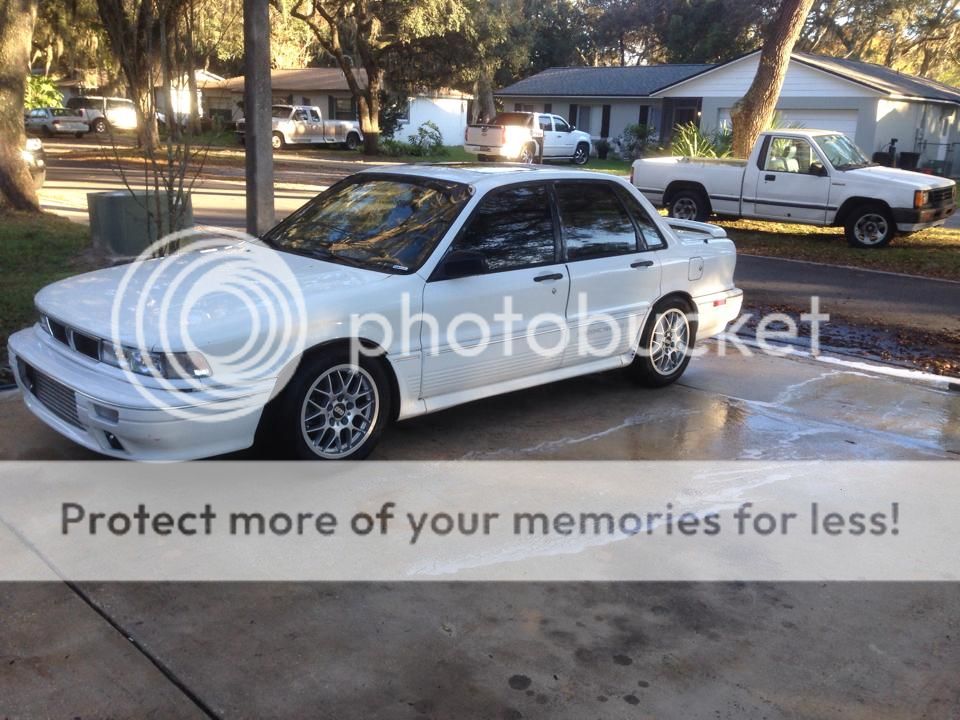

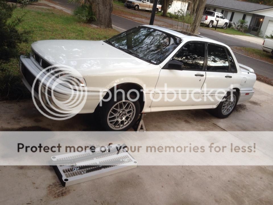

Replaced slicks with new KDW BFG Tires and lowered a bit

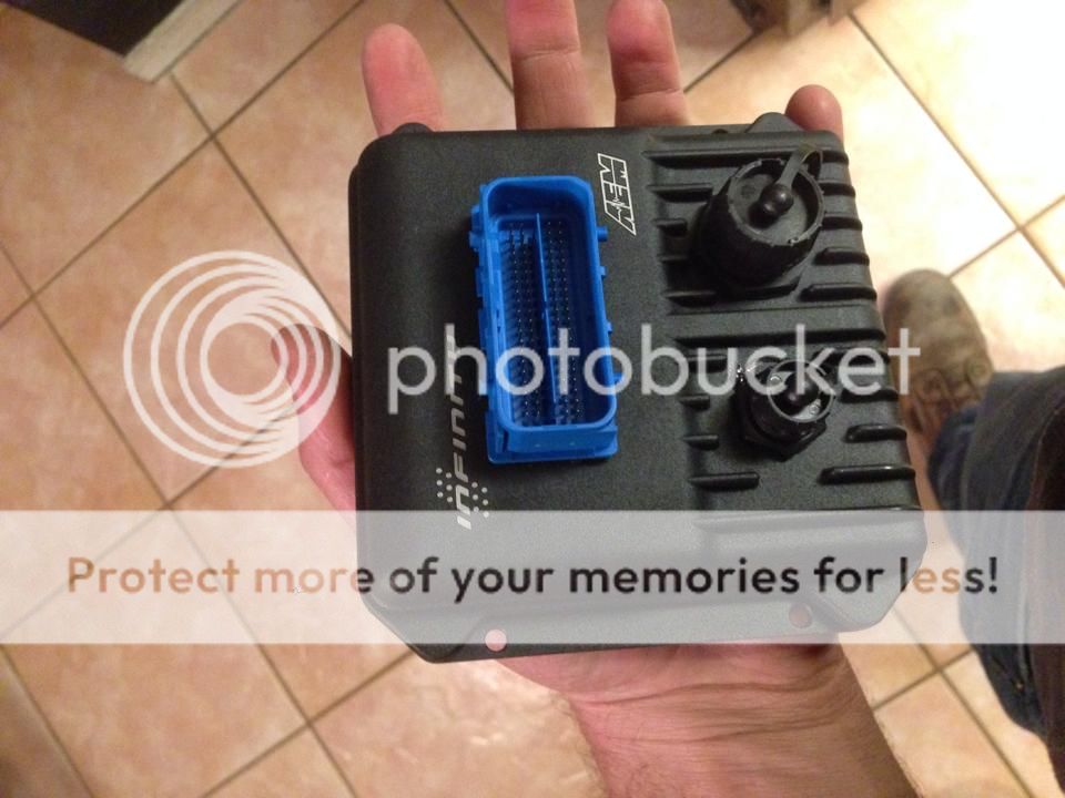

The Series 1 ECU (AEM) that came with the car finally took a dump and decided to replace it with the Infinity 6. Haven't been able to find another DSM or Galant with one. Should be quite an experience, received in the mail yesterday. Just waiting on the jumper harness and CAS disc.

/ubbthreads/images/graemlins/smirk.gif There are two sets of tires imaged. Sitting on a set of MT 255/50/16 radials in the first two pics and the rest are BFG 225/50ZR-16 g-Force T/A KDW. The BFGs were discontinued, from what the rep said I bought the last set back in 2010 for 79 each. The car has been sitting for a while with an occasional joy-ride and they have not dry rotted at all. I don't have the wheel specs right on hand but will when I get the chance. When I had the MTs the suspension was raised up all the way and would still gouge the slicks launching and going over bumps.
