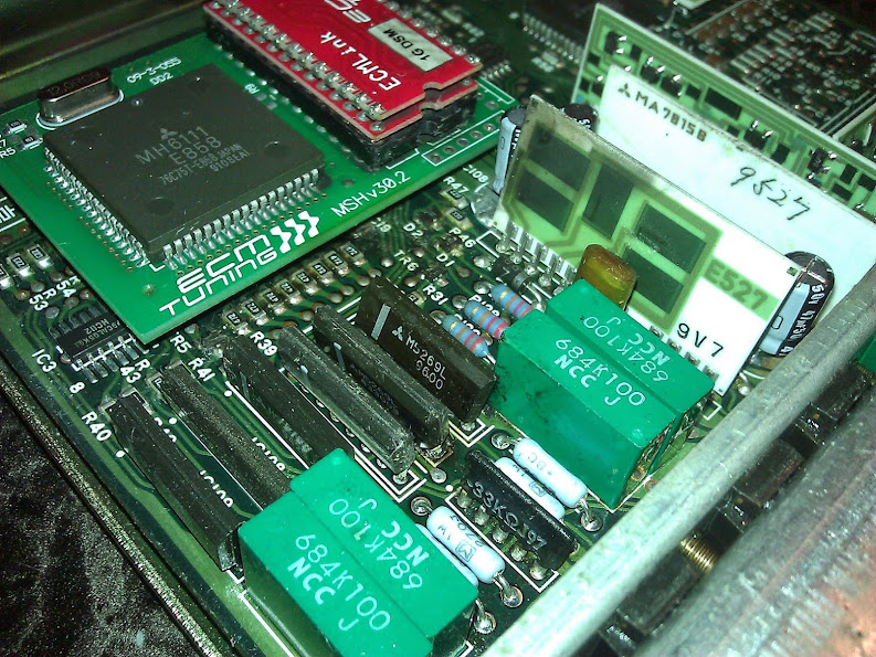

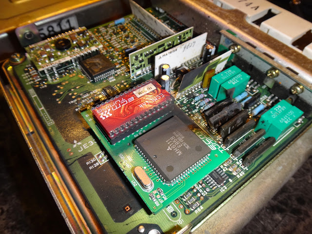

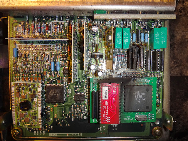

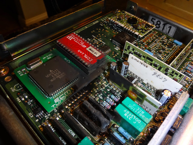

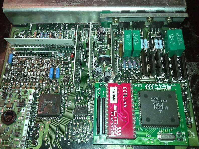

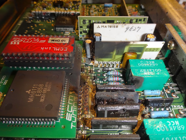

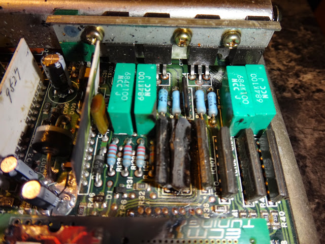

I pull the ECU just to see what I can see. I smell the case before opening it up and immediately know something's up. I pop off the cover and here's what I found:
Now, my question is, why? I've recently swapped in a revised (black) ISC, and have been running it for a few hundred miles now, so I don't think that's it.

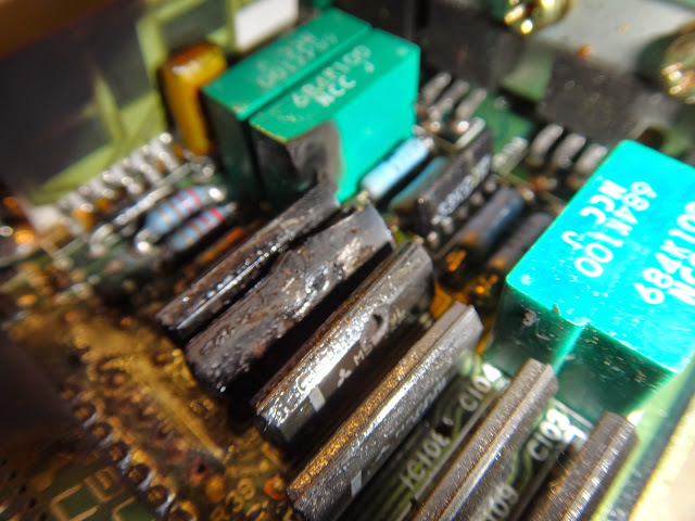

Anyway, it looks like IC105 is blown. According to this link: click, the ISC is to blame. I'm pissed, because the tan ISC that was in the car was working perfectly. Ironically, the only reason I swapped it out with a black revised ISC was to avoid blowing up ISC drivers, as it's rumored the revised ISCs are far less likely to cause such a failure. Well, guess that's what I get for being proactive. I'll test the ISC tomorrow to confirm it's bad, but suffice it to say something bad happened and completely fried the ISC driver.

IC104 controls ECU pin 14 ('90) or 6 ('91+), MAF Reset signal. The other half of the chip is unused on US DSMs.
IC105 controls ECU pins 67 and 68, Idle Speed Control (ISC) Servo (coil pair B).
IC106 controls ECU pin 57, Fuel Pressure Solenoid (FPS), and ECU pin 105, Boost Control Solenoid (BCS).
IC107 controls ECU pins 58 and 59, ISC Servo (coil pair A).
IC108 controls ECU pin 53, EGR Solenoid, and ECU pin 62, Evap Purge Solenoid.
IC109 controls ECU pin 56, Fuel Pump Relay, and ECU pin 65 Air Conditioner Compressor Clutch Relay.

I finally got around to pulling the ISC today, and it looks like I found my issue. Resistance on ISC coil pair B between pins 5 and 6 was 0.6 Ohms, which caused ECU driver IC105 to get fried.
I'd like to explain a little bit about how to correlate which ECU driver is responsible for running which ISC coil. I had to cross reference a wiring schematic because this is not clearly spelled out in any one place, so hopefully this saves someone the trouble in the future.
The ISC has 2 coils. They are referred to as coil pair A, and coil pair B.
Coil Pair A
-When looking into the ISC, coil pair A is pins 1, 2 and 3.
-ISC Pin 2 is ground for coil pair A
-ISC Pin 1 is a coil and goes to ECU pin 58
-ISC Pin 3 is a coil and goes to ECU pin 59
-IC107 is the ECU driver that will blow if coil pair A is bad.
Coil Pair B
-When looking into the ISC, coil pair B is pins 4, 5 and 6.
-ISC Pin 5 is ground for coil pair A
-ISC Pin 4 is a coil and goes to ECU pin 68
-ISC Pin 6 is a coil and goes to ECU pin 67
-IC105 is the ECU driver that will blow if coil pair B is bad.
