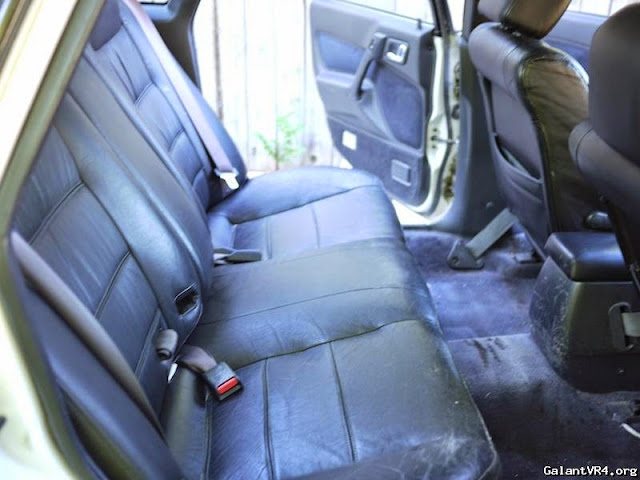

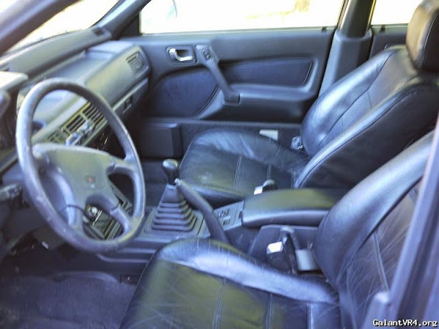

Here's 1837 looking all bare bones (August, 2011)
