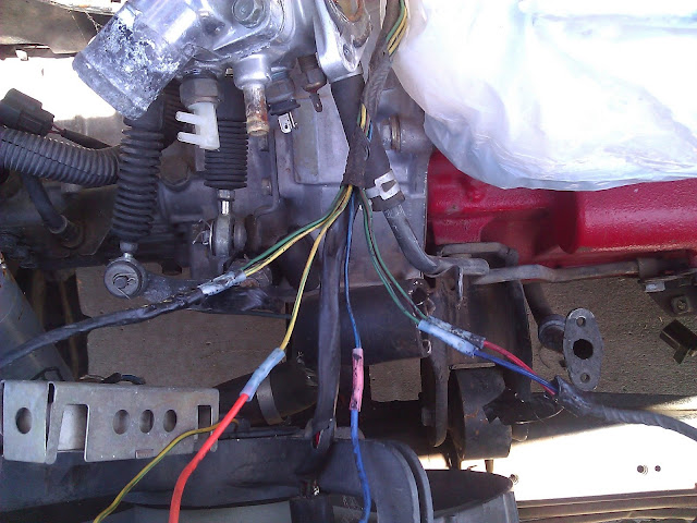

I'm attempting to repair my hacked up wiring harness since the previous owner thought it would be a good idea to convert all the factory connectors to spade connectors. I'm in the process of connecting the factory connectors back to the harness but I'm having trouble identifying a few wires.
I'm working with the harness that contains the temp sensor connectors, and the O2 sensor plug. There are 6 wires total. I think I have identified all but the Blue wire with the black tracer. I don't know what this goes to, and I can't find it in any wiring diagrams. Can someone take a peak at their car and tell me what this wire goes to? When looking at the photo, just pay attention to everything before the crimp connectors (the actual factory wiring). I'm getting rid of the crimp connectors and soldering the factory plugs back in, so pay no attention to the wire colors after the crimp connector. The wire in question again is the blue wire with the black tracer, the 4th wire from the left as seen in the photo. If someone could shoot a pic of ALL the wires and what they go to that would help A LOT. Thanks in advancefor any help!

Should be a single pin sender on the rear of a factory vr4 t-stat lower housing.
The orphan wire in question goes there.

I *believe* it's an additional/redundant safety for the a/c system.
If I remember correctly, grounding it will kick off the a/c compressor and turn on both fans.

Here's the deal. I have 6 wires total.
2 Green w/ black tracer
2 Yellow w/ green tracer
1 Blue w/ black tracer
1 Green w/ red tracer
The only one I have definitely identified is the Blue w/ black tracer. Can someone give me a sure answer on the other 5? Also are the 2 sets of identical colored wires interchangeable (meaning the 2 Green w/ black tracer and the 2 Yellow w/ green tracer)? As it was hooked up by the last guy, the 1 Green w/ red tracer is going to the Coolant temp sender to the ECU. According to the diagram here (look at page 148) click, that is wrong, and it should not be hooked up there. Problem is, I can't find the 1 Green w/ red tracer anywhere in the schematic. Can someone take a look at their car and let me know what color wire goes where so I know indefinitely and don't have to redo this again? I wish I had another Galant to look at, as my 90 GST is totally different.

This is what you need:
Single pin front (connector B01): Coolant temp gauge unit: Yellow/green tracer
T-pin front: Coolant temp sensor (connector B02): Green/black (crossbar of T) and yellow/green (stem of T position)
Single pin rear: Coolant temp for A/c (connector B-22-4): Blue/black
Two pin on top of housing: Temp for a/c cutout (connector B-22): Green/red (from wire side, round side up it is the right wire) and green/black
As noted, the green/red wire is for connector B22. That is shown on page 150 of the file you linked. The green/black should go to the ECU, and the green/red to the pressure switch and control unit.

I think you may be ok with the duplicate wires as they appear to be grouped in your photo ('though I can't see the tracer colors in the photo...). On the right of your picture of the wires are two green together. Likely they go together for the B-22. Similarly on the left, with the yellow and green wires together. You could of course verify them with the ohmmeter.
