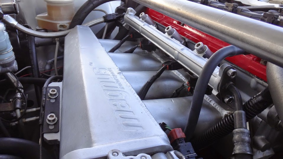

• Magnus V3 cast intake manifold

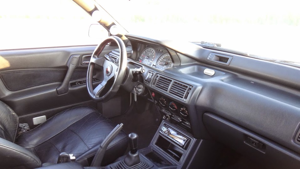

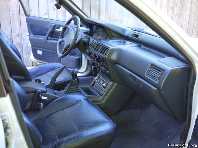

Interior:
• Recaro SRD seats
• Sabelt 3-point safety harnesses
• Personal steering wheel and shift knob combo
• Custom Galant VR-4 horn button by André Phan
• 89' under dash
• OEM metal brake and clutch pedal covers
• Kicker DS series speakers (4", 5.25", 6.5")
• Kicker CompR sub woofer (43CWR102 dual-voice-coil)
• Alpine MRD-M1001 amplifier w/ remote bass control (RUX-4180)
• Rockford Fosgate 1 farad - 20 volt surge capacitor (CPC10-03)
• Alpine CDA-7894 deck
• Ecliptec Shift-P2
• Greddy 52mm boost & EGT gauges
• Greddy 60mm water temp gauge
• Intellitronix digital oil pressure gauge
• Paulo fiberglass dual gauge pod

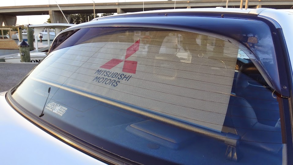

• OEM Mitsubishi rear sunshade
• Custom floor mats

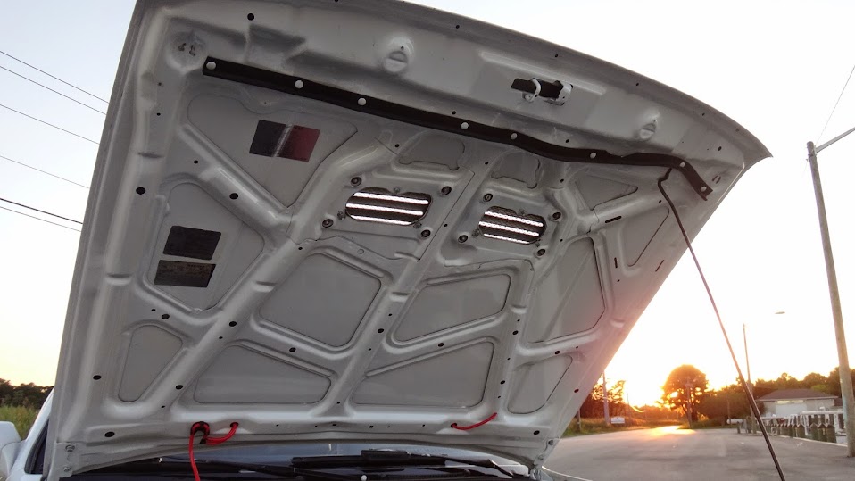

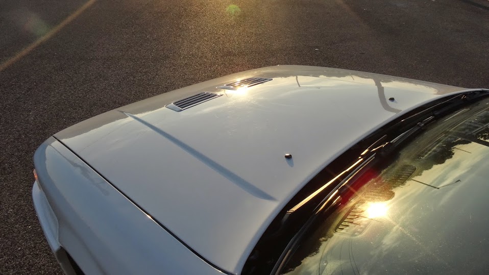

• JDM RS hood

• JDM door & rear window visors

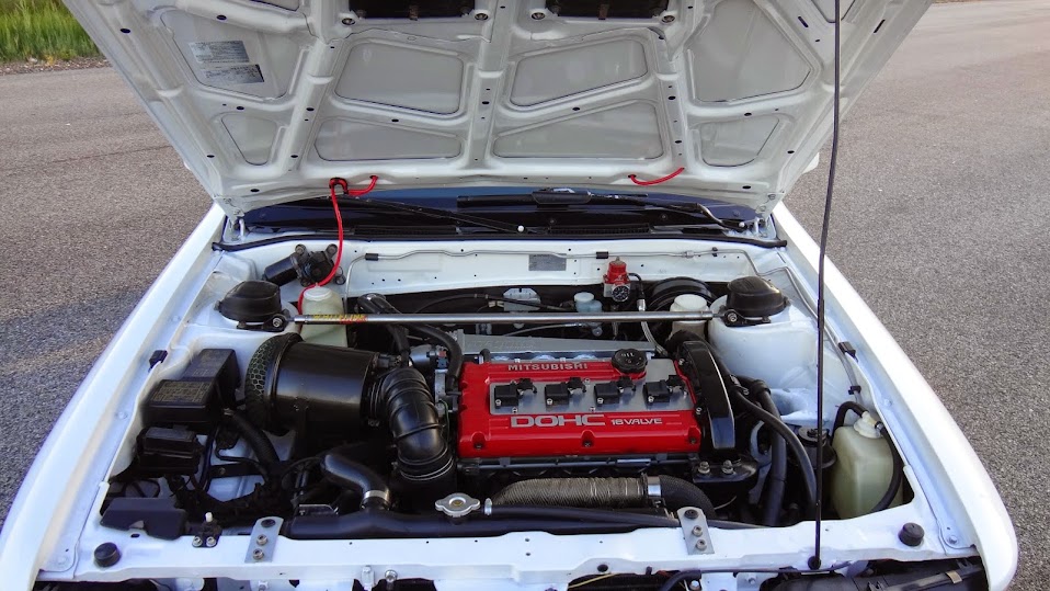

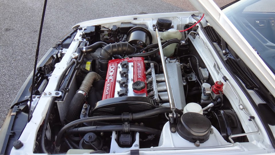

Motor:
• 6 bolt block .020" over
• Stock uncut crankshaft
• King XP tri-metal racing series main & rod bearing set
• Eagle H-beam rods sized for a 22mm wrist pin
• Ross 2G 85.5mm 8.3:1 forged aluminum pistons
• ARP main studs/bolts
• 2G oil pickup tube
• 1G cylinder head (Oil port mod, Manley valve springs, titanium retainers, 3G revised lifters)
• ARP head studs/bolts
• HKS cams (264 intake / 272 exhaust)
• Fidanza adjustable cam gears
• ARP cam gear bolts
• Fluidampr engine damper
• ARP engine damper bolts
• Fel-Pro composite head gasket (9627PT)
• All new engine gaskets (FelPro)
• New water pump and timing components (Gates)
• Gates accessory belts
• Gates timing belt
• OEM Mitsubishi hydraulic tensioner
• HKS clear upper timing belt cover
• New oil pump with straight cut gears & OEM BSE kit
• -8AN B&M oil cooler setup (11'' x 5-3/4'' x 1-1/2'')
• -10 AN shaved valve cover
• -10 AN 3 port sealed/baffled catch can
• Custom billet aluminum Galant VR-4 oil cap by Jason Everts (RIP)

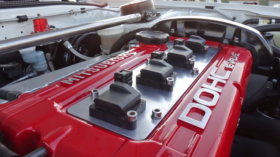

• Coil on plug ignition w/ JMF coil plate

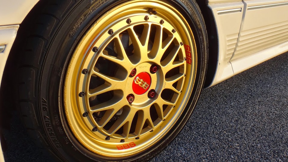

• Work Meister S1R Wheels:
--- 4x114
--- 17x7 & 17x8
--- Offset 30
• Federal RS-RR tires 255/40 R17
• Ichiba V1 hubcentric spacers (10mm front, 12mm rear)
• Aluminum hub centric Rings * OD 73.1 mm * ID 67.1 mm
• Extended lug studs
• Project Kics Leggdura 2 piece lug nuts

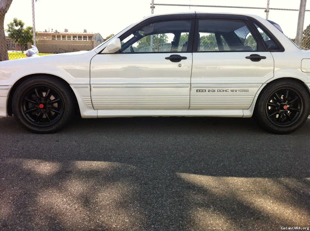

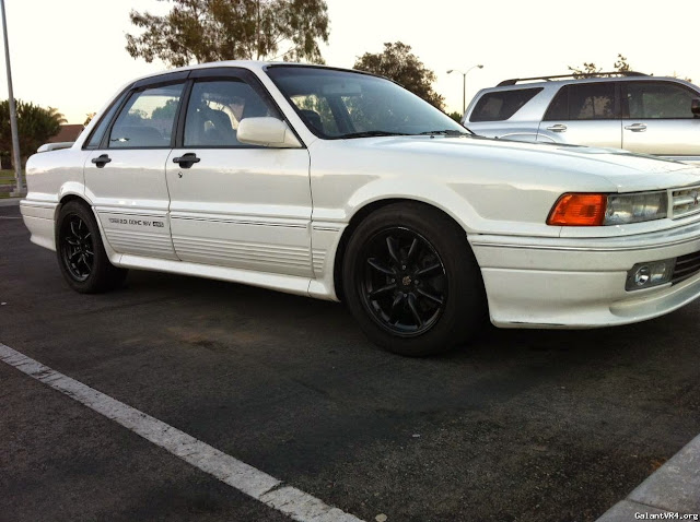

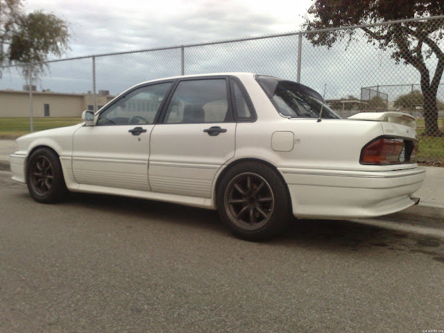

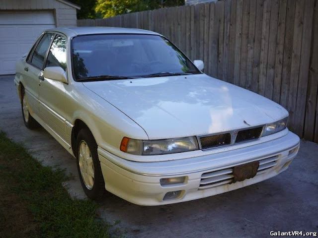

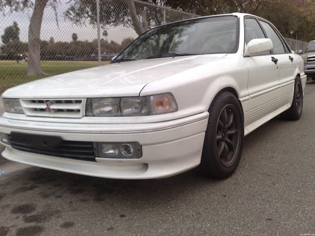

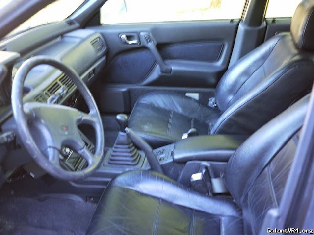

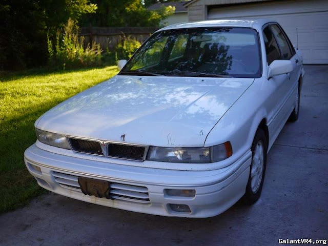

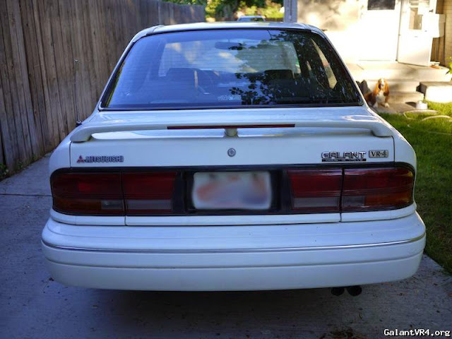

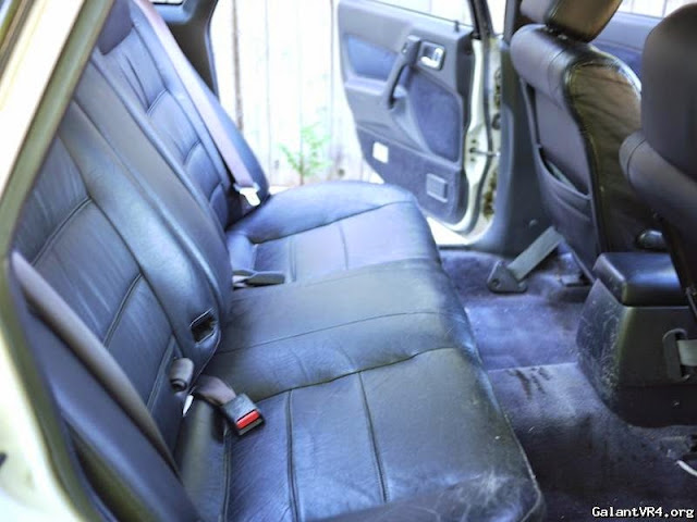

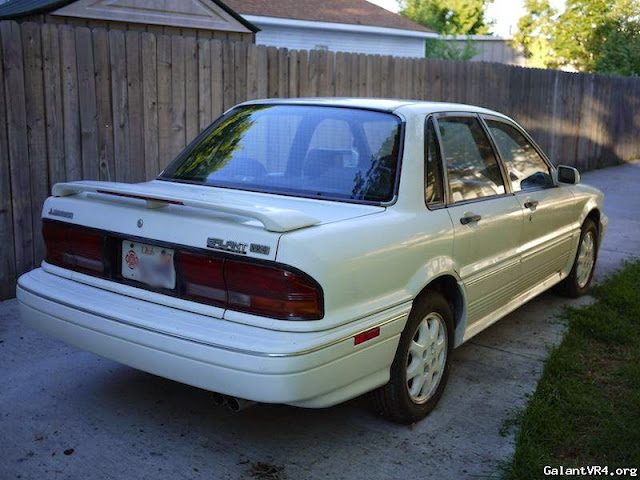

Here's 1837 looking all bare bones (August, 2011)

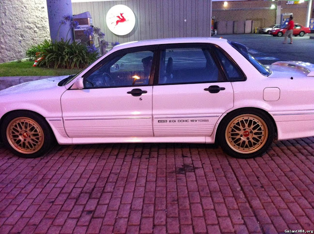

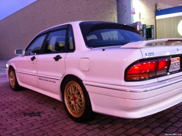

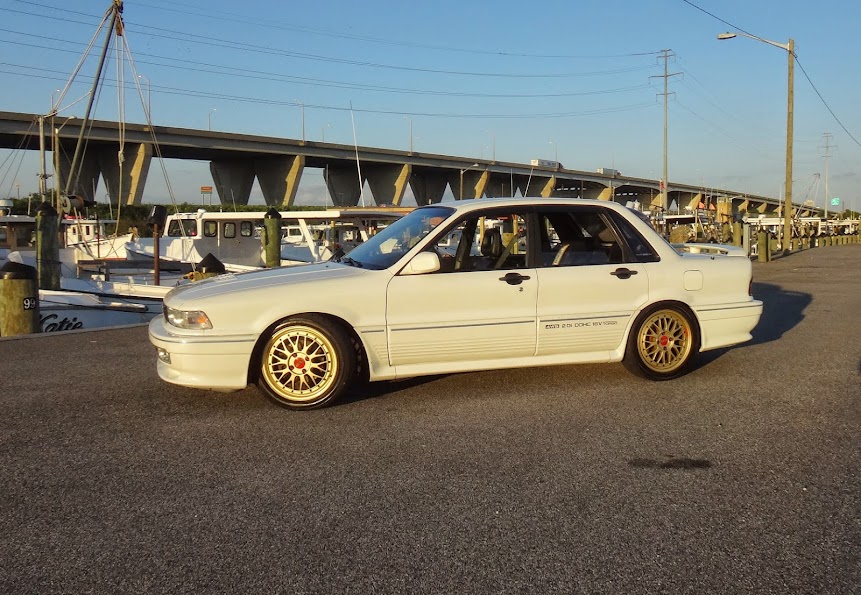

1837 after its first makeover by oldman tau (~December, 2011)

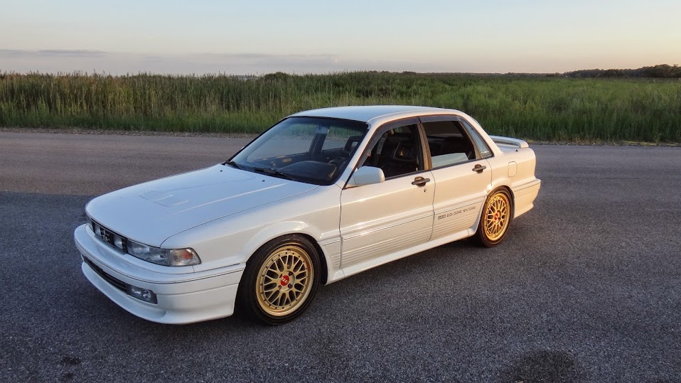

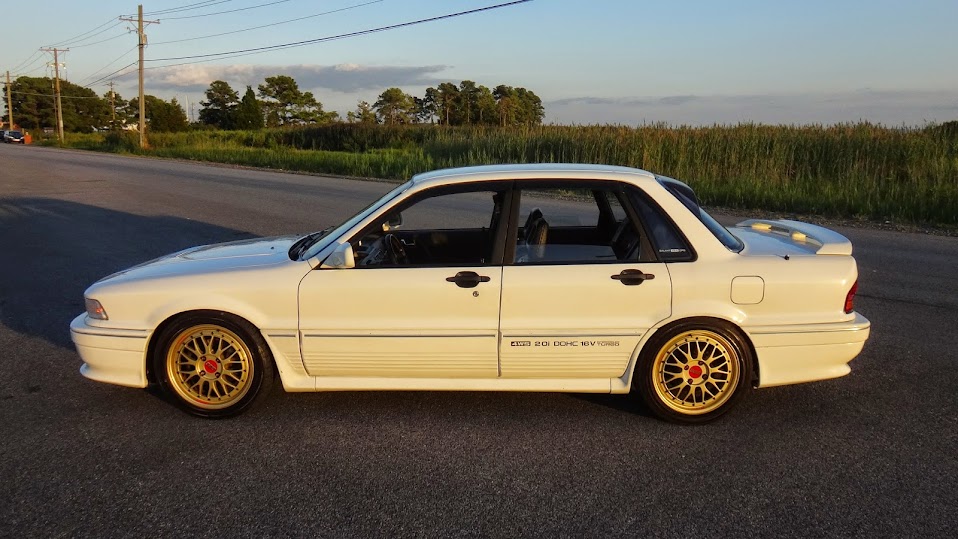

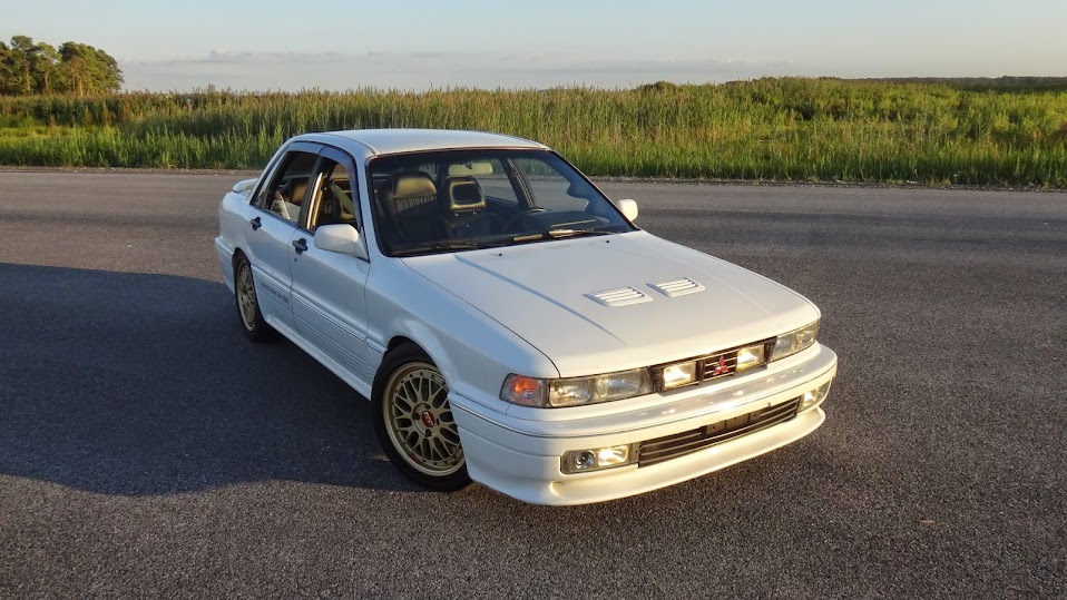

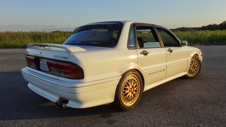

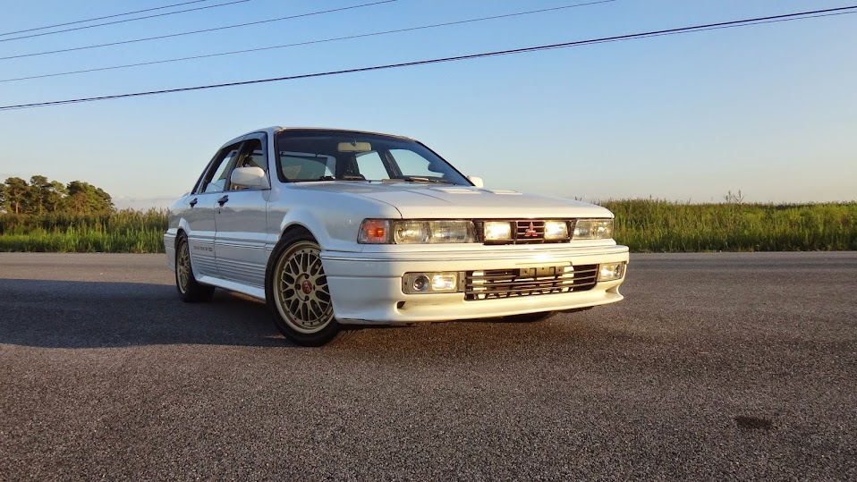

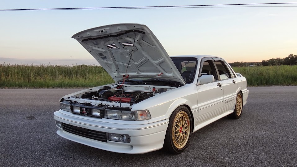

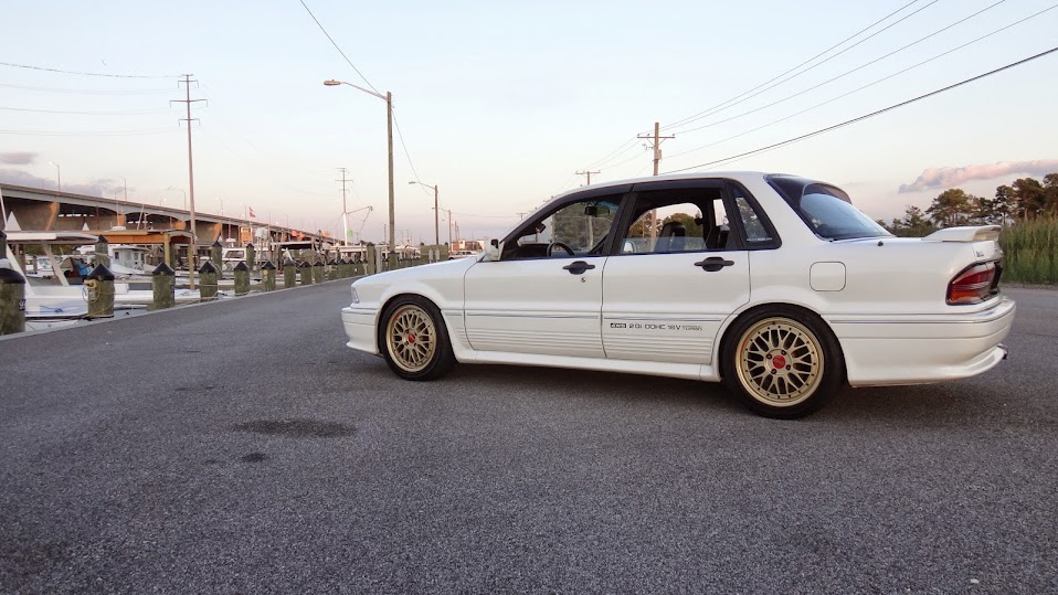

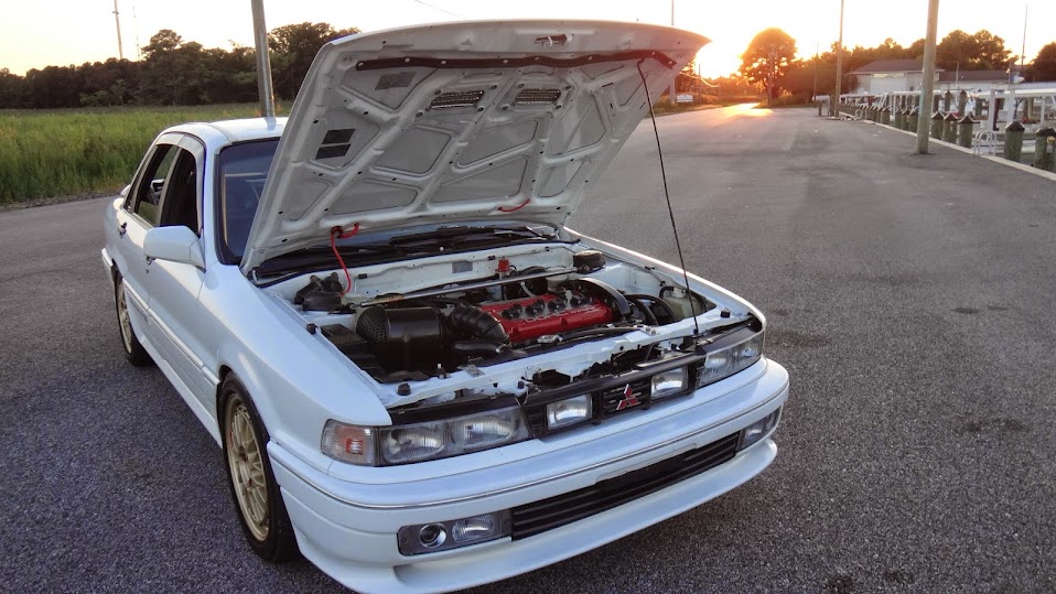

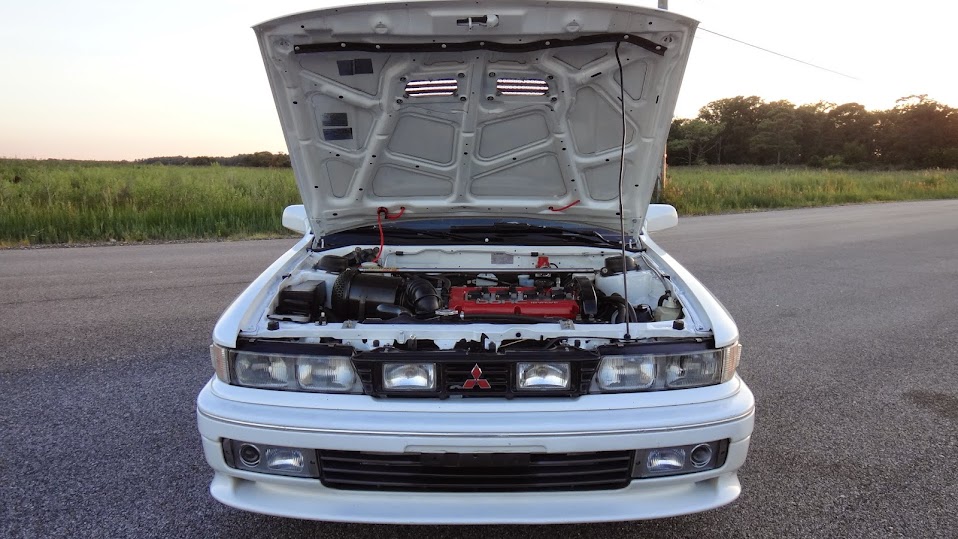

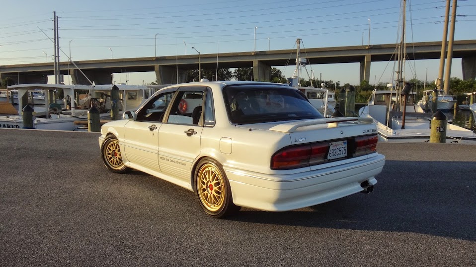

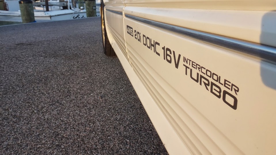

And here's 1837 since I've had it (July, 2014)
