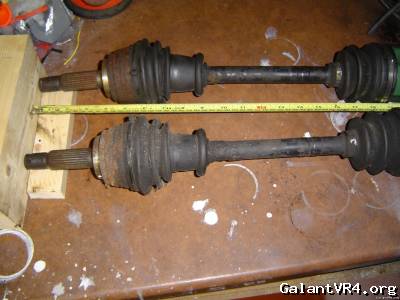

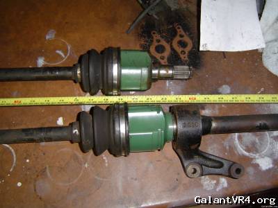

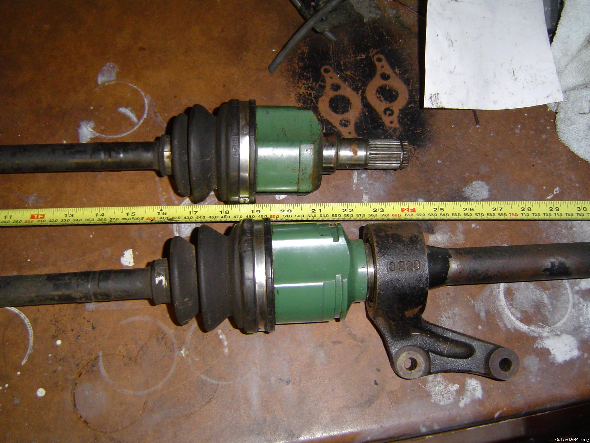

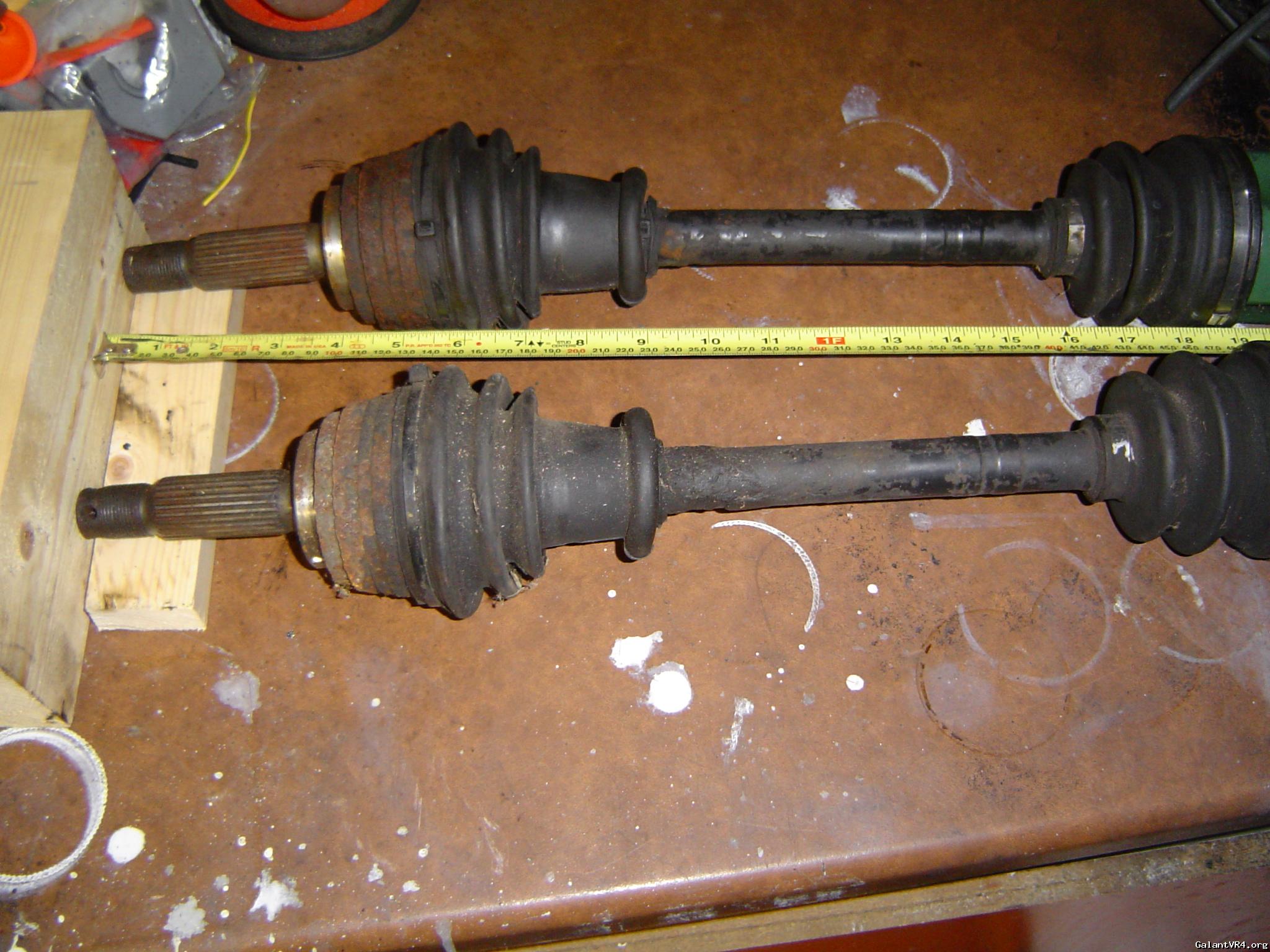

Right here's my spare set of shafts.
Before asking i'll not break into them, as got my hands full at the mo but this should give you a good view to atlease check what you've got.
Hope this helps!
Rich
Sweet as, thanks for that. Gives me a bit more of an idea of what I can tick off my not the problem check list /ubbthreads/images/graemlins/confused.gif
