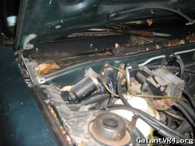

I haven't taken mine apart yet to see exactly what I need, but my passenger side wiper drive is real lose. I need the nub that sticks up to outside the car and whatever is attached to it underneath the cowl. I'll buy the whole mechanism if you have it. I don't need the motor though, but will take it in a package.

Crap, I haven't looked. Is the passenger side the primary drive and the driver side use linkage?

Good thing you said something, I just did a parts search /ubbthreads/images/graemlins/idea.gif You are correct the motor is on the passenger side, and there is linkage that drives both wipers.

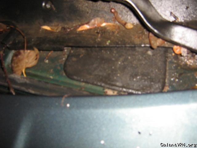

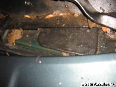

Now, there is a small access panel on the drivers side right next to the wiper arm
Through there you can see the end of the linkage

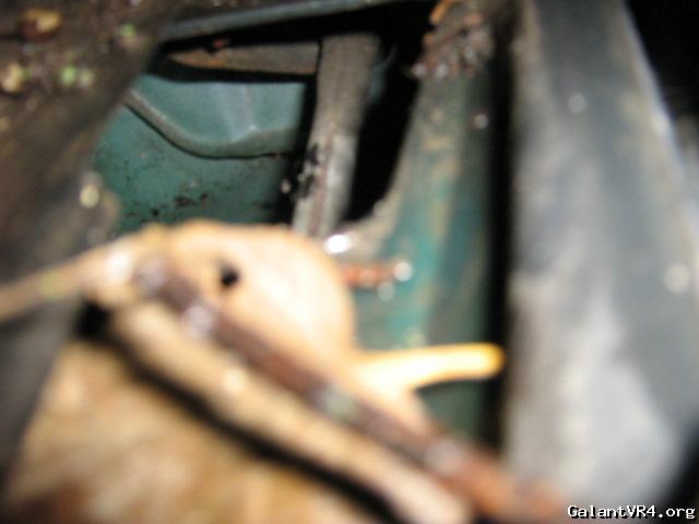

finally had a minute to take it out. It's the drive for the passenger side wiper. popes out pretty easy from the 3 bolts holding it to the cowl and the rod driving it from the motor, and the rod going over to the driver side version of this.

alright so thats the piece you need, what part am i checking on it to see if its not broken like yours?

The top picture you can see how it wore away completely through itself.
I THINK I caused this, I moved my wipers so they parked really low and they slightly tapped the hood, and kinda clunked when set on high. I think it caused that damage over 12 years. haha
I doubt yours are damaged.
