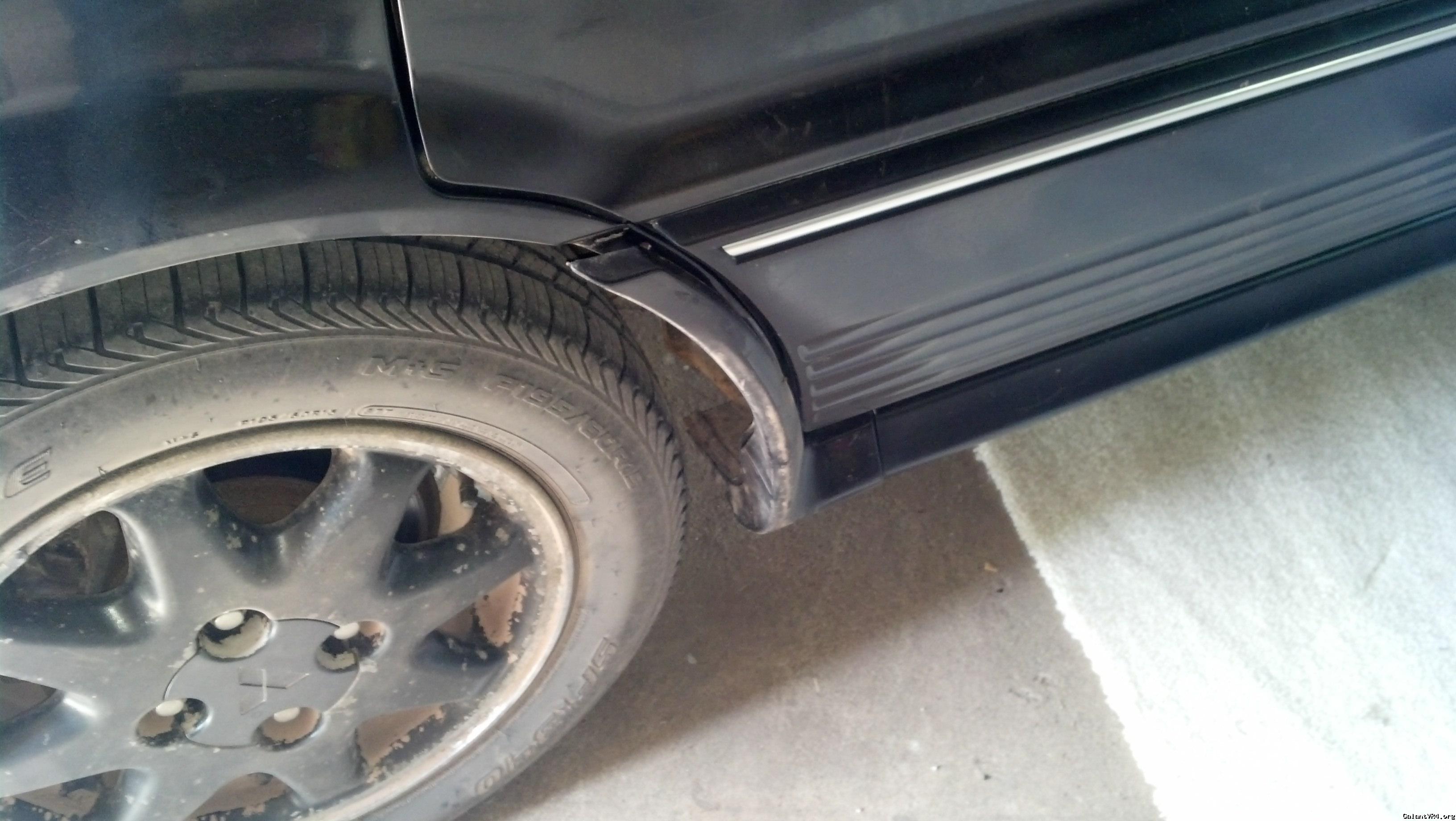

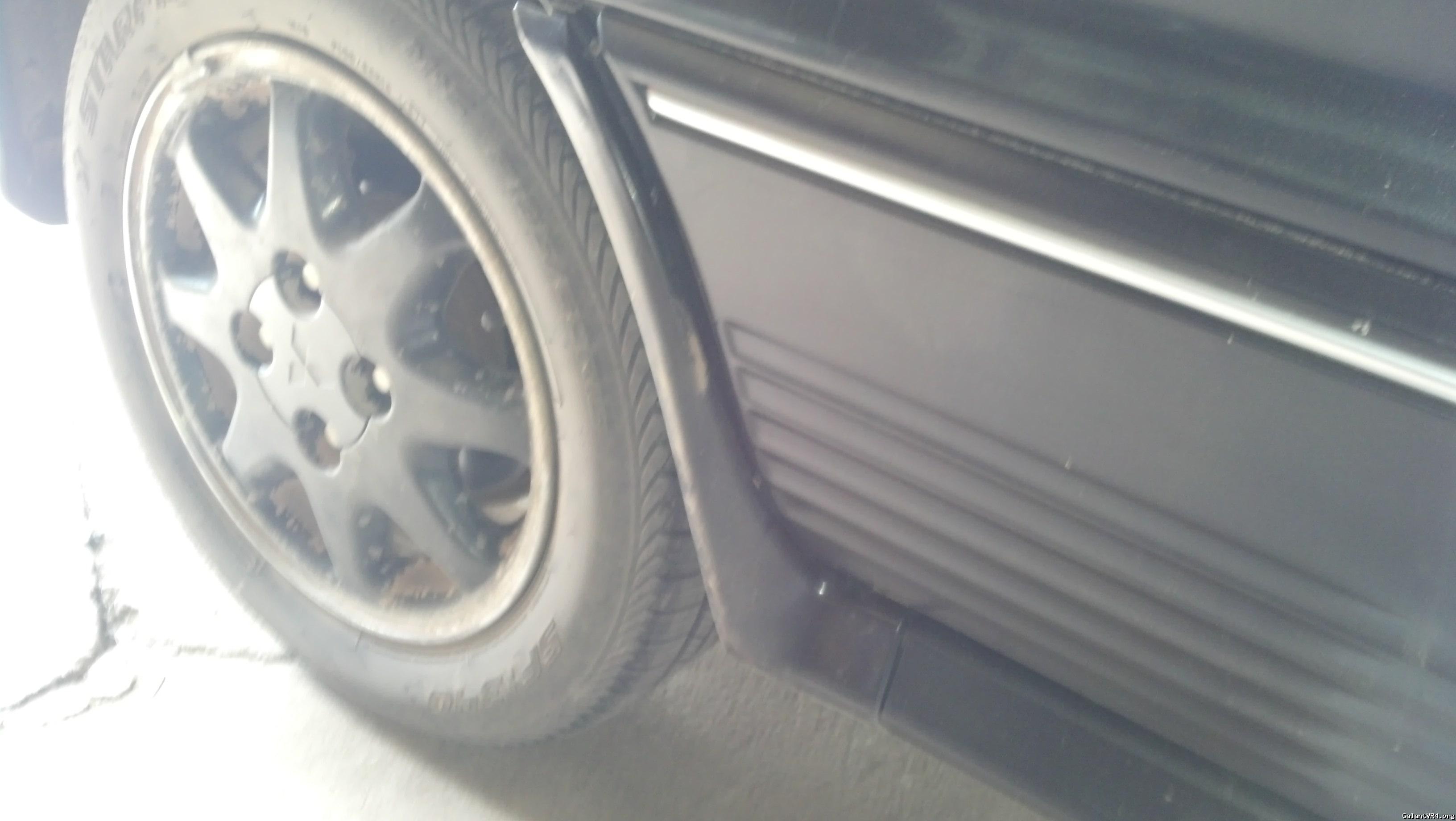

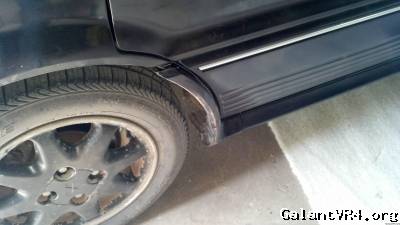

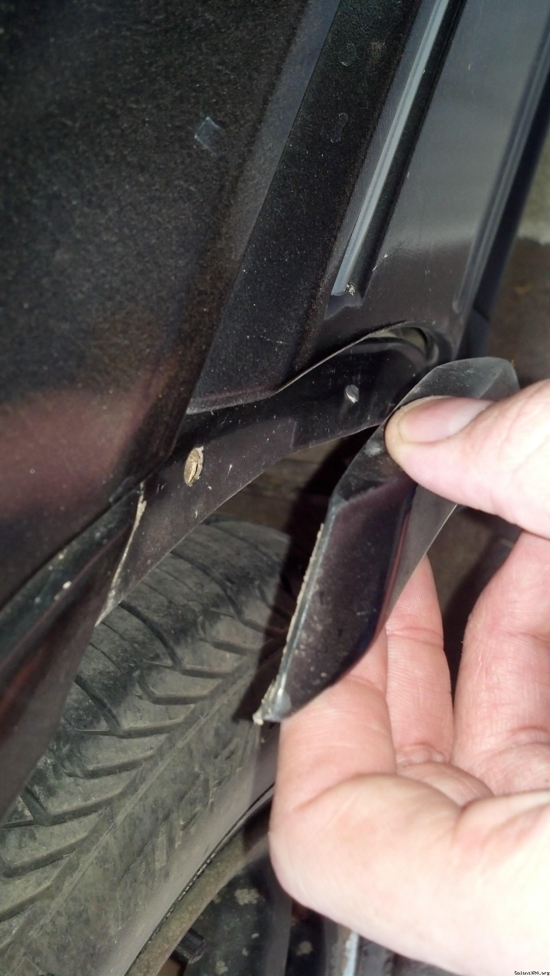

I'm looking for a new low body trim piece. I only need the rear passenger side. one the same color would be awesome.
as you can see all my clips have busted off. at least I know there's no rust back there!

Clips are replaceable. i would get them and then also glue it back on. The attachment of that part is semi-precarious even stock, and the service manual calls for adhesive to assist retention.

There are at least two, maybe three clip types on that piece. Can't recall exactly. JNZ maybe can get them.
