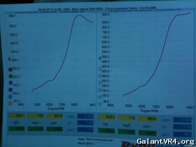

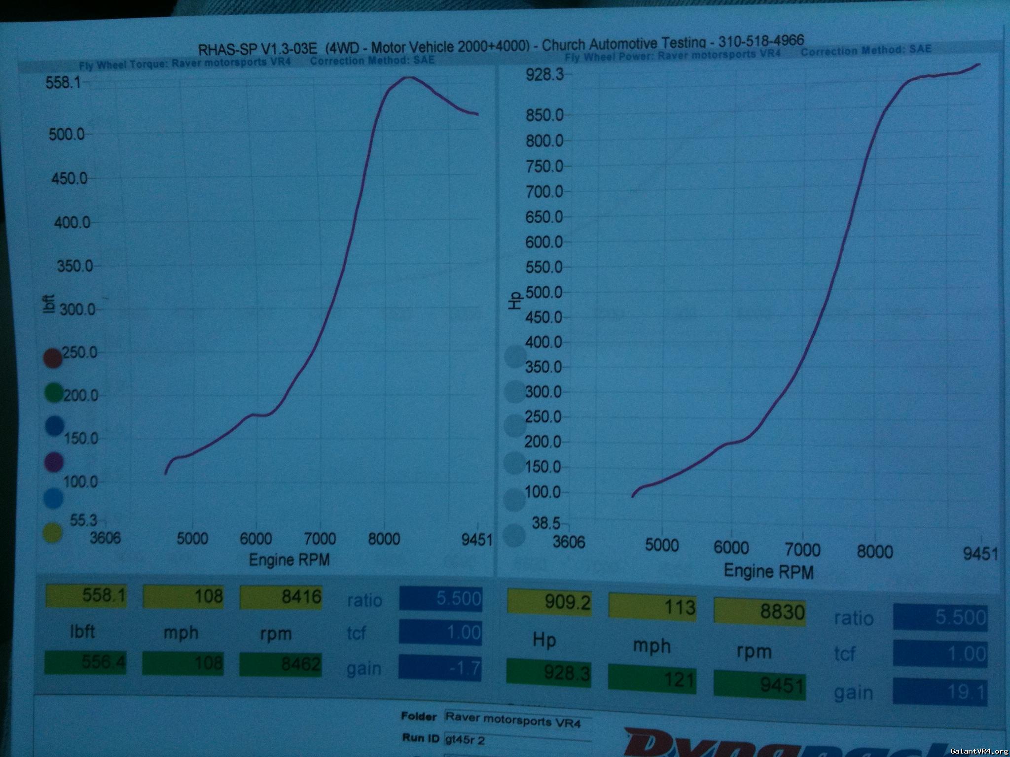

going to the world finals in a week hoping to up our record into the 230s. a moderate tune by church automotive testing (shawn is our go-to tuner) set us up at 930whp with a significant amount still in it for tweaking on the salt.
I don't know what I was expecting, but viewing that dyno graph was very interesting. Good luck with the mph, it's great to see people doing cool things with the GVR4.
We are gunning for your G/PS class record again. We hit 214mph at the four mile mark at World Of Speed. We blew a silicone coupler to smitherines though right after the four mile mark. We went 209 at the four mile at Speed Week and the car broke up all through the last mile. We switched to a different intercooler and speed density and picked up 5mph at the same boost level and a little lean on the tune.
