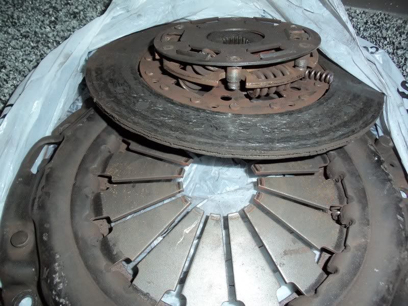

I'm glad I get to prove you wrong:

That disc looks just like a few i've pulled out of my VR4s over the years. There for a while i was destroying them pretty quickly. I tried a variety of different sprung hubs. None of them held up. Some lasted longer than others. Constantly launching, racing, and beating on it is really hard on the sprung hub units.
Because of incidents like this, i stopped running sprung hubs, and learned that i could have a transmission pulled out, and on the ground in about 30 minutes. After running solid hubs for a while, i learned that OTHER things wear out instead... like the splines in the disc.
