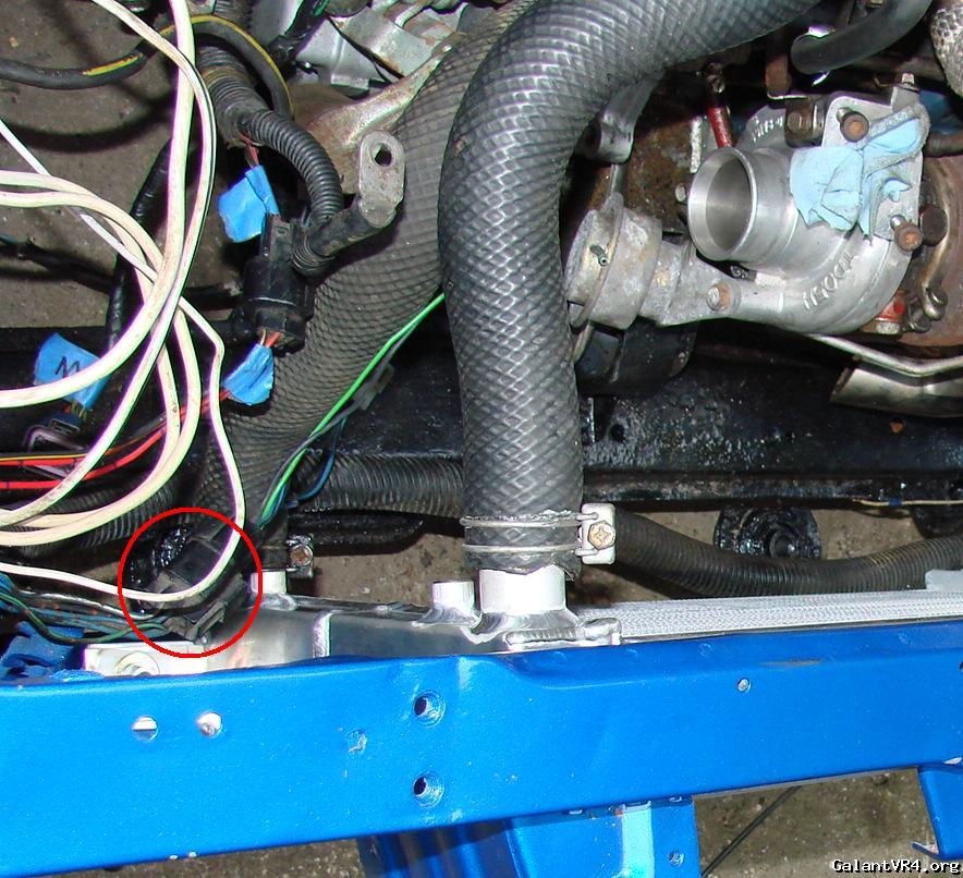

There is a 6-pin connector right around the passenger side headlight. It has 2 wires going to a resistor pack, 2 wires to the thermo sensor on the radiator, and the last two go to your radiator fan. One blue w/ black strip and other blue w/ white strip. Just went through it myself. Only pic I can find on my comp where you can see it. Hopefully that helps.
Should just be the two for the fan. The other two should remain untouched.
