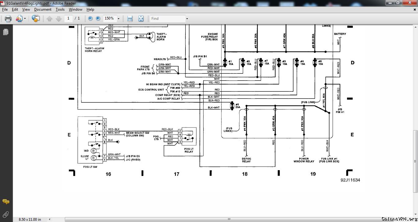

I really dont understand why my fogs dont work, it worked when i bought the car 3 years ago, and now it doesnt. I also did the mod for them to turn on with the headlights and that didnt power them on either. I want to use the OEM Switch to activate it through a relay. Who knows what each wire does? and which wires I could splice up to make this work. Thanks

First, I would unplug your fog lights, and find out how, if any condition you have voltage at the lights, if neither work, you need to work up the system, and find the common elements, such as the switch and relay, with that in mind, here is where you could start, i would start by checking that you have
continuity at (make sure your power is disconnected, and the car is turned off before checking continuity)
pin 8 from the fog light switch - to a known ground on the car (bare metal)
pin 1 on relay side connector through pin 6 of the fog light switch.
pin 2 of the relay, to pin 5 on the fog light switch.
pins 3 and 4 of the relay connector.
check for voltage coming in on pin 3 on the relay, if you have power here, then either the relay is bad, you have a broken wire, or bad ground alternatively, both your fog lights are bad...lol.
if these wires have been spliced up before, i would get some electrical contact cleaner, and pull them apart, clean them really thoroughly, then re-do your connections, either with solder, or whatever your preferred method is.

There's no power getting to the relay according to my test light and no power getting to the fog connectors. I looked at the switch again and according to the HOW TO for fogs with parking lights it says to tap the black and red/white wires together but idk why because these two wires have no power.Only the black/yellow and green/white has power.

i would imagine the how too is saying to tap those wires, because they are the signal wires. In so much as they don't have voltage, until the switch is positioned to allow voltage to them. But i havent read the how too, so ill check that here in a bit. As far as voltage you should be seeing, i would imagine 12v. Did you get power at the number 3 pin on the fog light relay? it is a white wire, but there are 3, you want the pin with 2 white wires going into the connector, it comes fro the COMP relay (or the ECS) if you look at the schematic i posted, you should see it.

i'm editing this post... i was wrong, i followed the wrong line, the next thing is a #7 15a fuse, in the fuse box, so check all of those and see if any are blown. that wire is fed directly (according to the wire diagram) from the headlight wiring. So look for blown or missing fuses.
