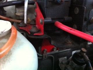

In a LHD car its on the passenger side of the firewall behind the cruise control mess. It's held on with a single bolt. I can post a pic in a few.
dammitjim
Oct 11, 2011
312
WI
Here, you can see part of it in the upper left hand corner of this pic. It's a silver colored square relay.
Ohh crap, I haven't seen anything like that on mine, I will have to take another look later. Are they diferent on different production years?
