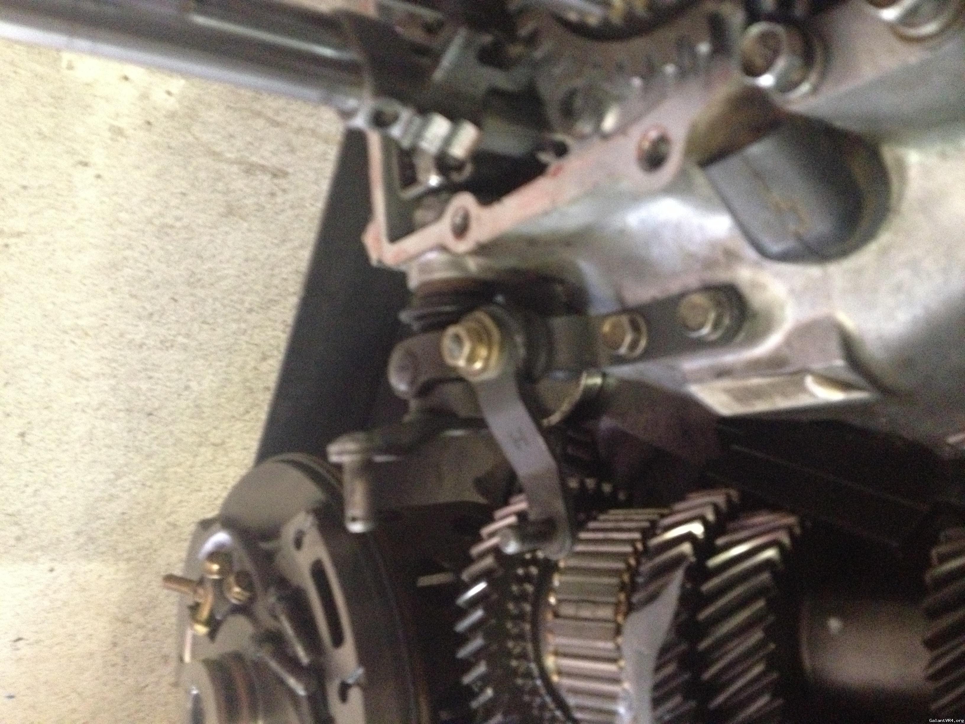

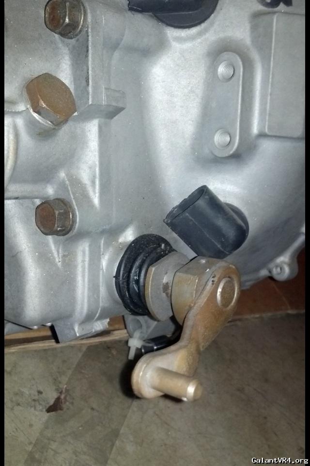

So here I am. If you have seen any of my threads you'll know i am having a nightmarish issue with my drive train. From the clutch breaking twice and the transmission breaking different parts on 2 different occasasions I am about to give up. My mechanic guy can't find the right parts to fix my tranny and confused me on what to order so I ordere the wrong parts ( thanks dynasty LCD for shipping out the part quickly and offering an exchange). So I went to pick up the tranny in the picture below on Wednesday after work a drove 120 miles one way, I almost cried (This is a stage 1 rebuilt TRE tranny BTW). I only saw the one "arm" where the shift linkage was and thought this is for a different model. I drove back home. Started doing research and this is what I believe to be true please correct me.
From what I have learned, this will fit (23 spline 1g awd). I have to take the shifter bracket where the 2 shift linkages from my old trans and put it on. The new trans correct?
If so, is that hard to do?
Picture of trans I want to buy.
Picture of my old trans

You just need to bolt the other cable arm on like you mentioned. If you have a 23 spline trans now, then this will bolt in without any problems.
Racah15
Aug 28, 2012
315
Colorado springs CO
As stated previously, unless you have a 22 spline (which is on all early 1990 production T/E/L dsm vehicles), it will bolt up. It's just missing the second arm. Just take yours and bolt it in. It's a 2 bolt process. You can even see the holes where they go in the picture. No big deal.

The trans should work just fine regardless of spline count as long as you have a matching spline tcase...? As far as the shift arm goes. There is no way its for another vehicle. You only have the arm for forward and back, no up and down. That trans would only have 3rd and 4th right now. As mentioned you just need to unbolt your old one and install it. All should be well then..

Project complete!!! Well after getting my trans in yesterday to find out it does t shift to today taking it off and putting it back on again it has been a fun 24 hours. Here's the scenario...
The transmission I got was a 90 according to the tranny code. Well aparetly the 90 awd tranny is different in the shifter cable area, bracket and shift lever. Didn know that going in. I installed the tranny slapped everything back on and ... No bueno. It would not shift and with all the issues I've had I thought the worst. Did research and got different anwers everywhere. One said you need new cables, the other said the shift bracket and another tells you to get the 90" linkage bracket that bolts to the tranny. I am here to tell you All was incorrect. The ONLY thing wrong with my setup (92 tranny in a 91 by PO) was that I did not transfer over the shift lever that controls the gears from my old tranny to the new one. The 90 shift lever arm was about a half inch shorter that the 92 arm on my tranny. That was enough to cause it to bind when trying to shift.
I had to remove my tranny to get to the little set pin that holds the arm in place.
It's now all together and running. Just want to thank everyone who hS assisted me with this issue. Thank you thank you
