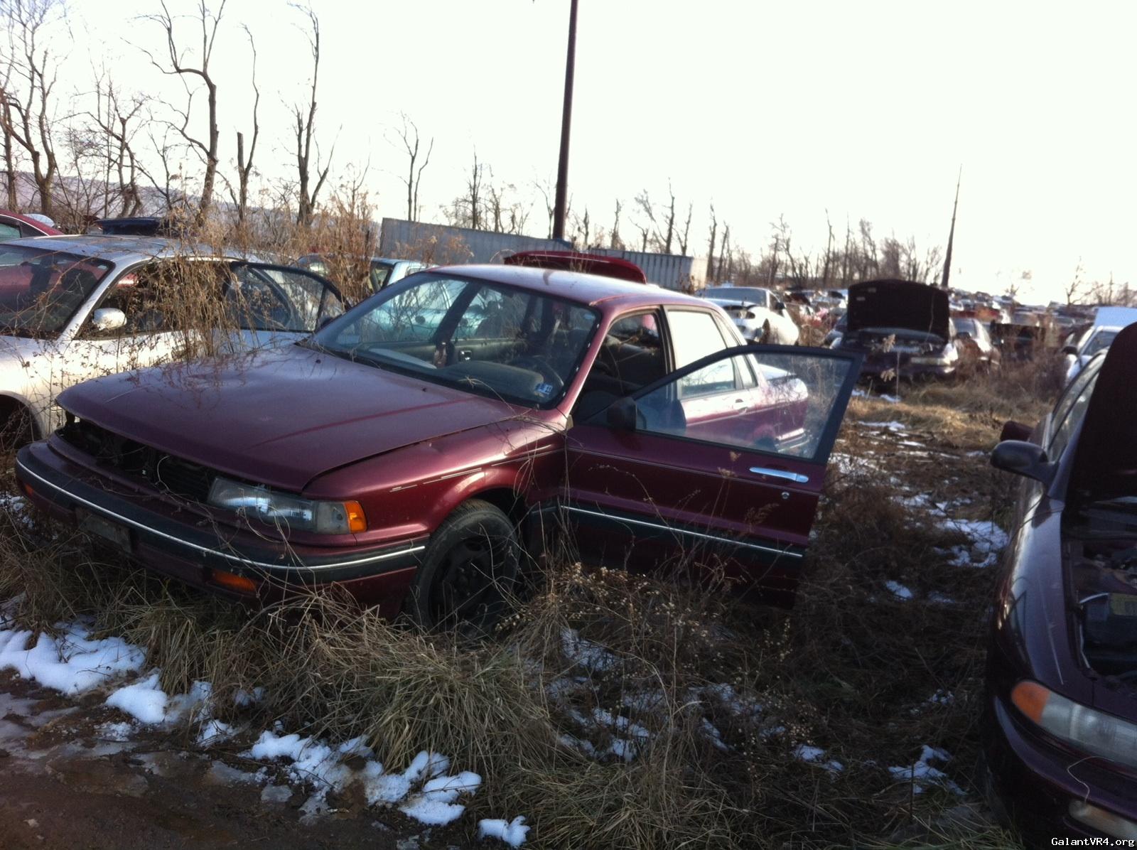

I found a clean 89 galant at the local junkyard, I have a big dent in my front passenger fender and for 30$ at the junkyard Im thinking of taking the fender off it. Problem it has this black plastic trim on it instead of those vr4 door panels, Im wondering if that can be attached to a non GVR4 fender.. the part on the lower VR4 fender

A headlight and grill are missing but besides that it's mostly complete, interior is mostly there it is all disassembled inside but all the interior pieces are just laying inside the car, and ill probably end up taking it then we actually started removing it me and my friend last weekend but there's one bolt (near blinker light at front of fender) that you would have to either remove bumper or get up underneath somehow, and we just couldn't reach it, maybe bring a dremel next time

For that fender just remove the bolt with a 10mm head that screws up into the front of the fender (from the edge of the bumper). You may have to push the fender liner out of the way to get to it. Once it's out you can push down on the bumper and get to those hidden bolts that are holding the fender on.
