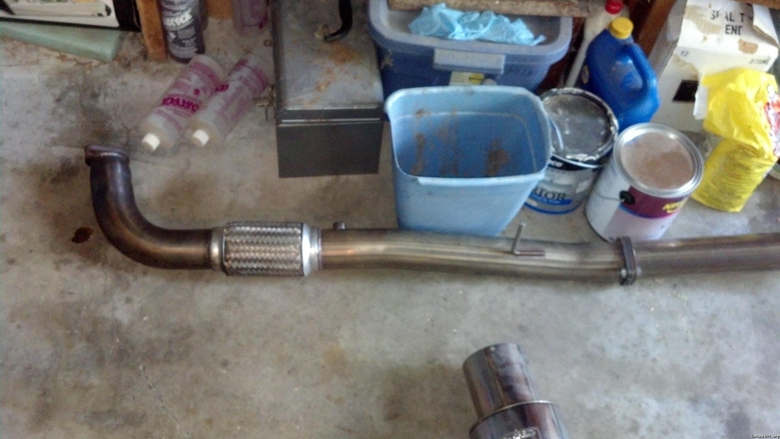

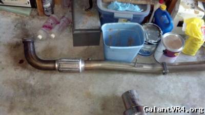

This isn't the greatest example...but it worked.

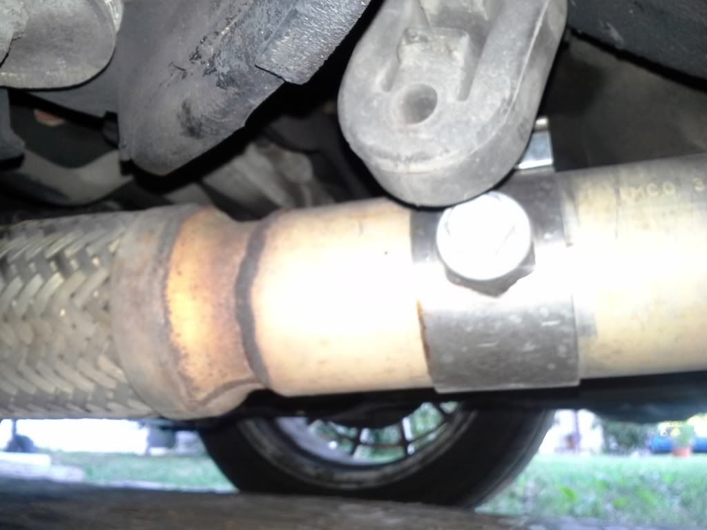

Just after the flex section pointing straight up. Looked like it would work well, I just have a cap in it right now.
