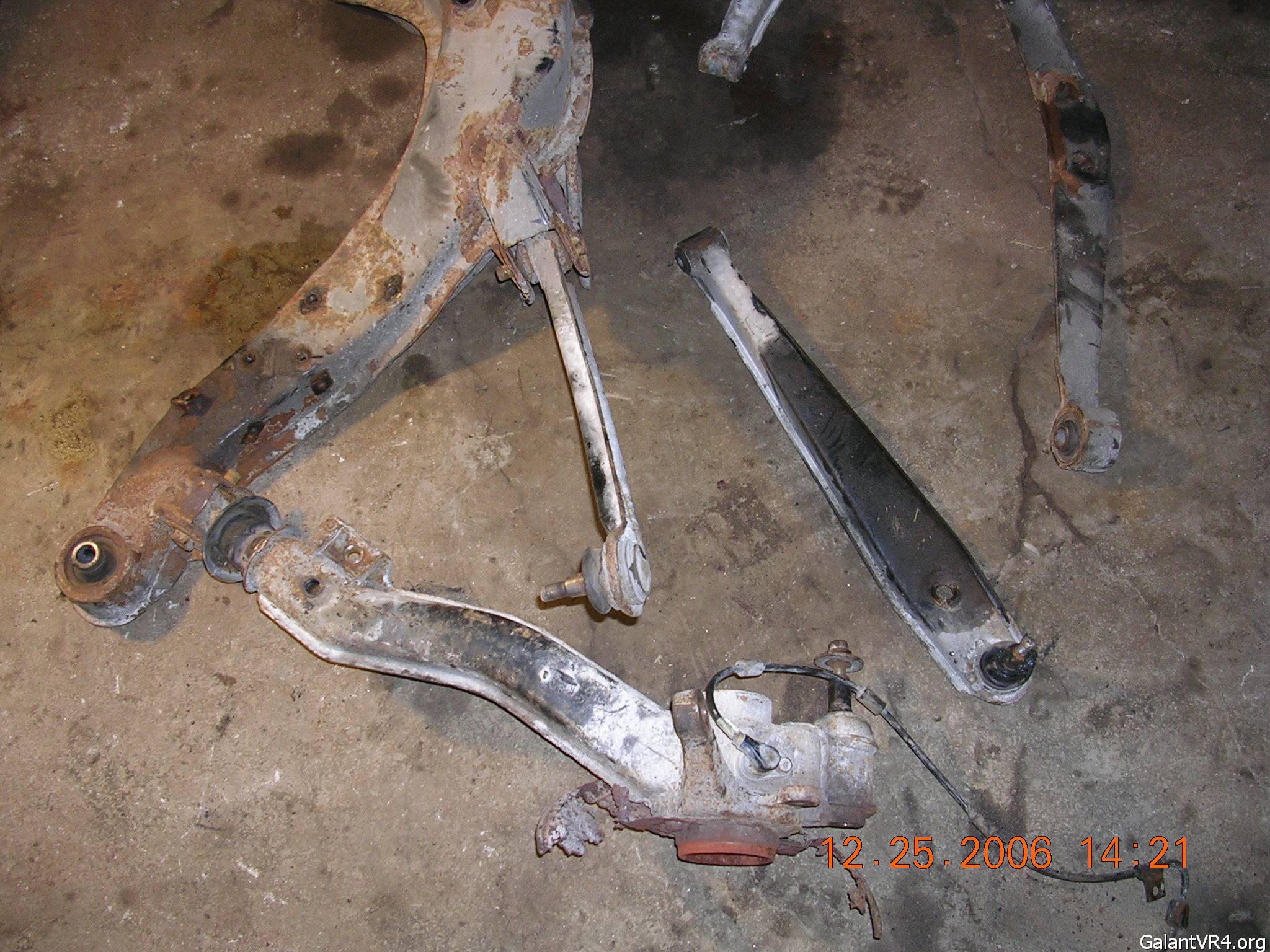

OK, I'm apparently PhotoShop retarded and can't figure out how to use the program, at all. I'm in the process of doing the entire suspension of my car with Whiteline bushings and I needed the part numbers. I figured while I was doing it, I may as well take some pictures and put part numbers on the photos, but as it says above, I'm challenged.
Can someone work their magic and put the part numbers on the pictures and then I will update the original post?
This thread is similar to this thread except this thread has pictures with part numbers.

Front SubFrame Whiteline Part Numbers
SPF 1343-XXK- Front Sway bar to Chassis Bushing
SPF 1437K- Front lower control arm (Front)
SPF 1313K- Front lower control arm (Rear)- No Caster Change
SPF 1314K- Front lower control arm (Rear)- Increases P. Side Caster
SPF 1315K- Front lower control arm (Rear)- Increases P. Side & Decreases D. Side Caster
SPF 1315AK- Whiteline Front Lower Control Arm (Rear)- Increases BOTH P. Side & D. Side Caster
KCA321- Whiteline Front Control Arm Rear Bushing (Caster Adjustable)
Rear SubFrame Whiteline Part Numbers
SPF 1344-XXK- Rear sway bar to chassis bushings
SPF 1439K- Rear trailing arm bushings
SPF 1438K- Rear lower inner control arm bushings
KCA365- Rear upper control arm bushings
SPF 2031K- Rear upper inner control arm bushings
Now for the Pictures!!!

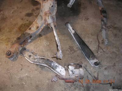

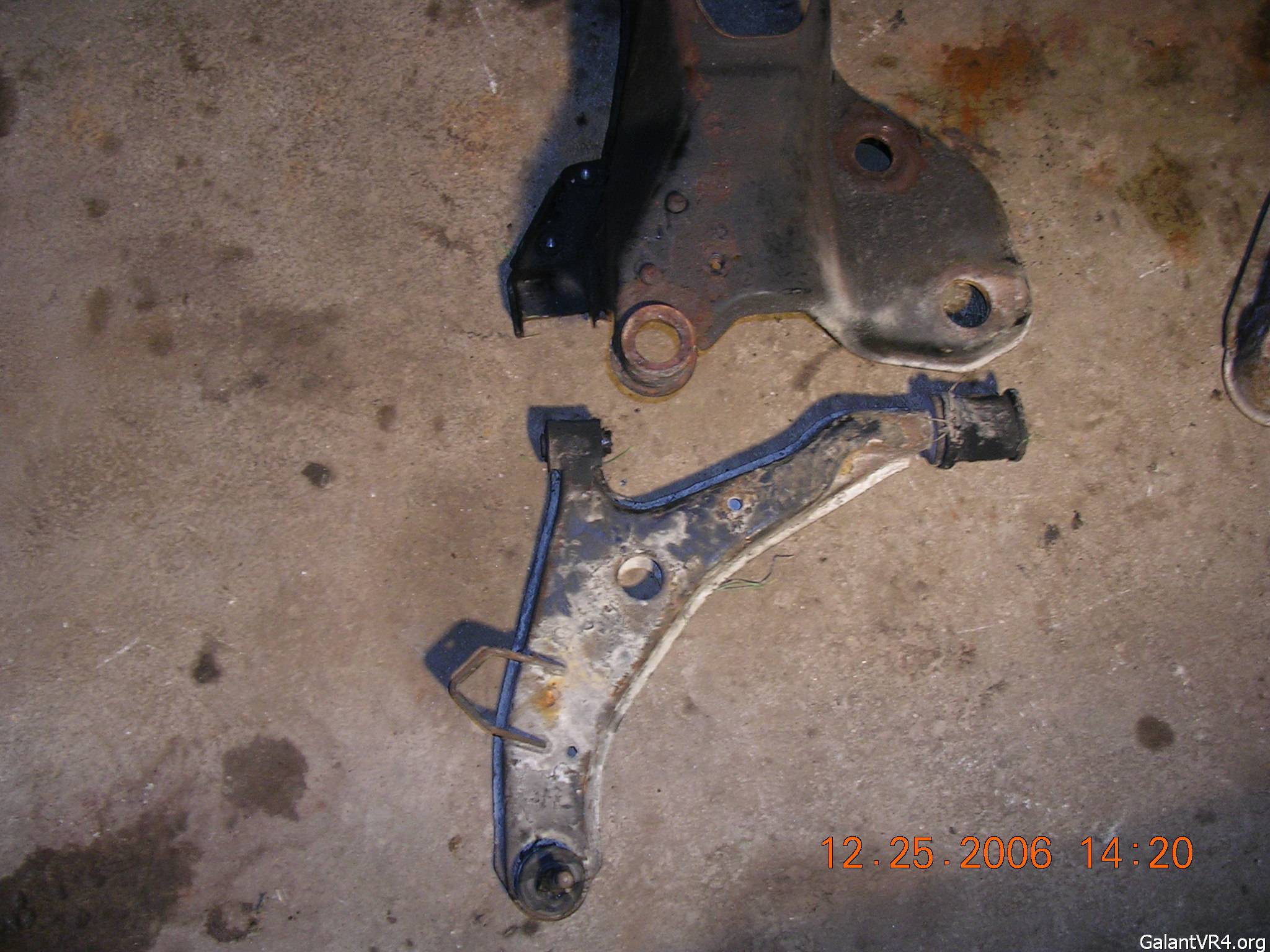

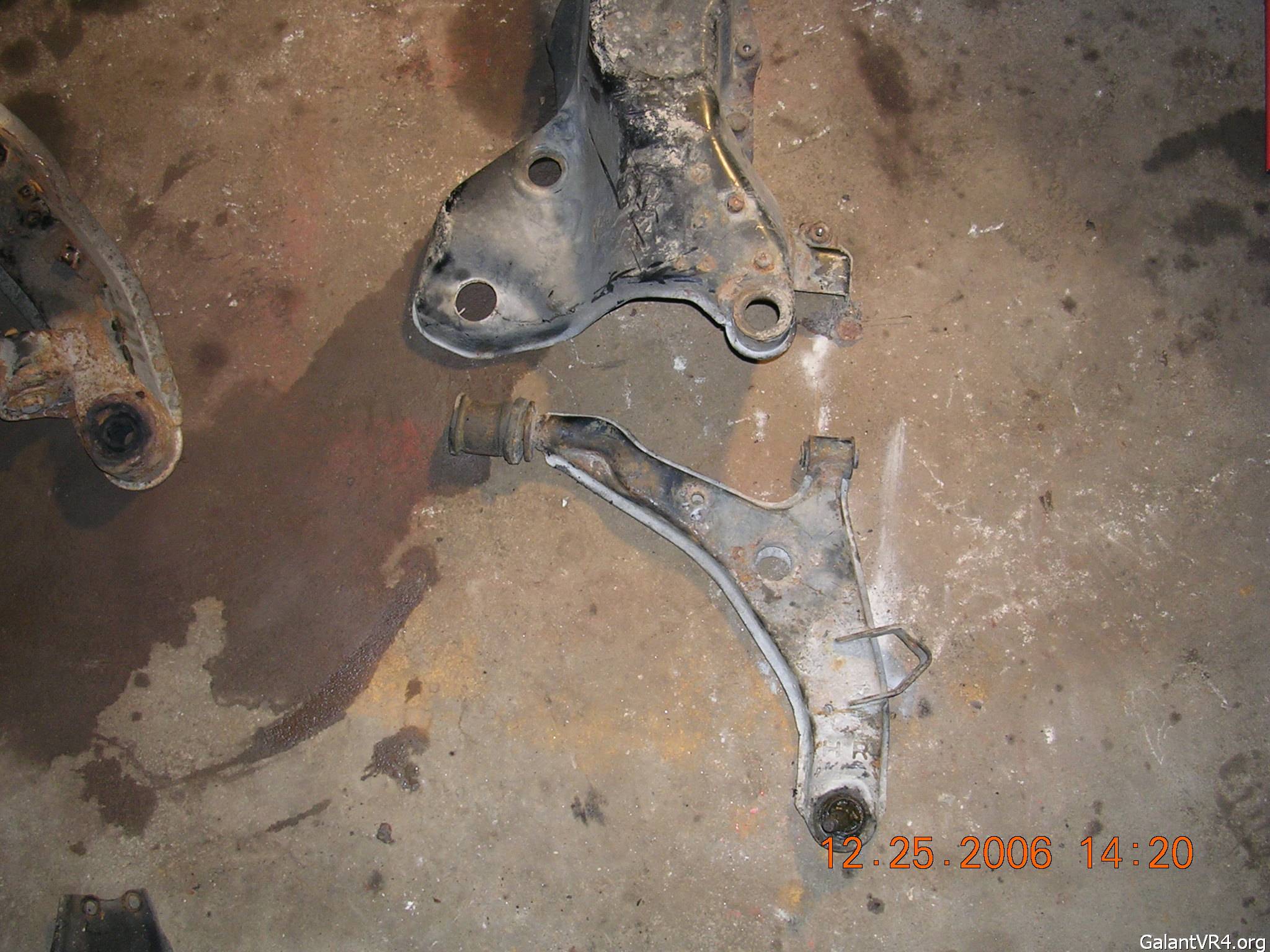

Front Driver's Side:

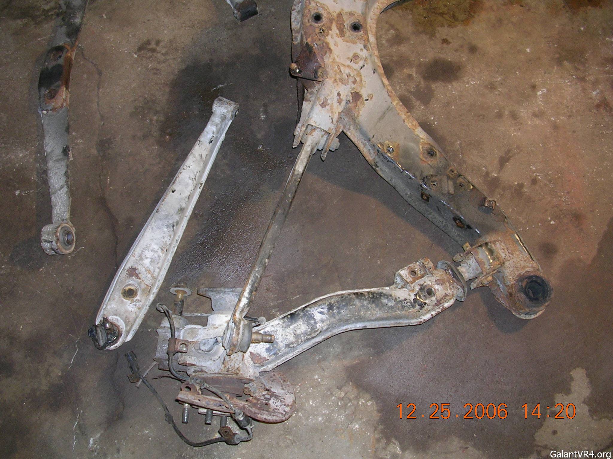

Front Passenger's Side:
Rear Driver's Side:
Rear Passenger's Side:

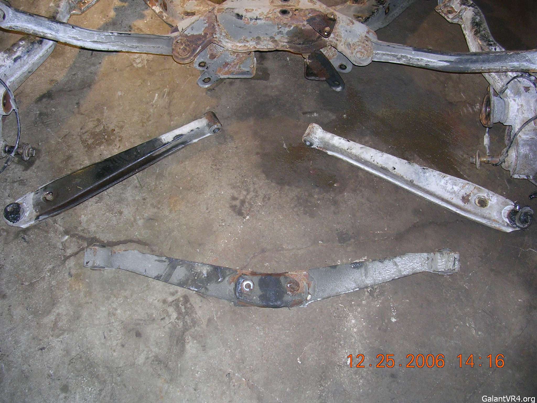

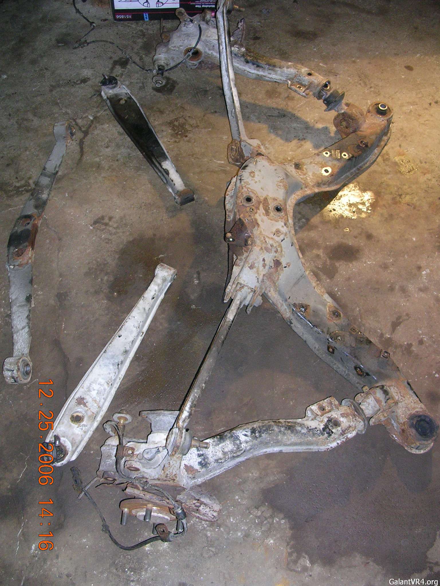

Rear Subframe:
Rear Subframe (Rear View)

That rear subframe doesn't look too bad, Mark.
