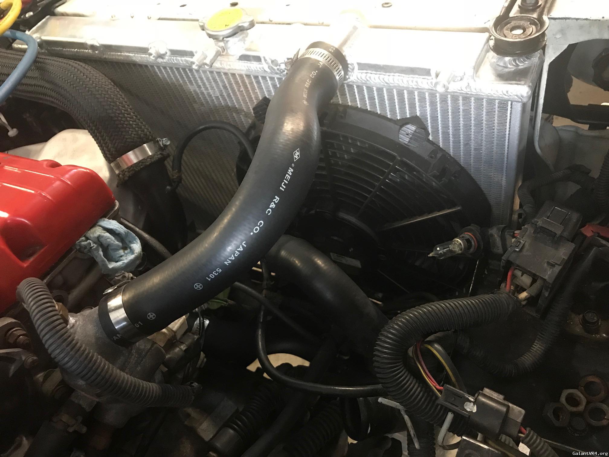

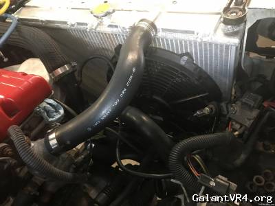

I have found out that a radiator from a EVO 3 will fit the Galant VR4 with very little mod. I had to add spacers to lift the radiator about a 1/2 a inch. I used hose that I slipped over the mount. Easy and works great!
Here is a link to the one I bought on Ebay. Pretty good quality for the Price.
Picture of mine installed with a Spal fan.
