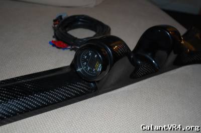

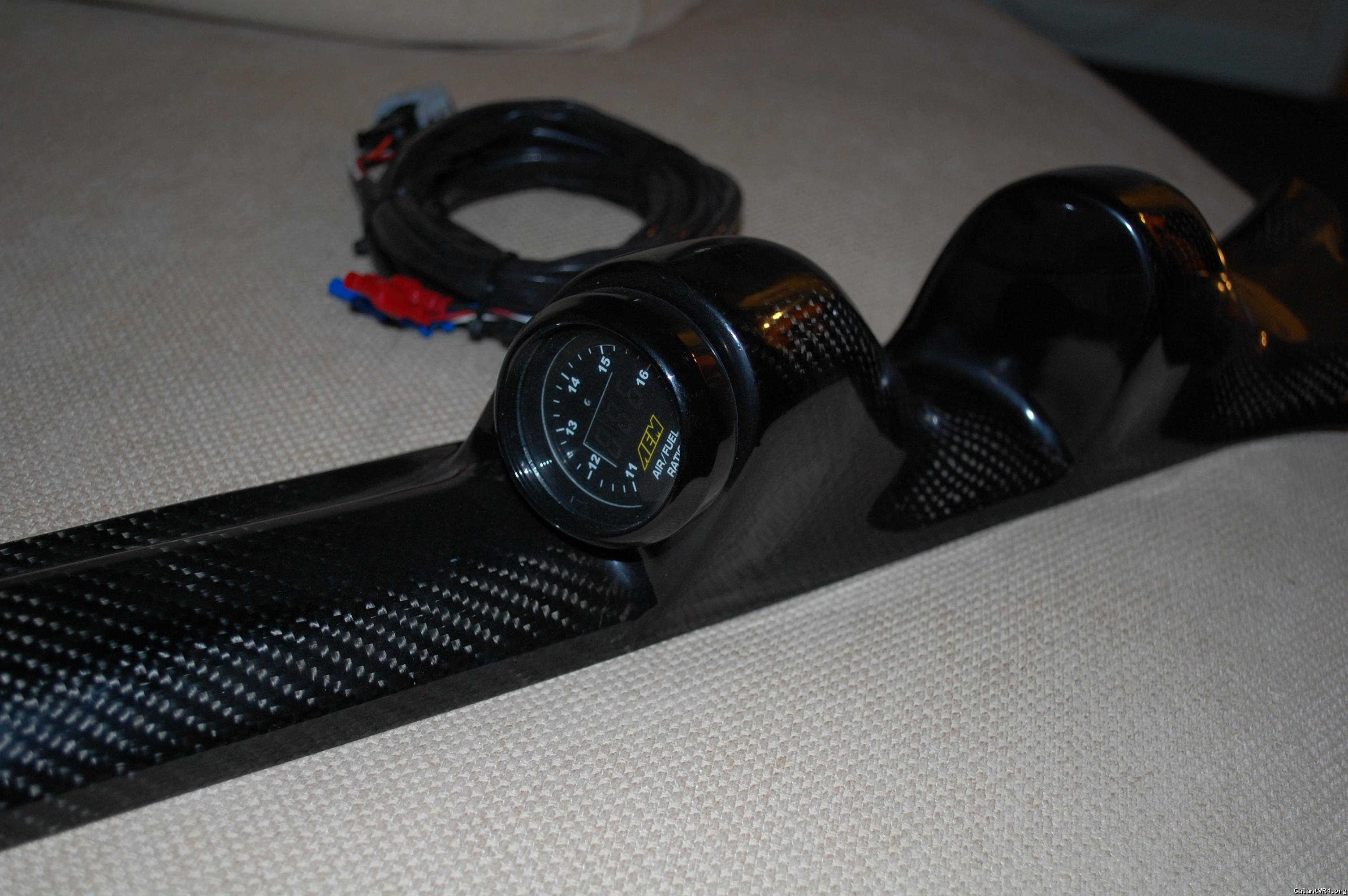

For those who prefer to keep gauges out of site in a daily, I'm going to be doing another one of these but using a stock coloured pod to match the standard interior: -
Thread is here.

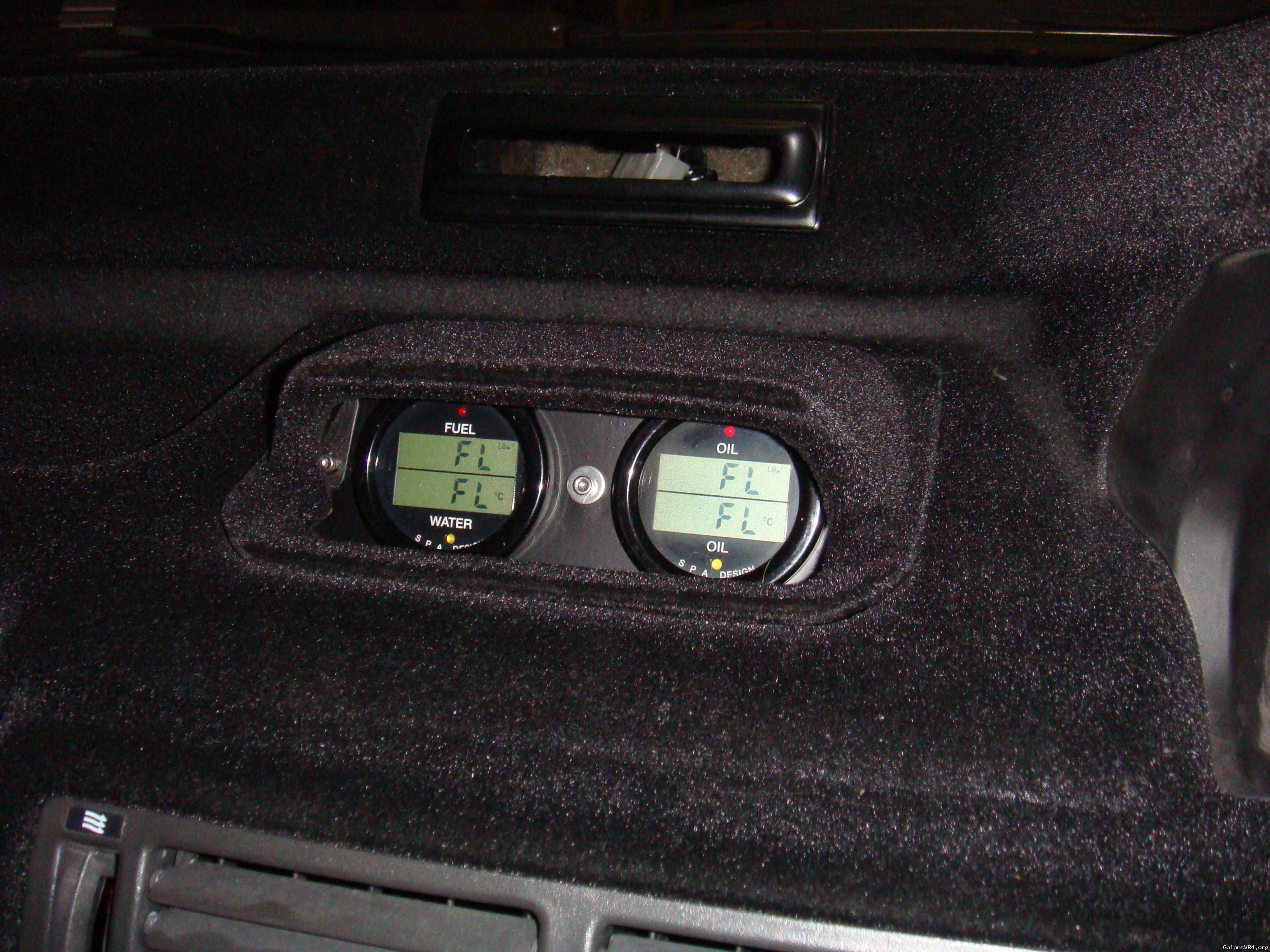

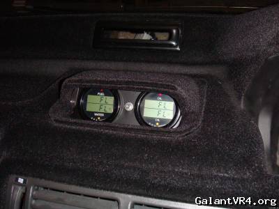

This is such a simple idea but at the same time it is simply brilliant /ubbthreads/images/graemlins/worthy.gif /ubbthreads/images/graemlins/applause.gif I am a little limited here because I have to go with the combinations that SPA produces for these gauges and obviously you can't buy an "OIL" gauge and expect it to read Oil Temp and Oil Pressure. But SPA do make this: -
So Oil Temp, Water Temp, Oil Pressure and Fuel Pressure could definitely be achieved in this way. I have seen toggle switches like this before.
I don't think it would be impossible somewhere down the road to get some custom plates cut with "oil" and "water" and "oil" and "fuel" on them which would make for a really clean install. So seriously, thanks for that idea. Options for the other gauge are limited. The only really viable combination options left for the boost gauge are these.

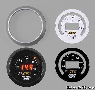

What I was surprised about was the consensus to go with an AFR gauge over an EGT one. I was under the impression the AFR was only really useful when tuning something like an AEM EMS or DSMLink etc and that once everything was set you wouldn't monitor it much. I take it the AFR is much more useful than that? I actually have one of these sitting here that is left over from the other build.
It might be a bit big for the dash pod but I'll see if I can find somewhere else a bit more discrete to mount this. I won't be using the A-pillar on this car!
