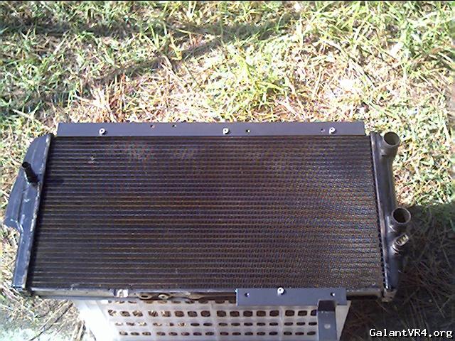

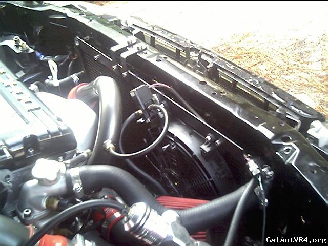

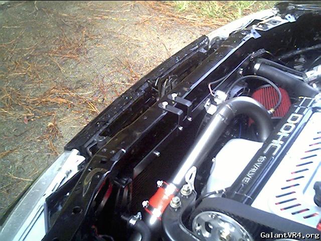

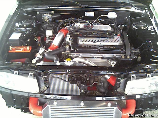

On my last Colt with a 4G63 swap I grabbed a radiator from a 90 Audi A100 at the junkyard. It fits down in the radiator support like the scirocco one but you should be able to mount it behind the AC condensor as well in the stock location. There is also one pic showing how I had the IC piping ran when I had the civic radiator but I was able to run it the same way with the Audi one however I don't have its exact measurements.
Edit: Autozone's site actually lists the measurements for both.
Audi A100- 24 1/8" x 12 1/8" x 1 1/4"
Galant VR-4- 26 1/4" x 14 3/4" x 1 1/4"
