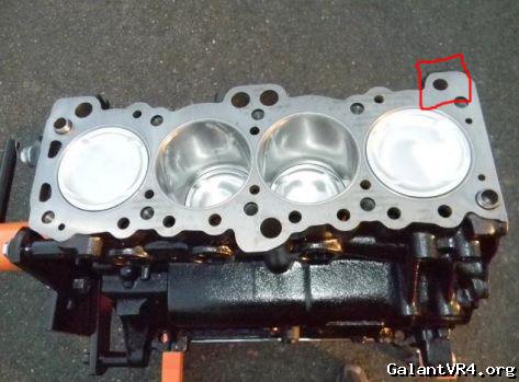

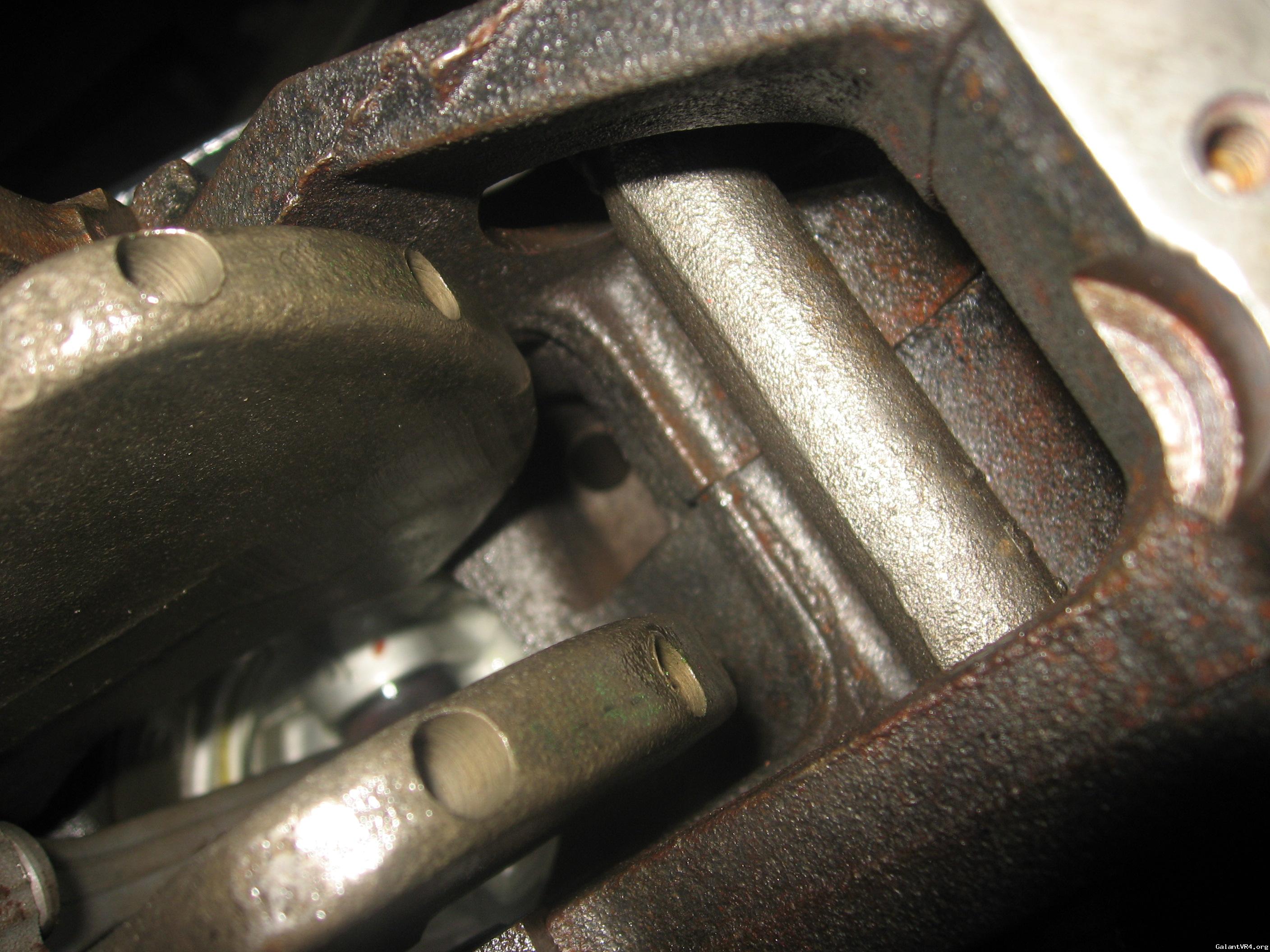

so i pulled the valve cover to retighten the head studs on 1078 and one of the bolts fell out of the cover while i was moving it, it fell in the head, i grabbed a magnet and went to pull it out and i pushed it down further. it fell through this hole.. i dont know where it goes or how much of the car i need to pull apart. i think it might just dump into the oil pan, but im not sure. ugh i feel so so freaking stupid.

Doubtful, The 6mm x 1.00 x 27mm long bolt is way too long to pass through the pick up screen.
Its hanging out in the bottom of the oil pan, under a few inches of oil.
I doubt any harm will come to the engine. I just can not see it jumping out of the oil and up into the crank/rod/pistons.
If you are that worried about it, you may be able to fish it out of the oil drain hole in the pan, if not you have to pull the oil pan.

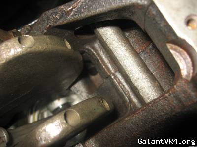

The underside of the oil return hole.

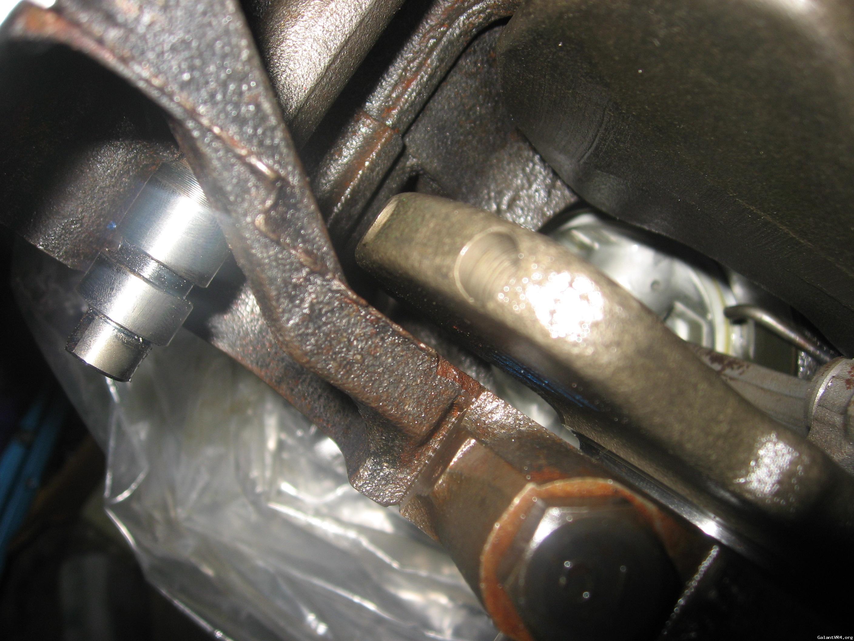

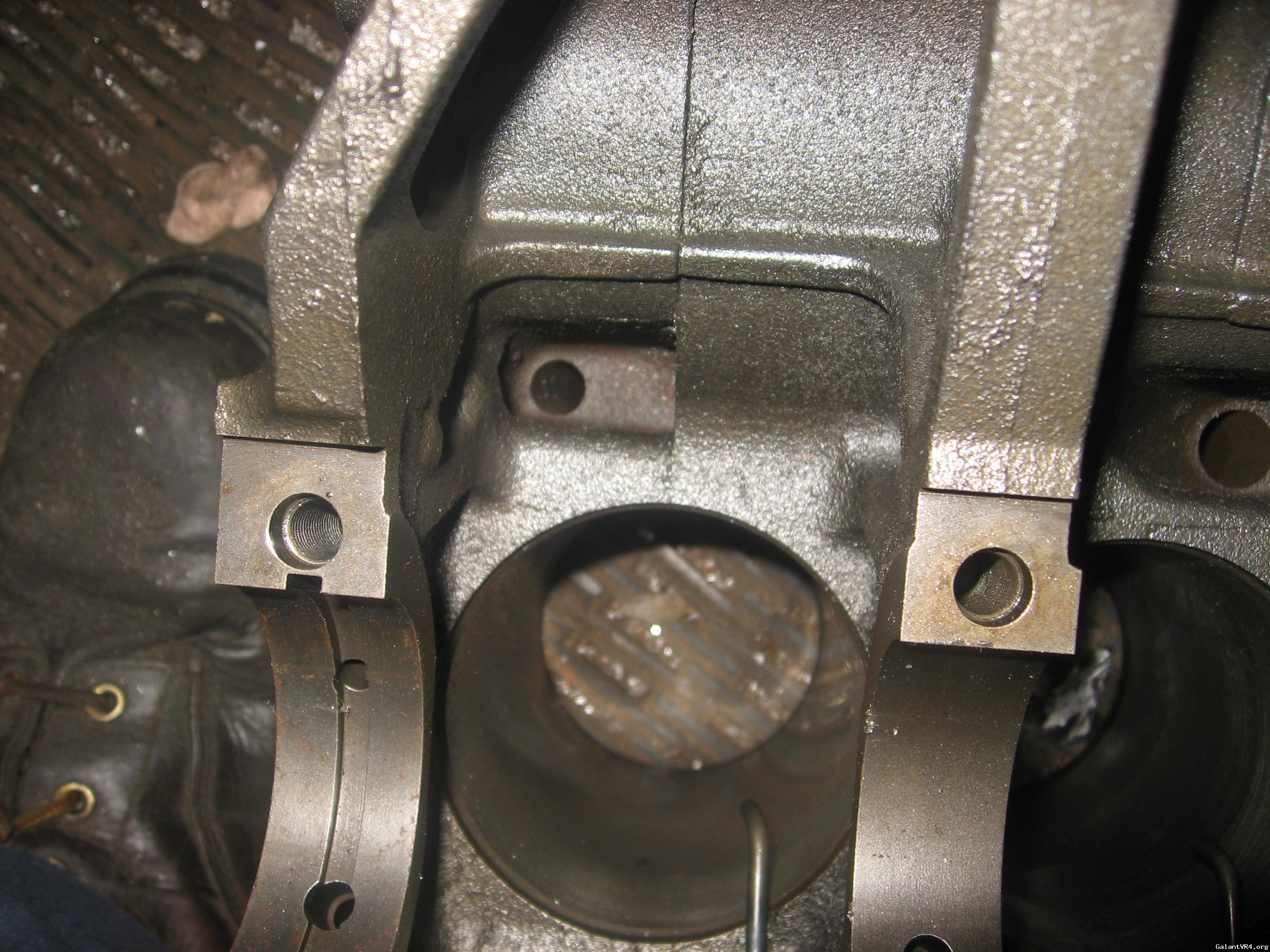

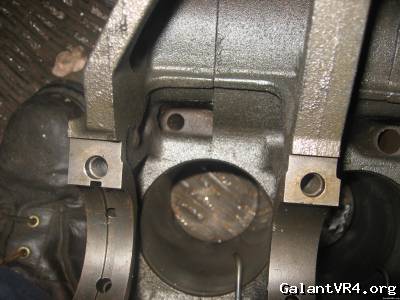

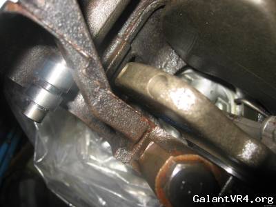

Same return hole, with the crank rotated to the closest point, with the rear BS installed.
Now about the only place it may get caught, is between the block and the first counter weight. But since that is on the downward side. It would still drop into the oil pan on start up.
Now is it possible that it gets wedged somewhere else, yes. But is it probable? No, I would say it has about the same odds to give an issue to the drivablity to the engine, as I have to get hit by a meteor.

no shop, carport. just snowed yesterday, i pushed it in and drained the oil. i fished around and didn't grab anything, but i was using a coat hanger. i turned the crank by hand with a 1/2" ratchet like 3 revolutions and i heard nothing and nothing got caught or pinched while i was spinning it. i think i might leave it all together and just put some oil in it and hope for the best. if i was building the motor and it was on a stand i wouldn't have even asked, just removed the pan. spending money isn't the issue and doing the work really isn't the issue, as ill work in the cold, i just don't want to ruin the motor with this little bolt, but i also don't want to pull it apart if i don't HAVE to.

Before you dump oil in.
Try Prove it's magnet deal, an old speaker magnet ought to do the job.
Also shine a light down the oil return hole.
The bolt may not have made it to the oil pan sump yet, but be up on the anti-slosh baffle that's built in the oil pan
