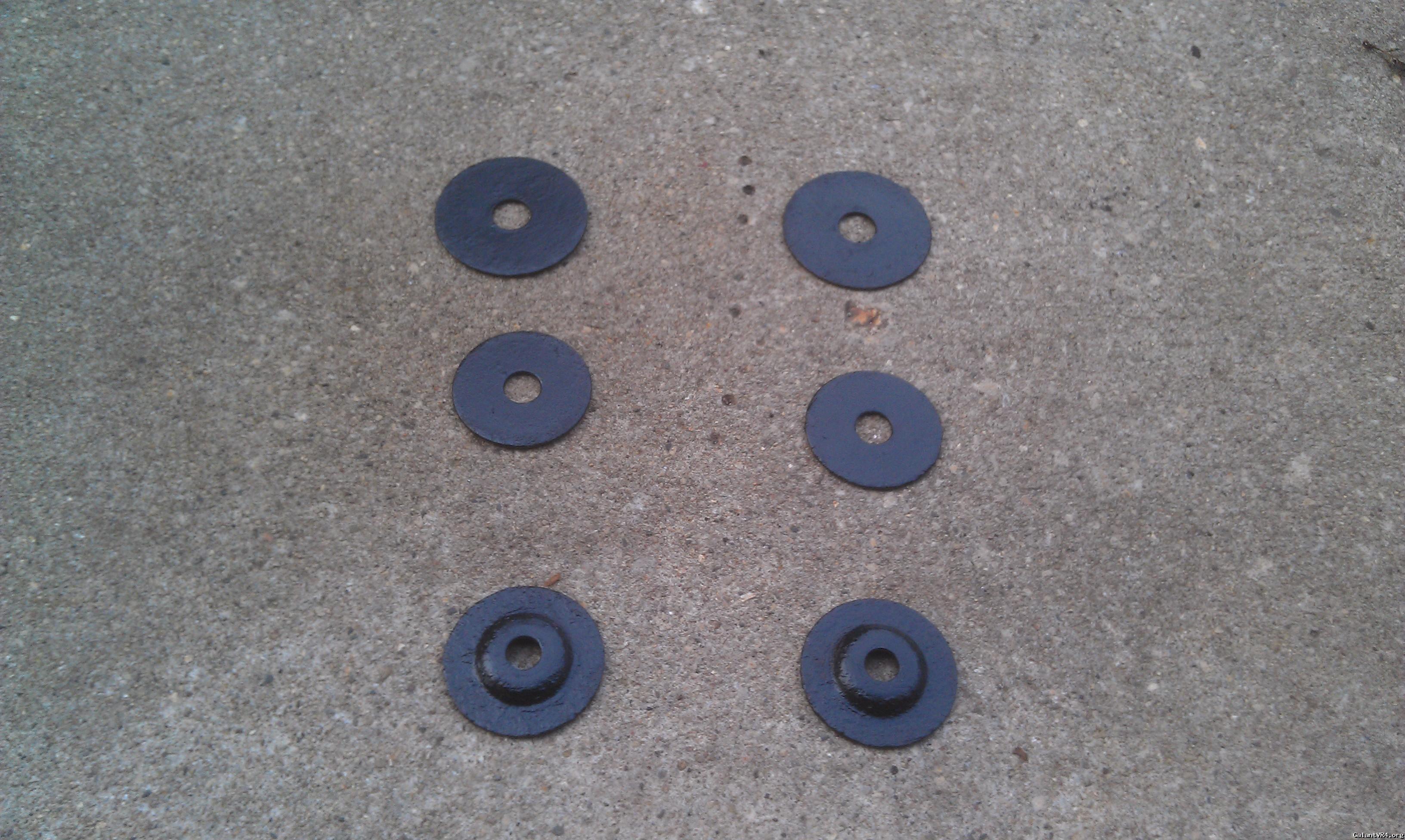

I've watched the boostx install and it tells me that the dimpled washers go in the mustache bar, but I don't see how that's right. The mustache bushings aren't recessed for them. Here's a pic:
Where do the other two sets go? It looks like I should have a third set? One bushing will be left to contact the underbody alone?
