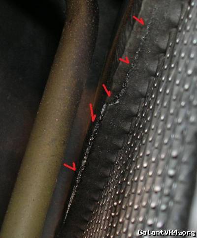

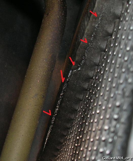

+1 Start there. It will be a big leak, very noticeable. Is there any change in how the car sounds while driving like that?
A stock set-up will probably have some leaks around the throttle body seals and injector seals, but that is usally only a pound or two loss. Also, I once had the clip that holds the waste gate arm to the actuator rust out a break. The actuator arm fell off and it ran exactly as you just described. You can check that real quick too.

That sounds like it might be it.
I did pull the front bumper off (it's warped badly), and in the process yanked the intercooler piping. Time to recheck those clamps.
